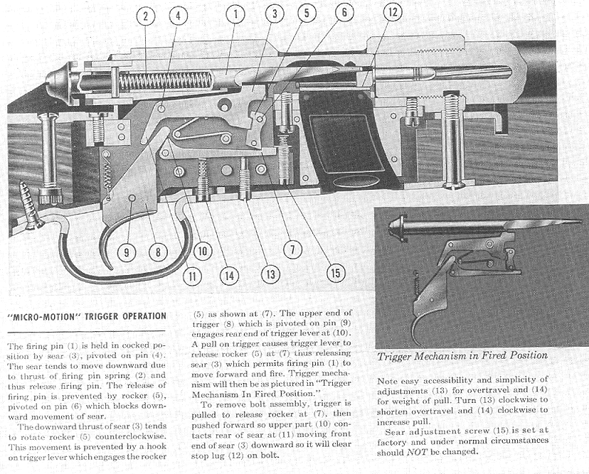

    The 52C has an improved trigger mechanism. Apart from the "C" serial suffix, the most obvious difference is the two adjustment screws visible immediately ahead of the triggerguard bow (13, 14 in picture).

    The triggers are very different as mentioned. The "B" trigger is adjusted thru a hole in the tang behind the bolt (WOP).
    The "C" trigger has adjustments on the bottom of the guard, (WOP & OT).
