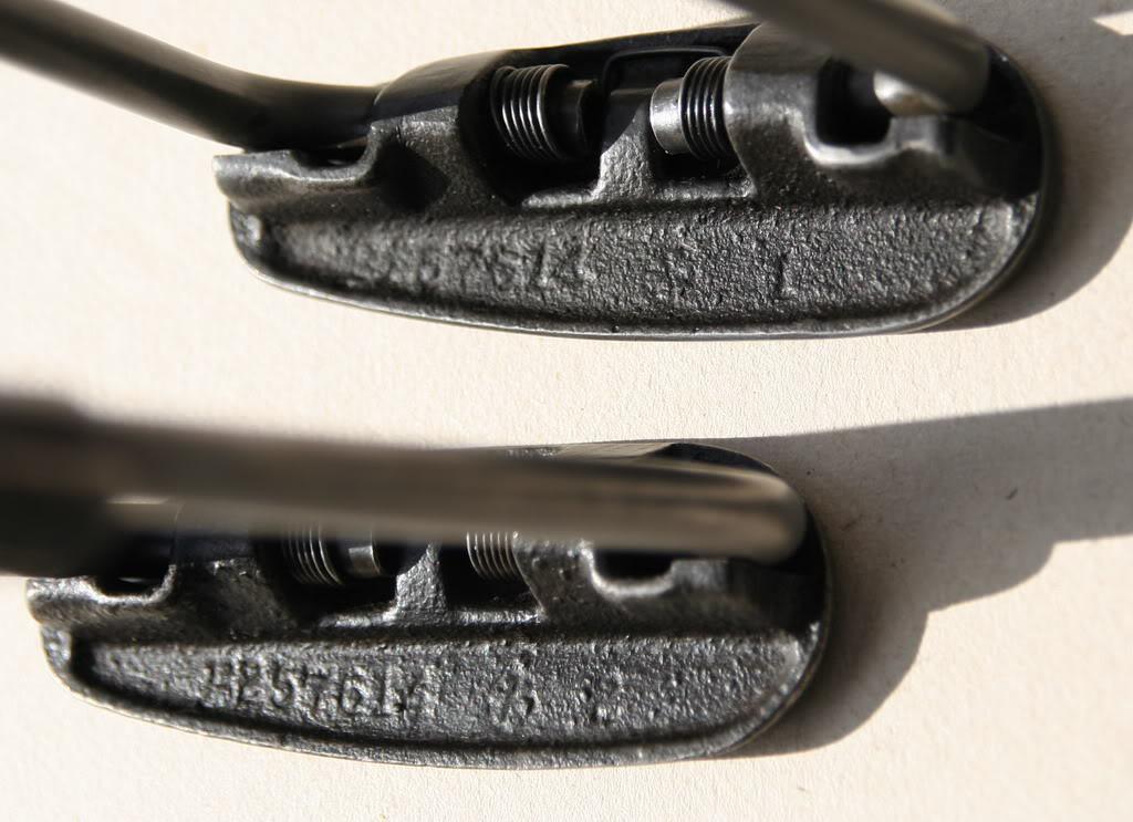

    Inside the buttplate should look like this. The number on the right can be any of 1 through 12. That was the position of the casting for that plate.

    I'm back from checking the carbine out. It's amasizing how something can look from the out side and totaly different from the inside. Having an m1a1 folding stock first gets you excided thinking you've just found something special. Then you start looking futher and find what's really there. Like I had said the reciever and barrel were Saginaw (so-so condition) stock wood, metal and leather was in nice condition. When I started braking it down is when things changed. Slide was a winchester type VI, bolt-inland (round), compleat triger housing (which the other day looked wierd) was from some comerical carbine. No stamps on the wood except arsenal stamp AAR, inside channel was a disaster, someone had carved out (with what looks like a pocket knife) an m2 cut and a grove on the right side for the disconnect lever. Metal and leather looked great, brass rivets, welded not brazed, butt plate looked like pic's from JimF4M1sicon post. I'm wondering if the metal might be original?? Anyway this has been a really good hands on education on M1A1icon's, even tho this one was a disaster. Appreciate the info. and help from you guys, Thank You, Gene PS the shop owner said he gave $185 for it
