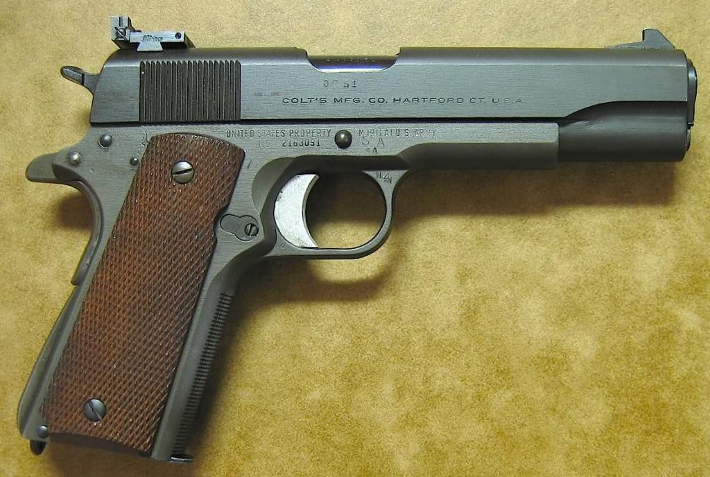

    Your pictures are not good enough to tell much about it, but the slide is a GI slide. In the early 1950's Ordnance bought replacement slides from Colt. The slides were marked just like their commercial (Government Model) slides, but had a rough military finish and were phosphated. The Micro sight was used through 1962, and the 1962 NM pistols did not have the serial number on the slide.
    This is a 1961 NM pistol with the serial numbered slide.

    Beginning in 1963 the Springfield Armory, and later Rock Island Arsenal, NM pistols used slides with angled slide serrations. The first NM slides furnished to Springfield Armory were manufactured by Colt, and were the same slides used on their Gold Cup National Match pistols. Drake also furnished NM slides with the angled serrations.
