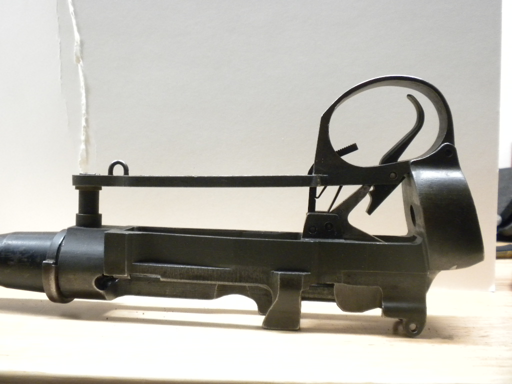

    Good Afternoon.
    I am in the process of refitting the fore-end to my No. 4 Mk 1* and have run into a few issues. Brian fitted a new barrel and bolt head for me (for a small fee Thanks Brian!).
    So a few notes. I have read Peter's article on fitting fore-ends a few times already (probably need to read it 10 more times).
    1) With the barreled body inverted on the bench and the fore-end placed on it if you just put a little pressure down at the magazine well the fore-end does not move fore/aft. Draws OK?
    2) The front trigger guard screw takes just over 6 3/4 turns to contact with and without the collar fitted.
    3) With the front trigger guard screw tightened the aft part of the trigger guard does not line up with the hole in the body (see first picture). It's up about 1/8".
    4) With the front trigger guard screw tightened and the rifle laid across my legs fore-end down on my 4 fingres I cannot press down on the barrel with my thumb. It just barely touches the fore-end at the muzzle. If I force the trigger guard down at the rear so the holes line up the muzzle comes up off the fore-end by about 1/32"-1/16". This is no bueno.
    5) The trigger guard appears to be flat when I lay a straight edge along both sides of the magazine opening.

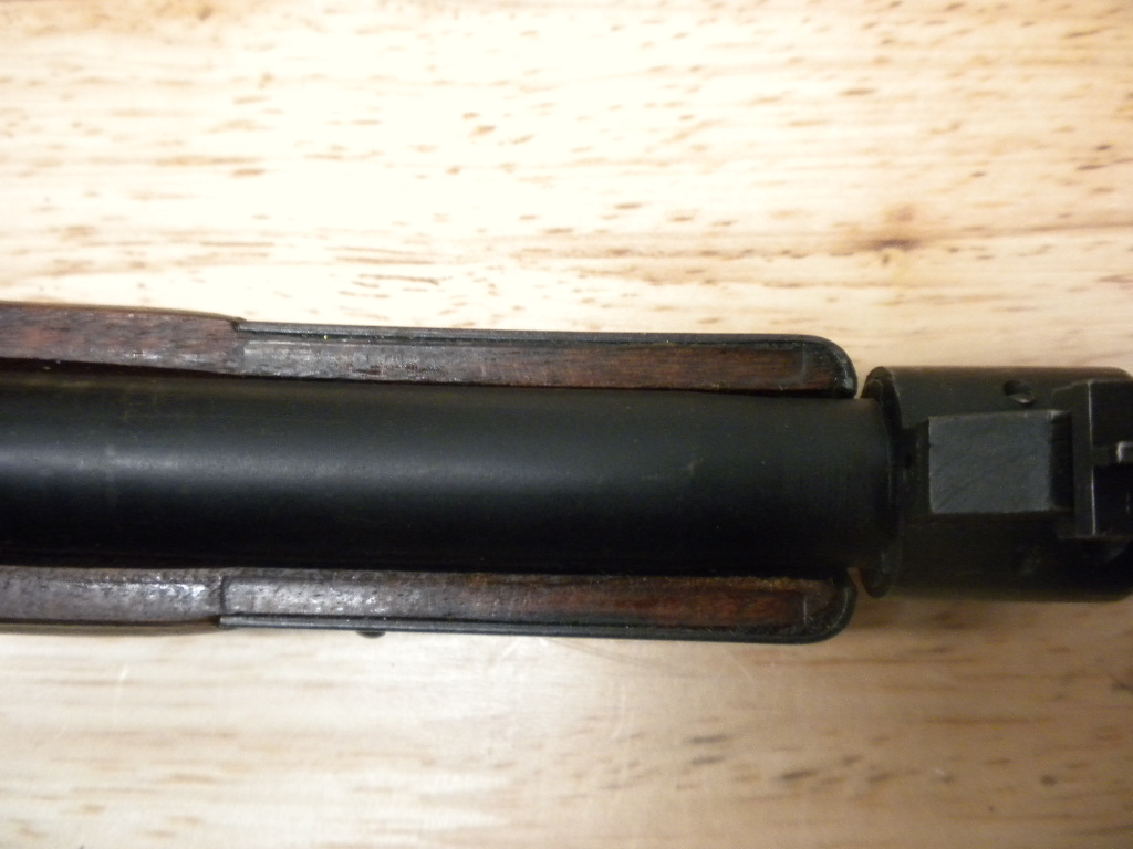

    6) The barrel is just off center of the channel in the fore-end. I can wiggle the back of the body very slightly left and right to get it centered. Draws NOT ok? Opening in fore-end too large and needs a bit of shimming? Picture 2.

    Some more investigating.
    I removed the fore-end and just attached the trigger guard with the collar and screw and the rear hole perfectly aligned with the hole in the body. So I'm figuring that the trigger guard is at least flat enough.

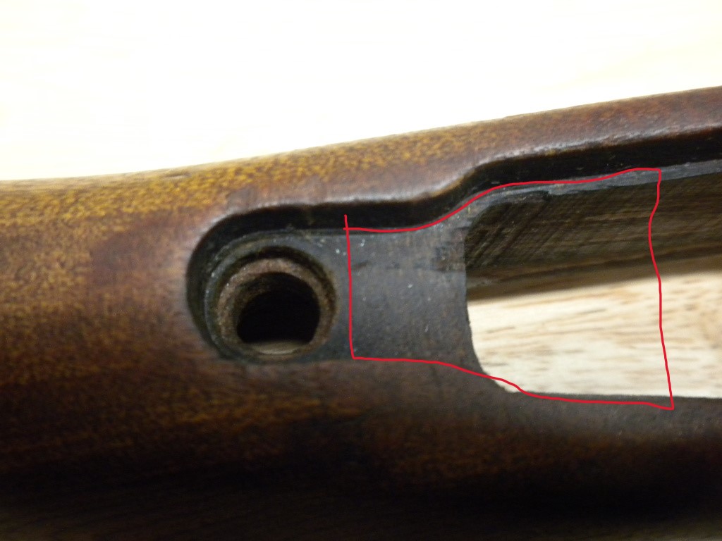

    When I set the guard into the recess in the fore-end it fits pretty well except there seems to be a high spot just behind the front trigger guard screw. The guard pivots slightly at the highlited area in the second picture. It's hard to see in the photo but the wood has a smooth and shiny appearance where there is contact at the pivot point. When it's just placed in the recess without the front screw tightened it lines up correctly at the rear.
    Another question. I'm considering 2 options at this point. The first is to use a few thousandths of shims between the collar and the trigger guard to prevent the rocking and get the correct alignment with the rear screw in the trigger guard. This would also prevent the lifting of the muzzle at the front of the fore-end. The other is to carefully scrape the high spot of the fore-end until it no longer rocks and aligns properly. I shouldn't have to adjust the length of the collar as it's not contacting the trigger guard boss until it's tightened a bit and begins to pivot.
    What do you think?

    After further examination I have determined (rigthly or wrongly) that the recess for the trigger guard is actually flat from behind the hole for the boss all the way back. The problem lies where the front of the trigger guard rests at the very front. There is a very narrow ledge that is crushed down allowing the rear of the guard to rise up as the front screw is tightened. Picture 1. This with the fact that the collar appears to be too short by about 1/16". Picture 2.
    So I know I'm going to get some pushback on this but instead of scraping the trigger guard recess I have decided to epoxy bed the forward portion. I could remove some of the wood and replace it and re machine it to fit but using a small amount of epoxy will give me a perfect fit withought a lot of fuss. Also it will keep the correct alignment I already have with the rear trigger guard screw. This will give the guard a place to rest the forward tip and help prevent it from tipping down. I'll also have to shim the collar to get the correct length. I know if I just shim the collar it will effectively keep the front of the guard from tipping down but I think it needs to be more secure to help prevent movement.
