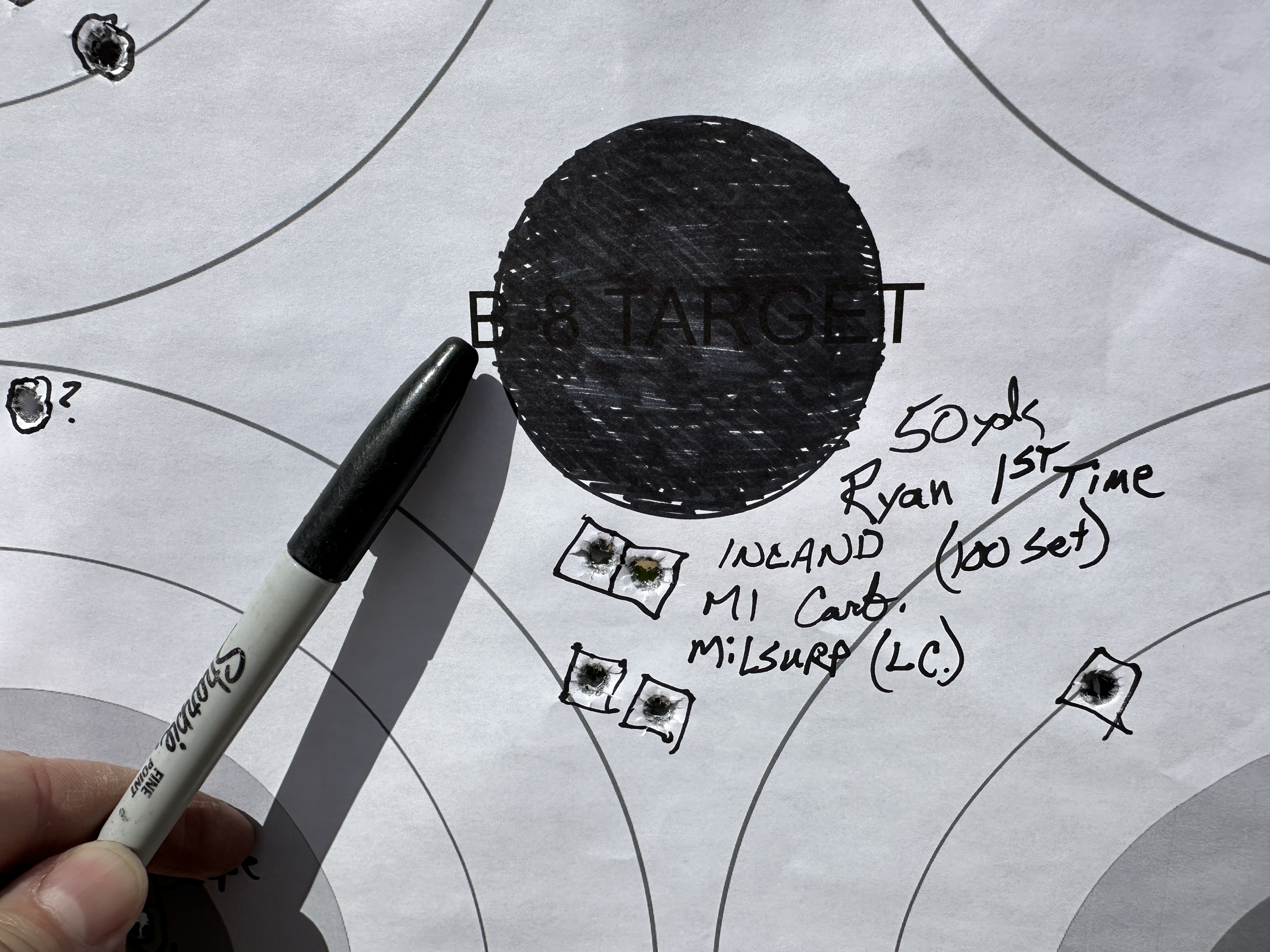

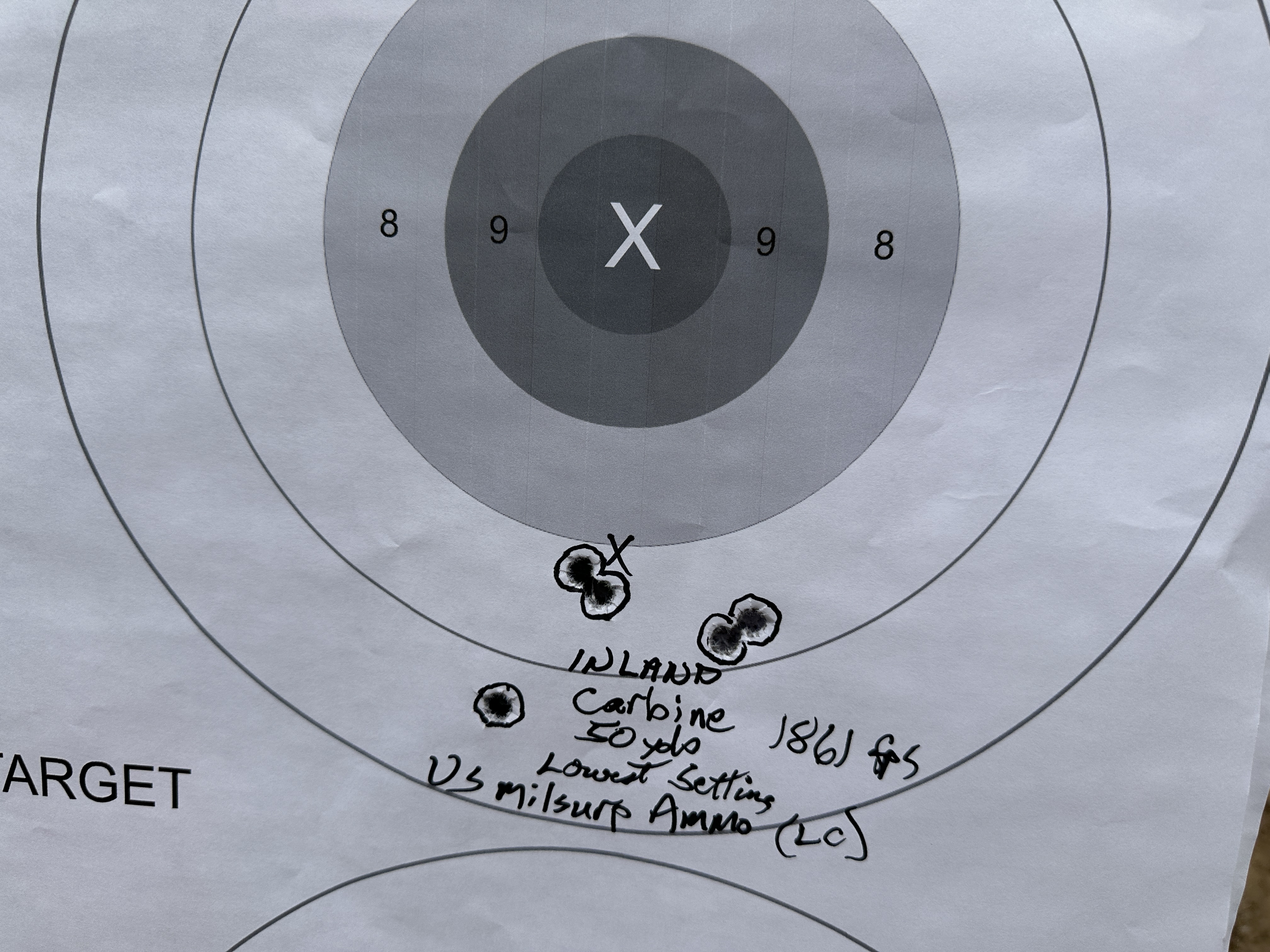

    Went to the range with the inland carbine and my 8 year old son. Used some
    Of the milsurp ammo at 50 yards. Aiming at 6 o’clock. My boy out shot me. ?
    The printed target was mine. Big black dot was my sons. Minus his flyer he got a great group.

    Looks good! Is the rear sight still set for 200 or 250 yds ? I have an older brother who has shot quite a bit of corrosive Chinese ammo through his Inland with no problems, but has been used to shooting WWII GI 30-06 in his Springfields since the mid 50's - also spent 20 yrs in the Army. I agree with Wayne about the gas system concerns on the carbines and that the Frenchicon stuff would be a "no-no". - Bob
    The site was set to 100. I tried shooting first at the lowest setting which is all the way down just below the 100 but it kept popping back up to the 100 every time I shot. Even at 50 yards the 100 sites was giving me Impact 2 low or so from point of aim.
