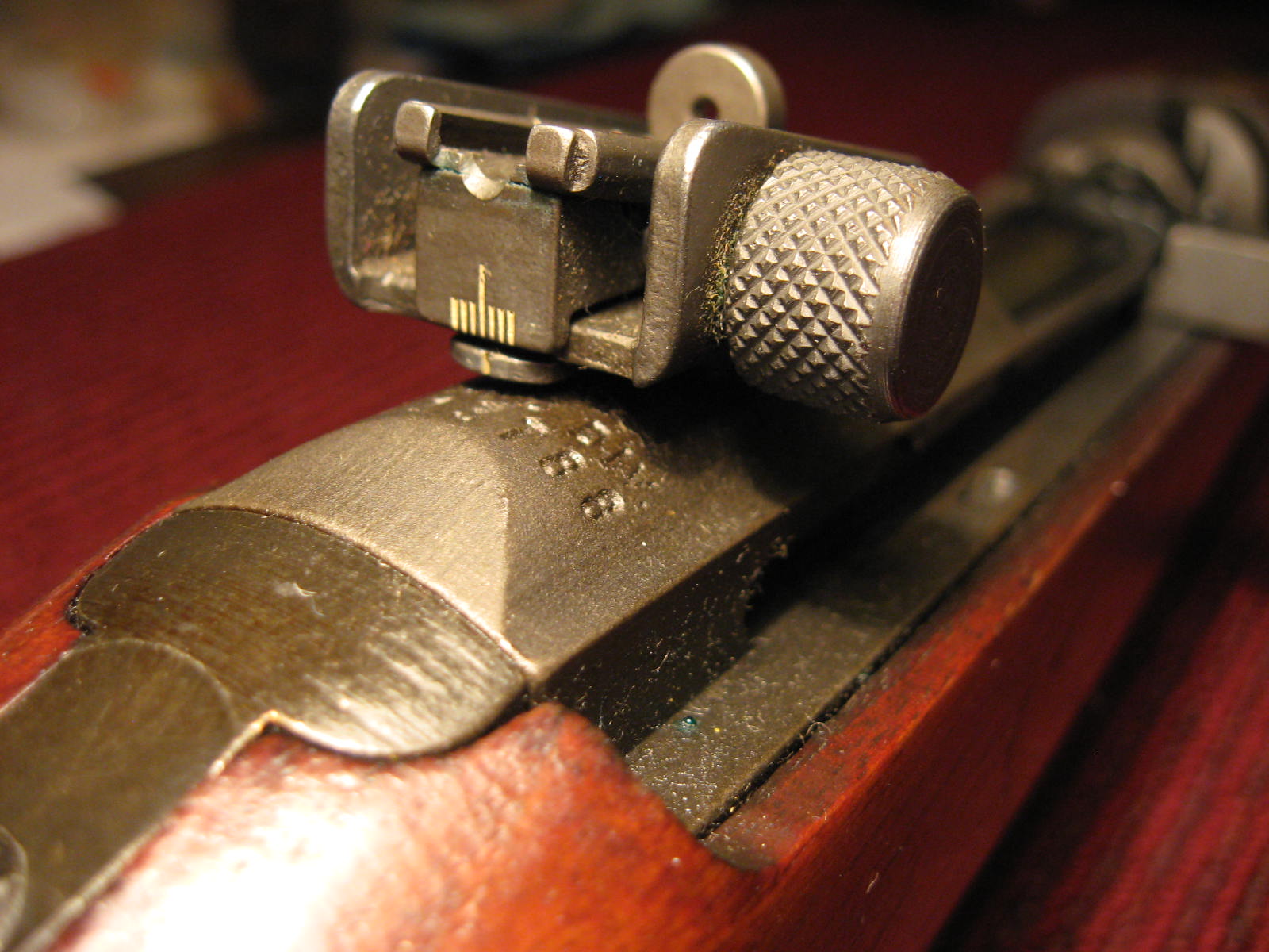

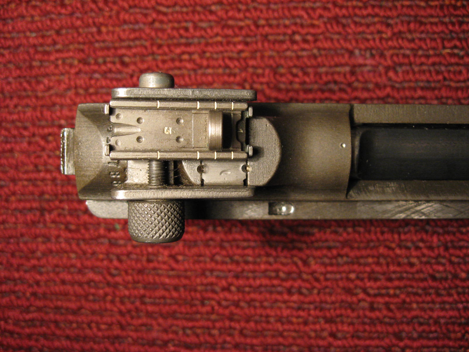

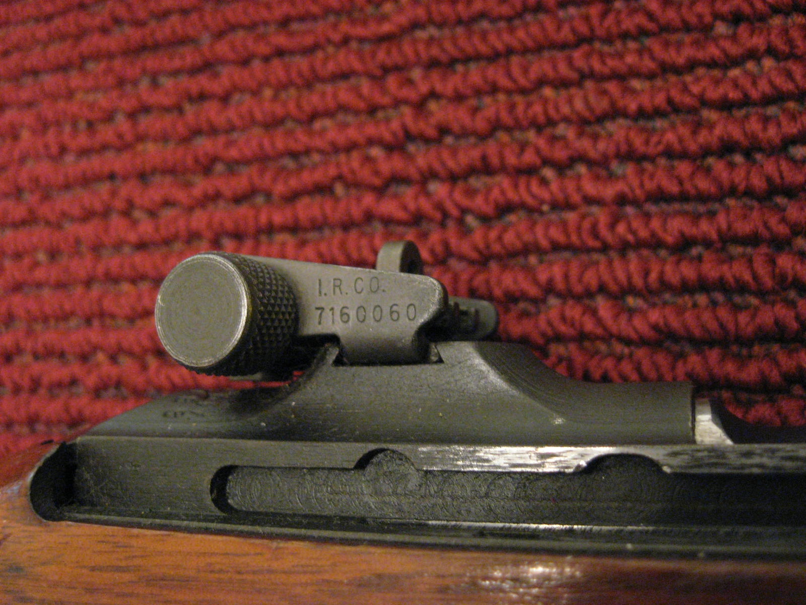

    Here's another Inland, fairly early in the 5M range with the same Type 3 rear sight. This one hit pretty much right on for elevation at 25 yards with the aperture set in the lowest position. Your sight must be set at 200-250? If it hits point of aim at close range with that setting, it likely means that the front sight is likely not the original - or maybe it originally had a Type 1 leaf rear sight and never got targeted after being changed. Move your windage adjustment all the way to one side to see if the original stake marks for the sight look close to what my picture shows. This one of mine had some other incorrect parts, but no rebuild marks on the stock. The barrel was an Inland dated 8-44. You've got a nice carbine there! - Bob

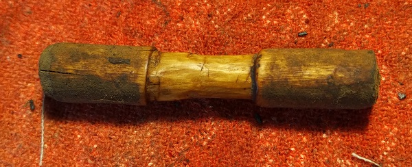

    I can't find that Oiler in any of my books. USGI or Import part ??

    Similar to this one from Ethiopia Charlie! Stop taking naps and you would know these things!

    Wayne, I never was much for naps except in school. I've been busy (between rains) trying to get ready for Winter. Rule of thumb: Ready for Winter by Halloween and ready for Spring by April Fools day.
    OP's oiler looks like Southern Hard Pine to me from what little I can see. Think that Carbine could have been a DCM or NRA release?
    One of my early carbines came with a cut off piece of brass colored curtain rod for a oiler. I hadn't noticed yet but Marcus seen it right away and gave me crap about it. I should have saved and Auctioned as 'Experimental' Sling Holding Device. It looked like it was from a old rod Also might have worked as a Trigger spring tool.
    LOL. That’s an experimental pine sap oiler, or so my cousin says?. How hard would it be to acquire a correct original boiler for that rear sling slot?

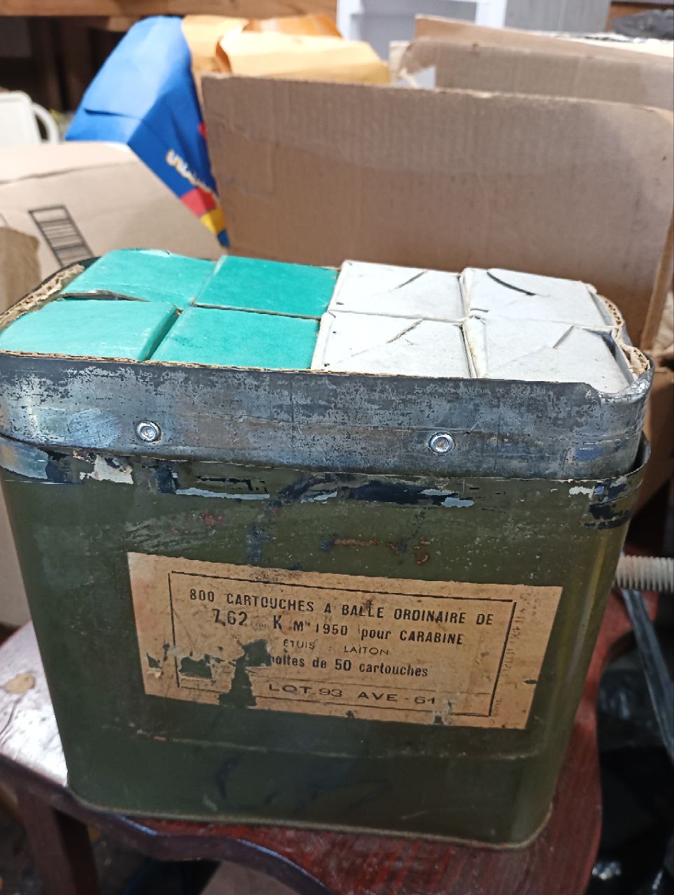

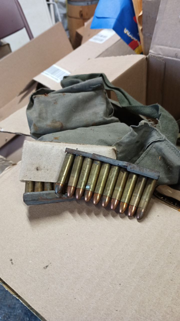

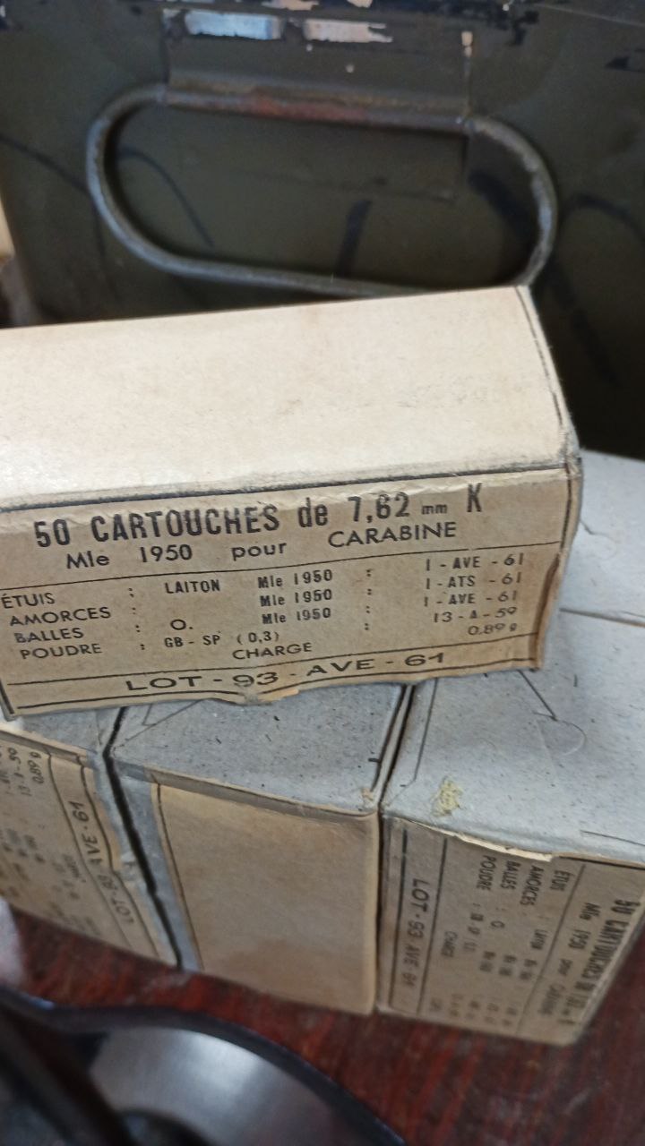

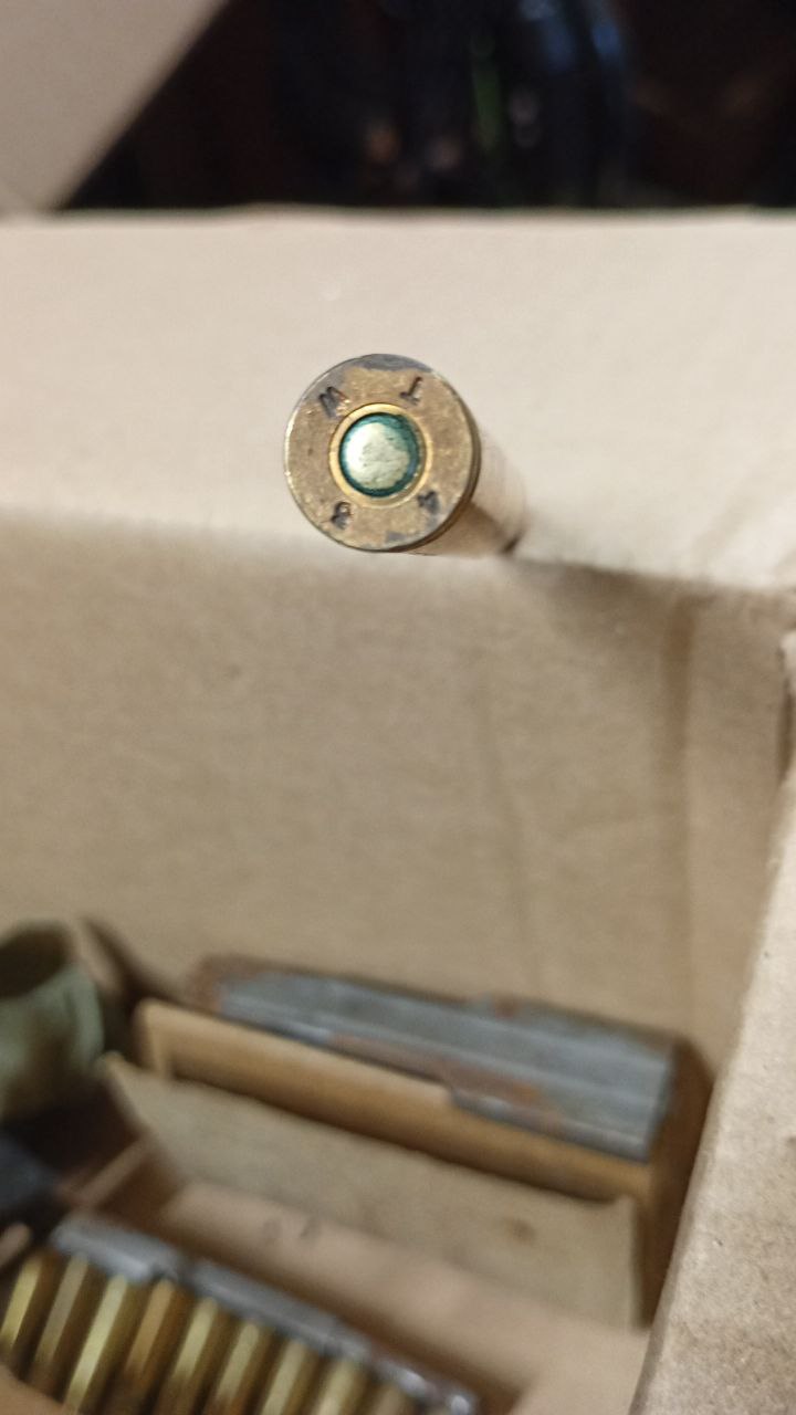

    Look what my cousin found in another shed. Approximately 800+ rounds. Anyone know the origins of this ammo? Labels look Frenchicon. Corrosive? Safe?
    The green boxes are apparently commercial reloads. Warning says not for use in cast receivers. Is that the case with these USGI carbines?
    Looks like ones on stripper clips from green bandoleer say LC 52. Possibly the Chinese? How would I tell?
