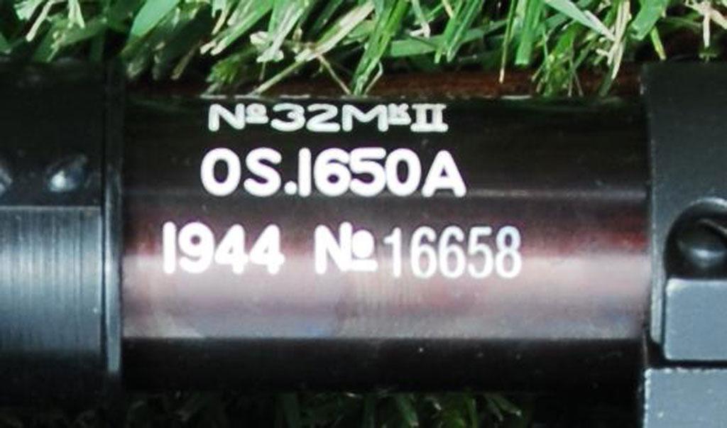

    Attachment 40595Speaking of reasonable.....not a copy, but I mentioned this one dropping it's bundle on the range.
    Stripped it this morning, lens are still good, so I'm not sure what caused the blurryness, but one of the backlash springs has broken and jammed the windage, maybe it was the spring wire sticking in the middle of the lens that gave it the blurry look. Great days.Attachment 40596Attachment 40594
