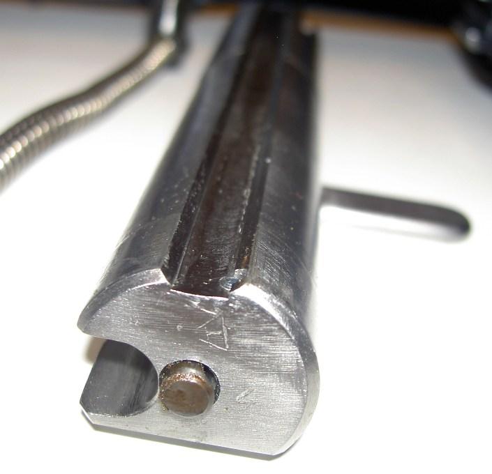

    Thought some of you might like to see pictures of the semi-auto PPS-43-C pistol made in Radom, Poland and imported by I.O.
    The folding butt is welded in the closed position. By law here that makes it a pistol and it has been converted to semi-auto only. Under the butt plate you can see the denial trough that keeps a full-auto bolt from being installed.
    It’s very easy to open for cleaning. Just press the latch with your thumb and it folds open. The bolt and captured return spring assemble come out as one.
    It has been modified to a hammer fired system. The hammer spring is very powerful and has no trouble with hard primed ammo.
    A channel has been milled it the top of the bolt so it can pass the denial ridge inside the top of the receiver.
    Here you can see the firing pin inside the bolt and the slot cut in the return spring assembly lug.
    It’s not an original PPS-43, but for around $350 it’s very nice shooter.

    It could be converted to an SBR (Short Barreled Rifle). The tax stamp would be $200. It would also need a new folding mechanism. The one in it is welded solid and would have to be cut out.
    My son-in-law has the carbine. It has a 16” barrel and the butt can be extended and folded. That’s the one I would SBR since it would be very easy to just shorten the barrel.
    All the cheap surplus 7.62x25mm has been used up here. But it’s only a semi and you can only shoot so much. I shoot it with a chamber liner in the old Enfields that might not be able to handle pull powered .303. Children love it because it has no recoil.
    The longer barrel doesn’t seem to increase performance much. I think around 10” would get most of the performance out of it. The long Enfield barrel does make it quieter though.
    I am envious those cheap and plentiful SVT-40’s you guys have up there. 54R is still plentiful and cheap here.
