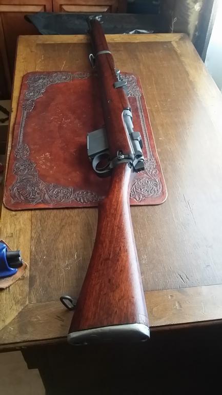

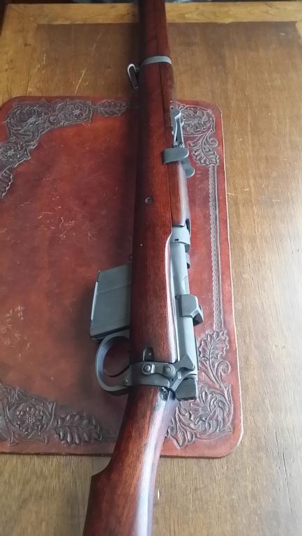

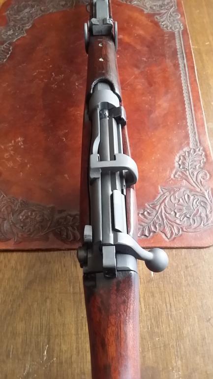

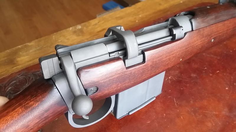

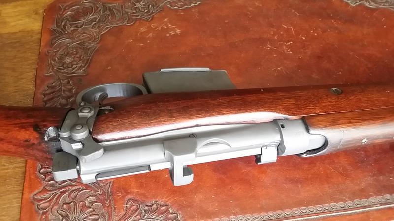

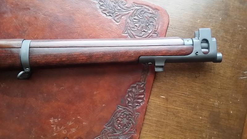

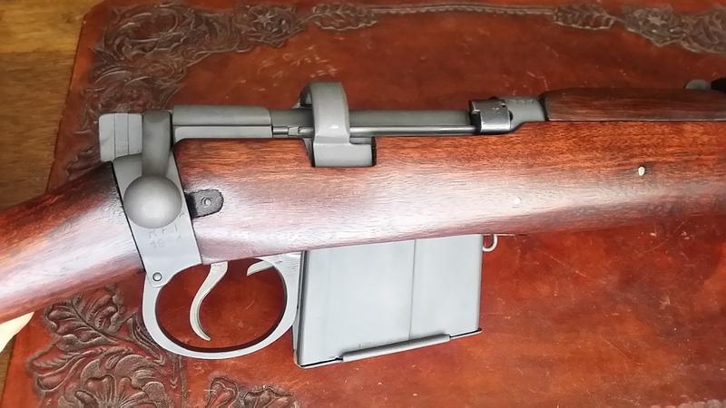

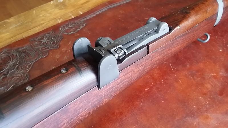

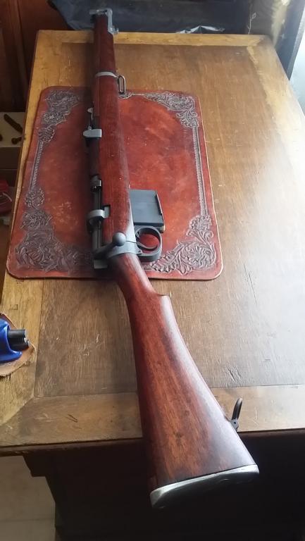

    well, I am done for now. Simply because I am tired and still need to find a non-warped forestock. Yes, Mr. Laidlericon was right in saying warped wood will tend to go back to being warped. Exactly what happened here.
    I did find a good bolt head to use with this rifle. Headspacing is good for .308 and 7.62x51.
    Parkerizing came out grayer than I hoped, but it is ok for now. At least the metal is protected.
    I did learn a lot from all of you, so thank you. And yes, I could have done a better job if I didn't spend time on things that eventually didn't work out, but I am stubborn and learn from my mistakes better than from listening to others (yes, I am dumb that way).
    Here are some pics.

    You better turn that lower band around before you get yelled at my someone more prominent! Screw heads face left lad!

    06:44 PM
    Oops! Will do that. I was feeling very disappointed by the re-warped forestock and my mind went blank.

    It looks very nice aesthetically. Well done

    Thank you very much, sir. I was pretty unhappy with the re-warped stock, so you were absolutely right, it went back to where it wanted to be originally. The nose cap now contacts the front sight base on the left side, so I am very disappointed. Will be looking for new wood (unwarped).
    So it has the looks, but I am not sure how well it will group. Will find out soon and report back.

    It certainly has come a long way from the first pictures you posted. Very nice job.

    Certainly looks 100% better, nice job on the parkerizing too, I gather thats a Zinc based solution? Don't be disappointed either, I,m sure a few on here would be happy to give it a home.

    Well, I ordered another forestock. Perhaps third one will be better. I am calling them tomorrow to make sure someone takes a look at it before it ships. And if it is not warped, I will simply fit the new one to everything else.
    Meanwhile I will be taking it to the range soon and seeing what it can do. Will try to take video and pictures.
    Oh, by the way, funny story. So I ordered a few bolt heads, and got the longer ones I asked for. One was so long that it didn't allow the bolt to close on .308 go gauge. And it was apparently swaged on the sides. Even though I removed that excess material it still wouldn't close on the go gauge. We then turned to the one down in size. Voila! Perfect size. Get it parkerized, I take the rifle home and assemble. Only to realize that the bolt head is machined off center. Meaning the face and head is at a 5 degree angle to the tenon. Maybe it was bent. Regardless, with a face at an angle I would be getting good contact with the back of the case... so scraped it. Luckily I had a third bolt head that was overturning just a slight amount, but when in place, it produced just the right amount of headspace. So that is why you see an unparkerized bolt head on the rifle.
