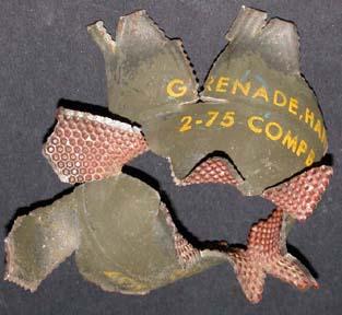

    Here is a modern M67 note the "peels" from top to bottom.

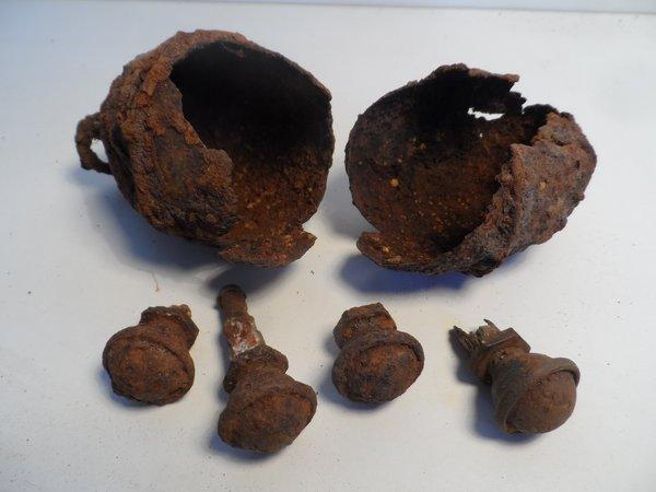

    Germanicon Egg grenade dig ups:
    Two piece besozzib design, failed where it screws together and only generated 4 lethal fragments.

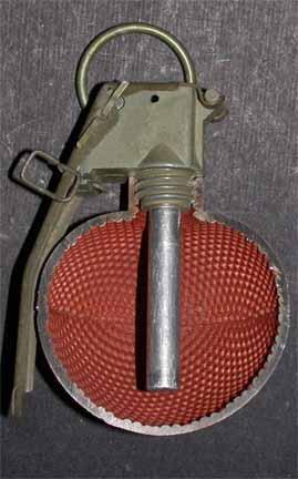

    What I always found interesting Darren is that although we were committed to teach the troops the M67 has a coiled, segmented wire inside...you can clearly see it's not. It's a stippled solid steel casing.
    We had one go blind in that it only blew the ends out and no more.
    Another myth "Exploded" if you will.
    I too have pieces but didn't feel the urge to carry on this ridiculous argument.

    M67

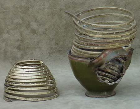

    This older M26 "Lemon" grenade might be the source of the wire wrapped myth. They were adopted in the 1950's but I have never used one, they have been replaced in CDN service by the C13 (M67) entirely.

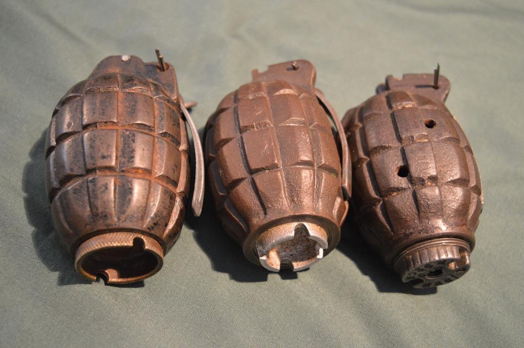

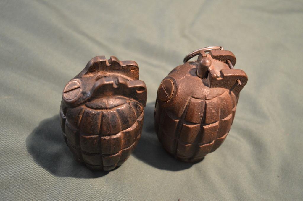

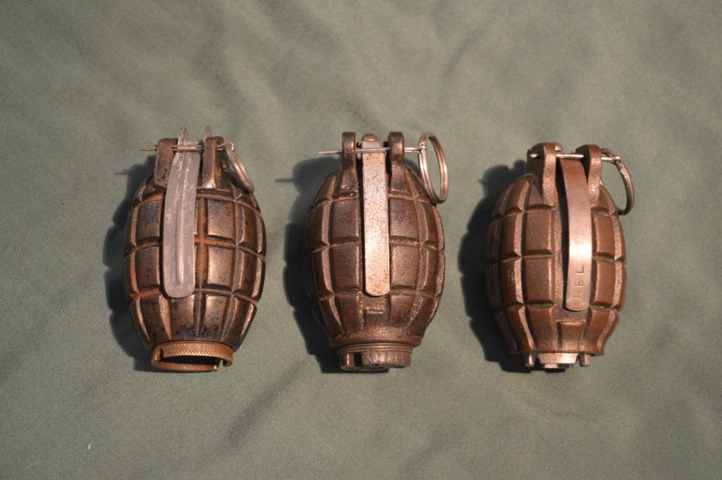

    Certainly an interesting thread, as Peter has mentioned the No36, thought some pics would go down well, one of these I've had since I was 15..... the other two a No5 and No36 I picked up at the War and Peace show this year with the intention of moving on.... strange as it sounds the wife actually likes them.......... the No5 was with out the lever or spoon as described in previous threads, but everything else was with it including the striker, the guy around the corner was selling repro bits which I bought the lever and pin, although it really belongs to the No23 but will do the job until I find one.
    Pic below the No5 is on the left, the other two are No36, the right one has a No5 1916 base plug, this is the one I've had since I was a kid.
    the main difference between the two is the top

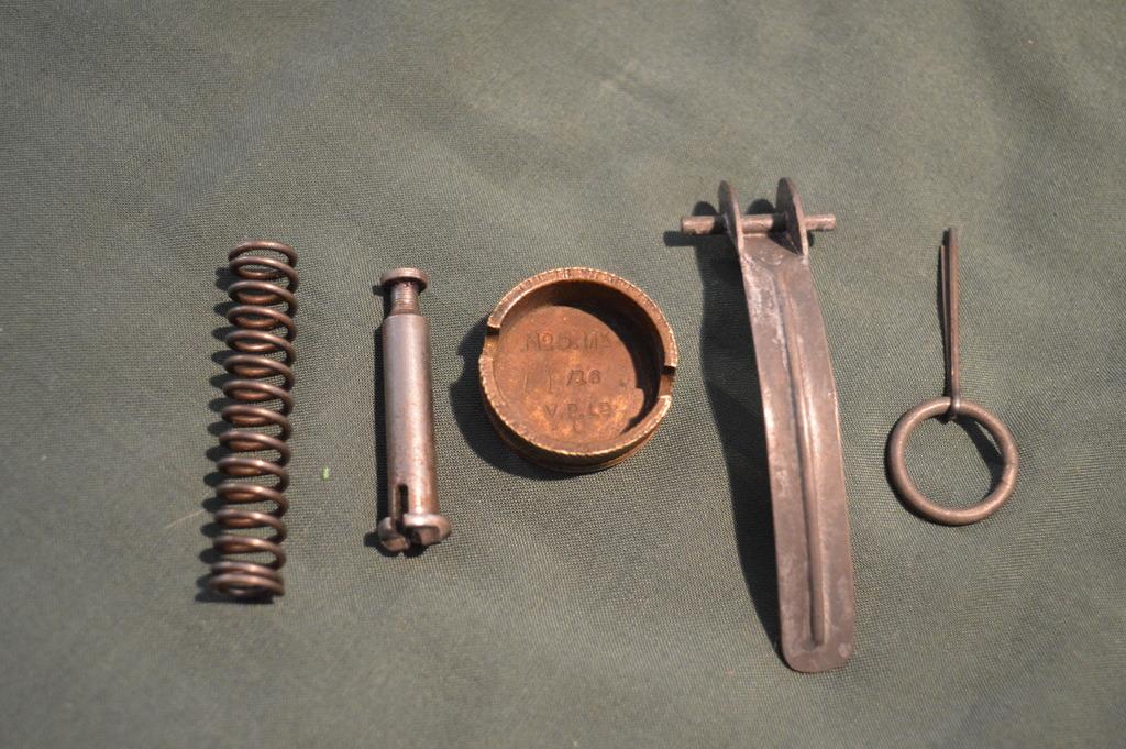

    Parts of the No5
