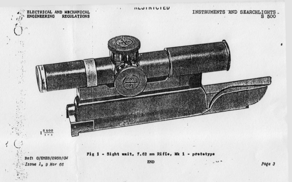

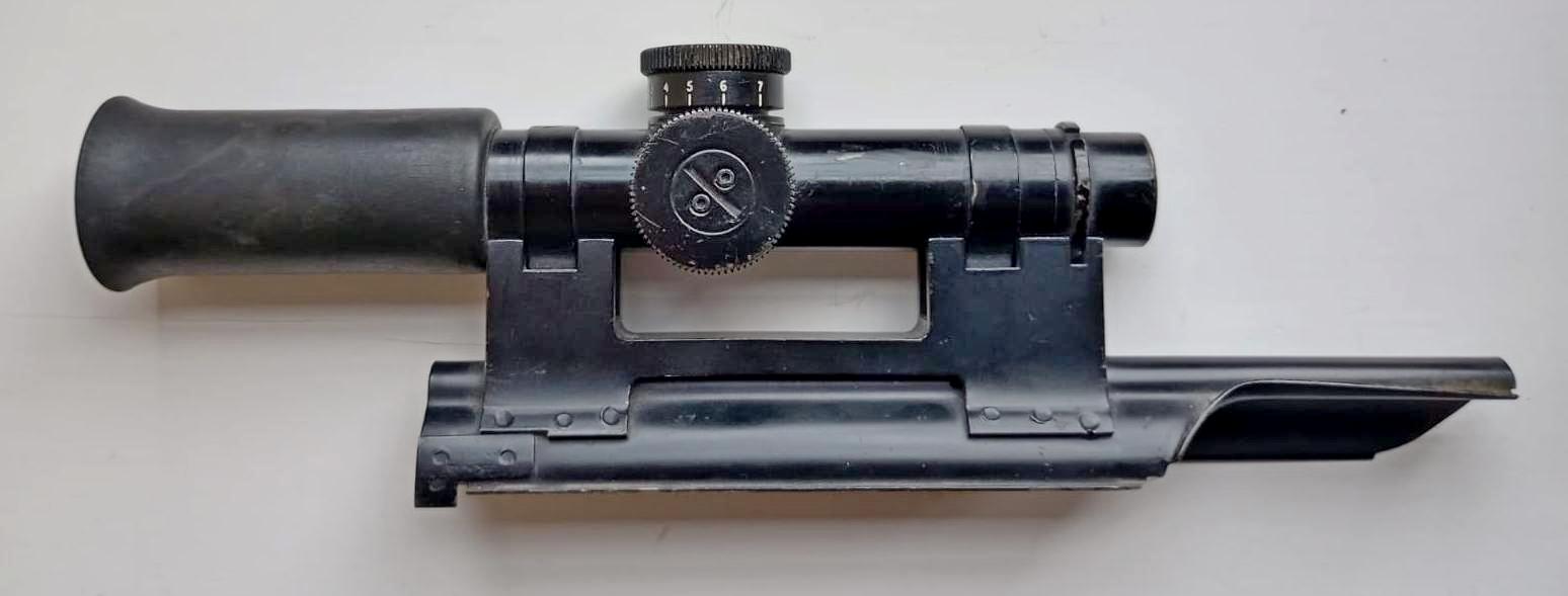

    It did make me laugh, as Pete pointed out, the No74 illustrated, is mounted the wrong way round!
    Perhaps as part of a separate trial, ensuring Snipers didn't bug out to soon, as the enemy would appear miles away!
    Judging by the markings on the elevation drum, the scope is shown correctly, but with the shade on the objective rather than the ocular - obviously wouldn't clear the mounts as shown, but probably a wiser place for it if it would have fit.

    I see your point!

    Quote Originally Posted by Lee Enfield View Post
    The prototype illustrated appears to be mounted on a modified X8E2 (Ex2) unit sight top cover.
    X8E1 X8E2 SLR Manual
    The extended scope base, addition of the locking tabs to the rear and deletion of the front locating pin.
    I think you're right, if not a modified original, then certainly based closely on it.
    Having submerged myself in the relevant section of The Fal Rifle book, the time line starts become clear.
    Varians of this scope had been trialed seriously in prototype form since 1960. It appears in 1965, someone decided to push it into production and the scope and Enfied production mount went into limited production in 1967.
    Without reference to the trials information, I'm more inclined to think the thing that killed the No74 MK1 off was an obvious inability to place shots with required accuracy at range with the L1A1.
    The switch in interest to reduced light capability scope, generally issued, (the eventual SUIT) scope, trialed in prototype form in 1969, shows the 'Sniper L1A1' must have been dead in the water by 1968 at the latest.
    Considering the abysmal failing SUIT mount that followed the No74 MK1, they couldn't have had a huge amount of issue with spot welding the mounts on...
    Or perhaps trials were stopped before that lesson could be absorbed!
    As a side note, Pete has mentioned that as far as he can recall, it was intended to pair a sight unit to a rifle by electo penciling the rifles S/N on the scopes top cover.
    I assume by testing and putting aside the most accurate rifles as designated sniper L1's.

    What's shown in the EMER is the Trials scope c1960 fitted to a modified FAL Cover, the same as used for the X8E2/EX2 optics. These Scopes were known as the No. 74 EX1 and according to the info 12 or 13 were made (depending on which page you read) S/N of scopes BL1, BL2, BL3, BL4, BL5, BL6, BL7, BL8, BL9, BL10, BL11, BL12, BL13 by R J BECK. The original 12 were returned to BECK due to a breakdown of the sealant to be examined.

    Still mounted arse about face on the top cover or is it me?

    Basic physics will put a stop to a scope of this weight being capable of reliable use. While the scope - like the SUIT - will pass the standard fastness test - or recoil test, with the Enfield layer or rest set at hard, the fact remains that the telescope will always recoil radially rearwards. It's physics at work. The telescope is good, the rifle is good but the cover is thin pressed steel, a third the thickness of a bit of car body steel
    One of the old workshop notes I have refers to repairs to the cover in the event of it splitting - notice the reinforcing piece at the rear of the cover, below the actual mount part. To be honest, in all my time, I never understood the need for the little 'stops' at the rrear of the L1 cover! It's nt as though you could push the cover on too far! They were forever splitting - due to that nasty rule of physics again. Eventually, they were simply cut off and made good. Just like FN did at the start.

    I suppose the pressing need for optics must have entailed someone looking through storage and dragging these out.
    Certainly mine has very few signs of use, it certainly points towards the No74 MK1 being cancelled almost as soon as it was manufactured.

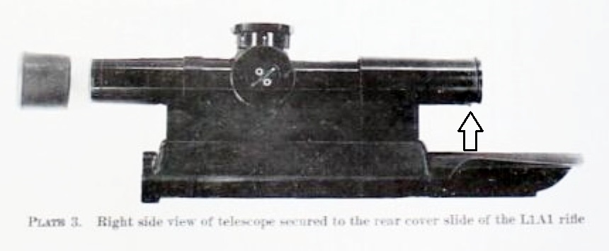

    Quote Originally Posted by Gil Boyd View Post
    No, it's the lens hoods that cause the confusion. The long hood is apparently slotted to fit over the front of the mounts, and this illustration shows the short hood for the ocular lens which was missing from the previous image(s).
    The arrow indicates where I believe we can just make out the edge of the bead on the opposite side of the slot.
    The long hood shown above fitted to the ocular end is clearly not the same type: no bead and no slot, so either a service replacment of the short hood or a civilian addition.
