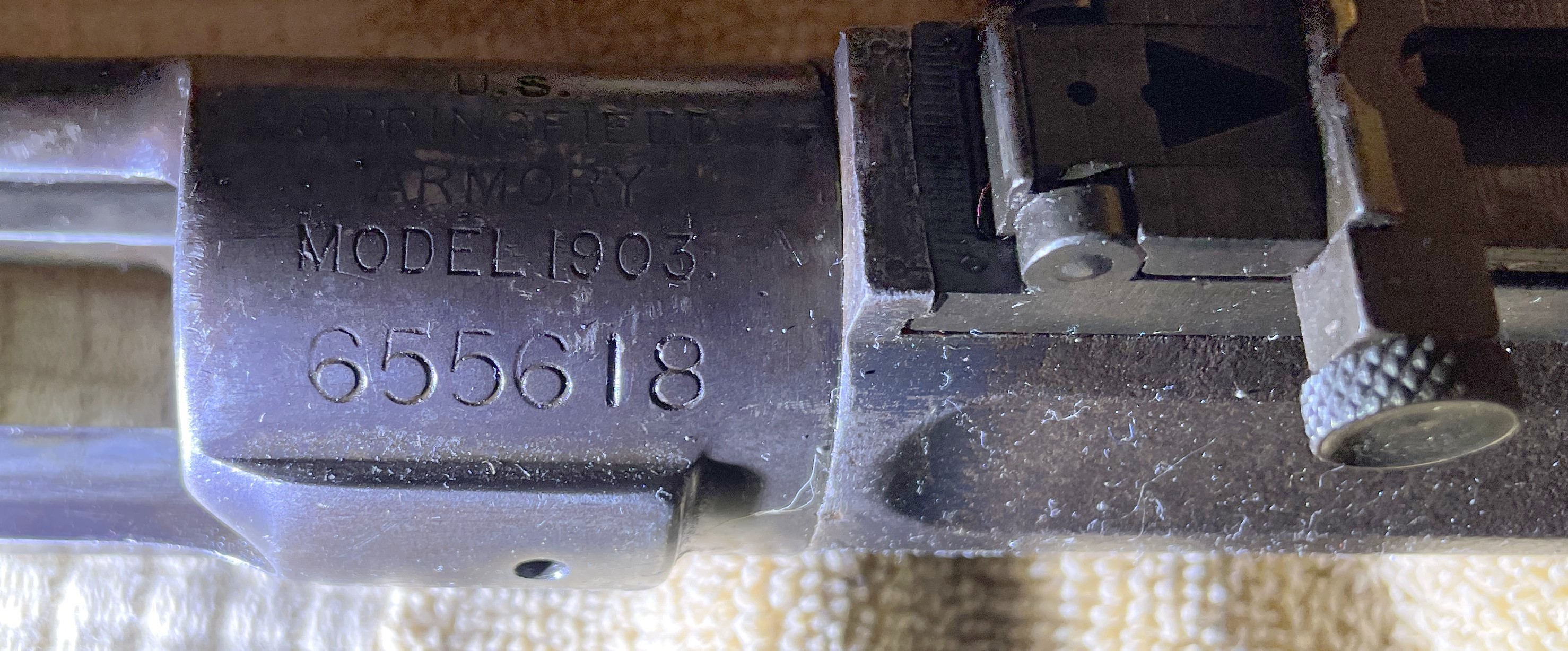

    I think the rifle I have was one built for display at some point in time, as the serial number places it in the range of the weak receivers, and the barrel is junk.
    Based on the serial number, this M1903 was originally built in 1917. Build stamp on the stock looks like it could be "D.A.L" but it was mostly obliterated by the rack stamp. The DAL stamp (assuming that is correct) places the stock between 1917 and 1918 according to Brophy (Pg 558). So, most of this firearm was, it appears, of the correct age and type to be WWI used in some fashion. Which is what I wanted for my collection. I wasn’t looking for a shooter. It appears that the rack stamp was put on after the original build but before the arsenal rebuild. Perhaps an original Navy issue?

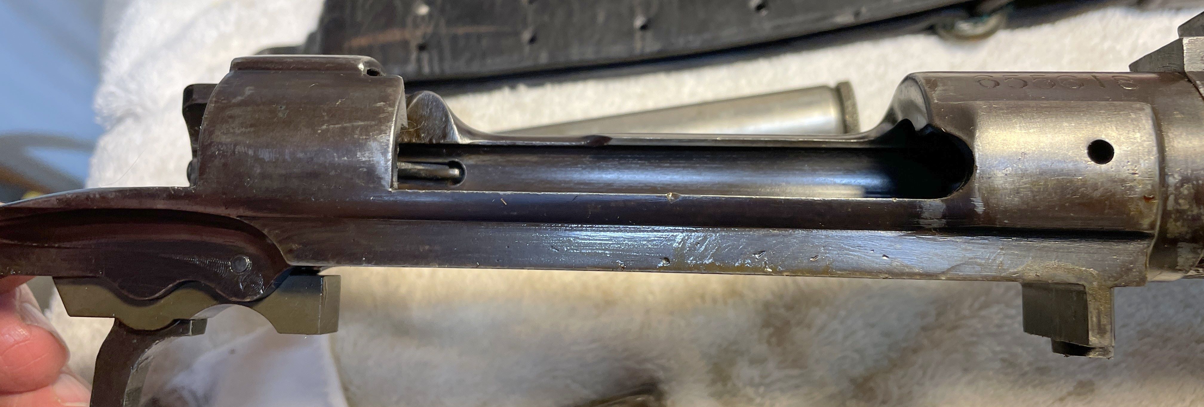

    Looks like there are a ton of different parts in this bolt, and it appears to be Remington. It looks like a match to a 1903-A3 bolt pictured in Brophy p45. Large hole and no dimples on the lug. No "N.S." marking, but several stampings where the bolt handle meets the bolt. Includes the numbers 44, 49, and not visible with the safety installed, a stamped number 10. There is an "R" stamp, and a letter "O" along what looks like a tiny snowman also. See photos.
    Standard ejector
    Standard black extractor, very little wear
    Safety lock thumbpiece, black parkerized third variation per Brophy p 49. Stamped with an "R" on the safety lever, also on the side. Number "7" with a box also on the side.
    Firing pin (striker) Carries a "R" stamp on the shoulder. Per Brophy P 54 this should be a
    Remington 1903A3 striker. Assembly shows a 1917 knob serrations.
    Cut-off is early style

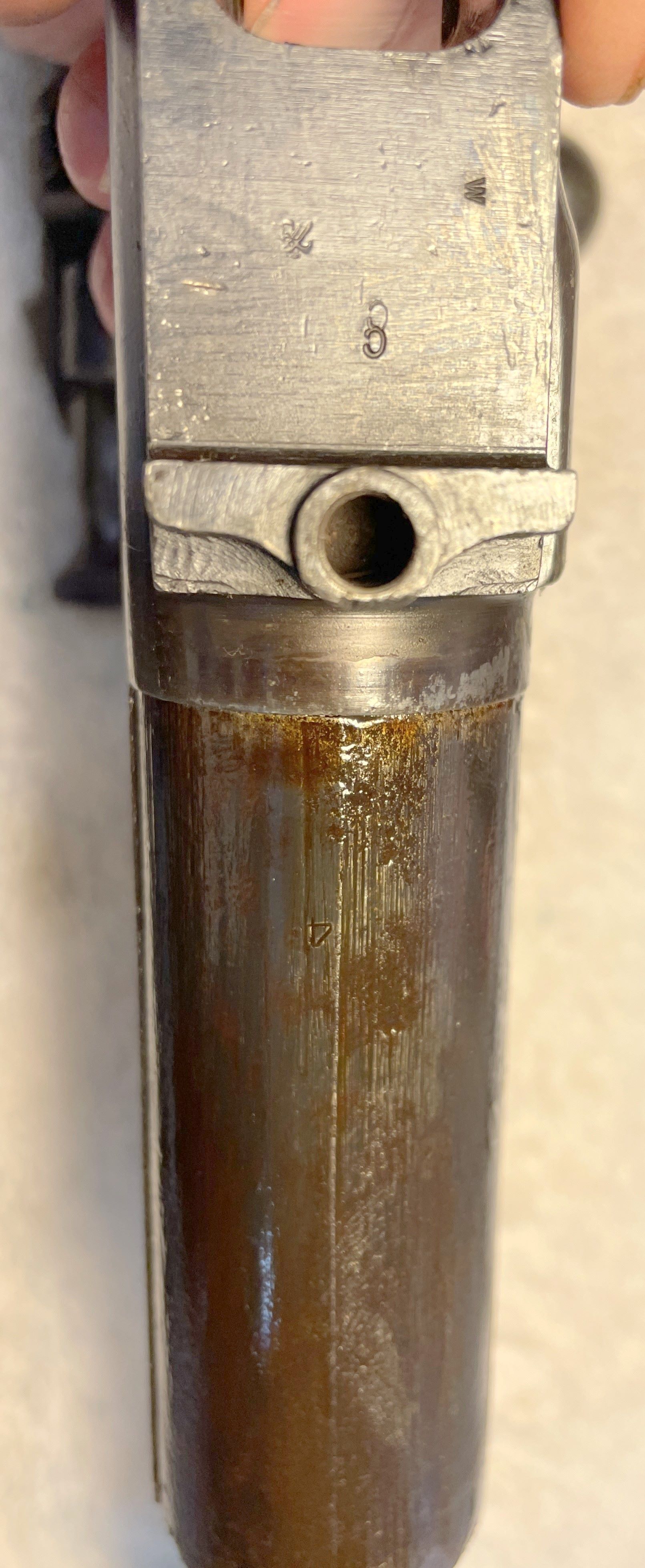

    Clearly below the 800,000 cutoff. Again, not a shooter. A few markings on the bottom, a "W", a double stamped "C" that looked like a number 8 on first glance, and an unidentifiable glyph of some kind. Also possibly a dash and a dot. Need more expert opinions here.
    Conclusions:
    The firearm looks like an arsenal rebuild sometime in the late 1930s. It looks like after it went through the rebuild, it was put into a cabinet somewhere and forgotten. However, an arsenal rebuild would have been done contrary to the policy of scrapping the below 800000 serial numbers. This would have started, according to Brophy p605, in April 1929. Well before the rebuild date. There is cosmolineicon on the barrel, a new nickel plated oiler, and a new upper stock of a later design. New bolt parts that are dark parkerized.
    One should expect a bit of a blender of parts with an arsenal rebuild. But there are some things about this one that are puzzling me. Any help appreciated.
