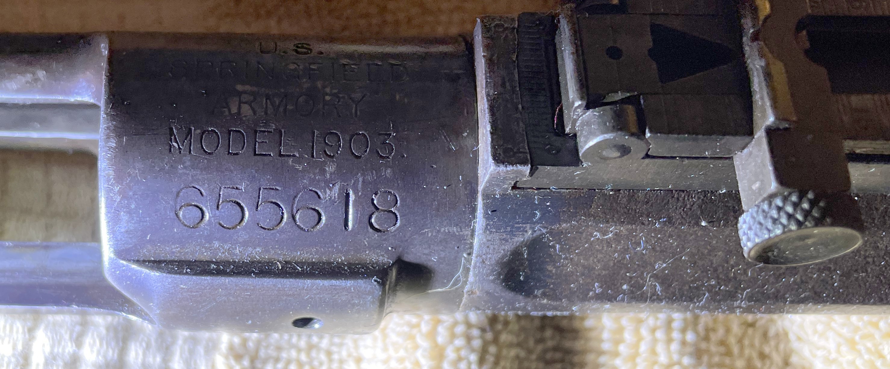

    I think the rifle I have was one built for display at some point in time, as the serial number places it in the range of the weak receivers, and the barrel is junk.
    Based on the serial number, this M1903 was originally built in 1917. Build stamp on the stock looks like it could be "D.A.L" but it was mostly obliterated by the rack stamp. The DAL stamp (assuming that is correct) places the stock between 1917 and 1918 according to Brophy (Pg 558). So, most of this firearm was, it appears, of the correct age and type to be WWI used in some fashion. Which is what I wanted for my collection. I wasn’t looking for a shooter. It appears that the rack stamp was put on after the original build but before the arsenal rebuild. Perhaps an original Navy issue?
    It was possibly sent back to Springfield armory for a rebuild sometime between1936-40. This is shown by the later "SA over SPG" stamp. But with a 1918 barrel(?!). Sometime after that it seemed to make its way into private hands.

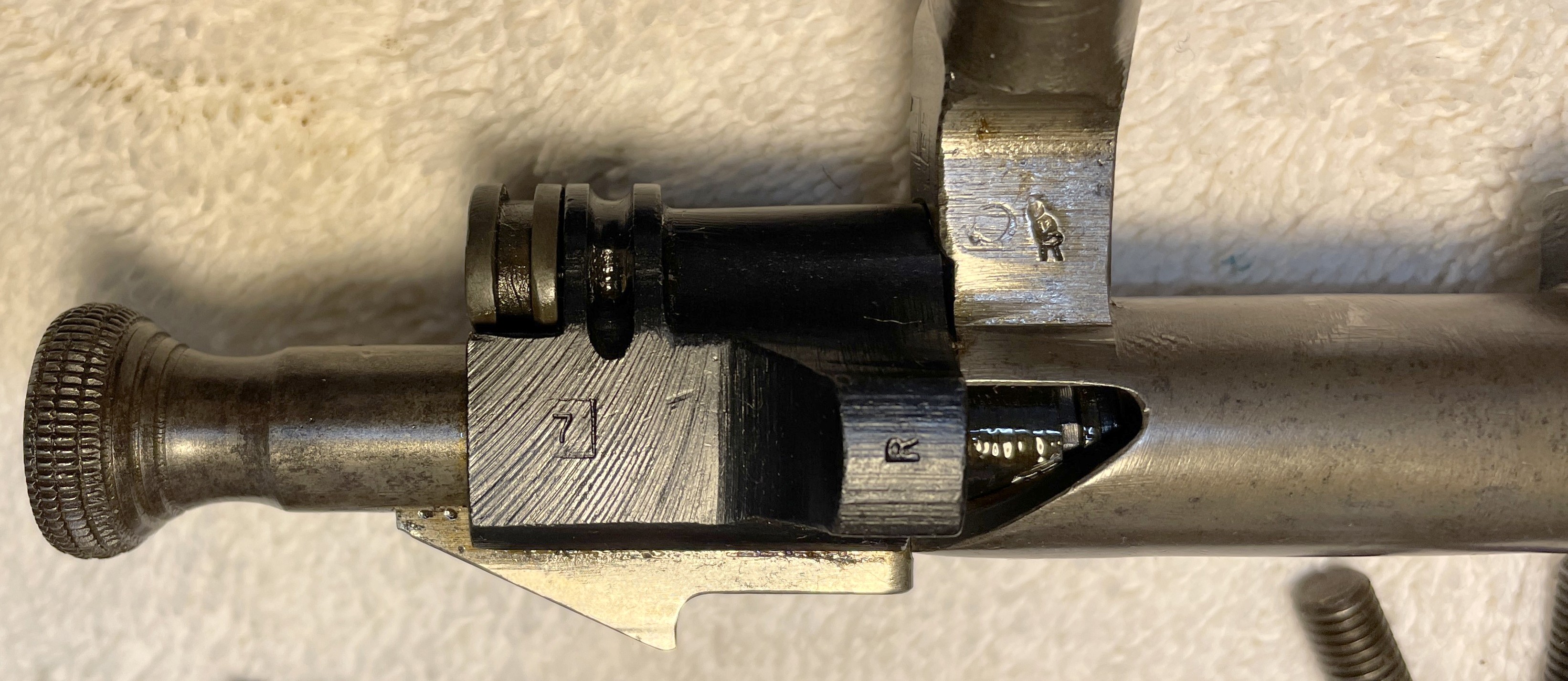

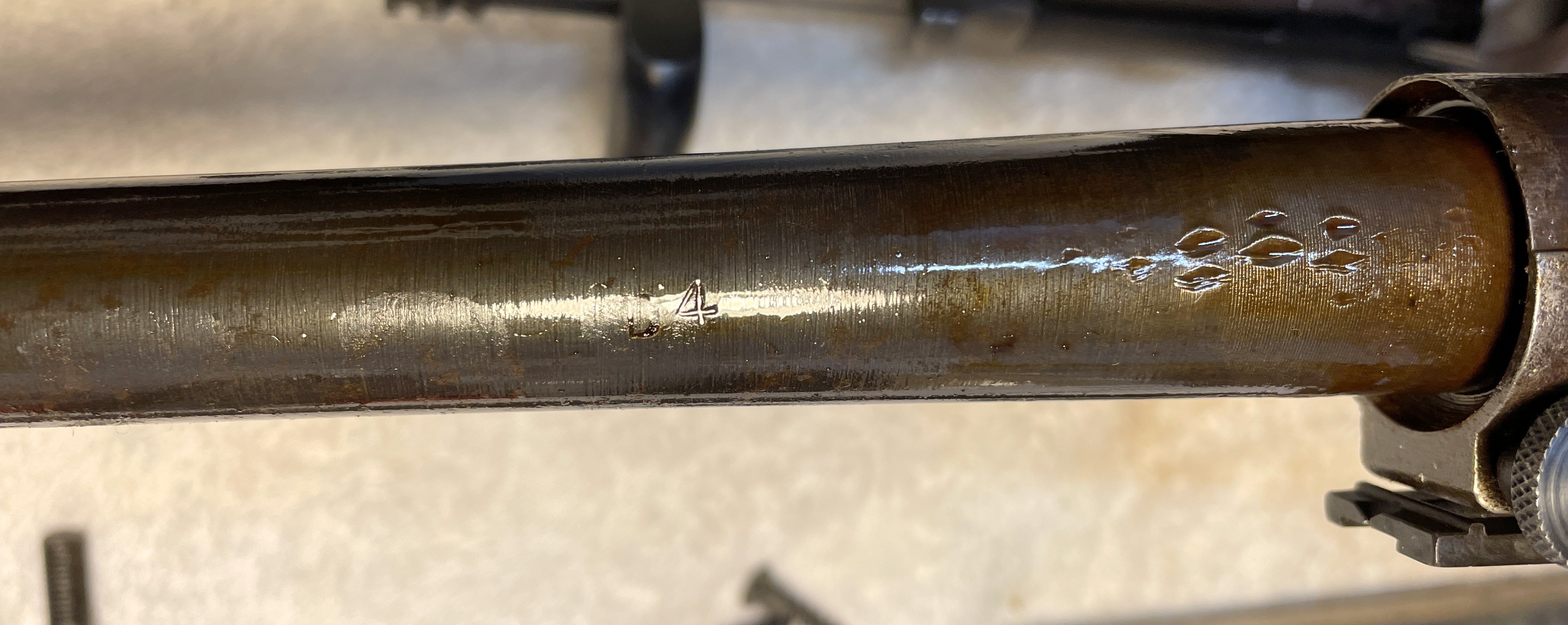

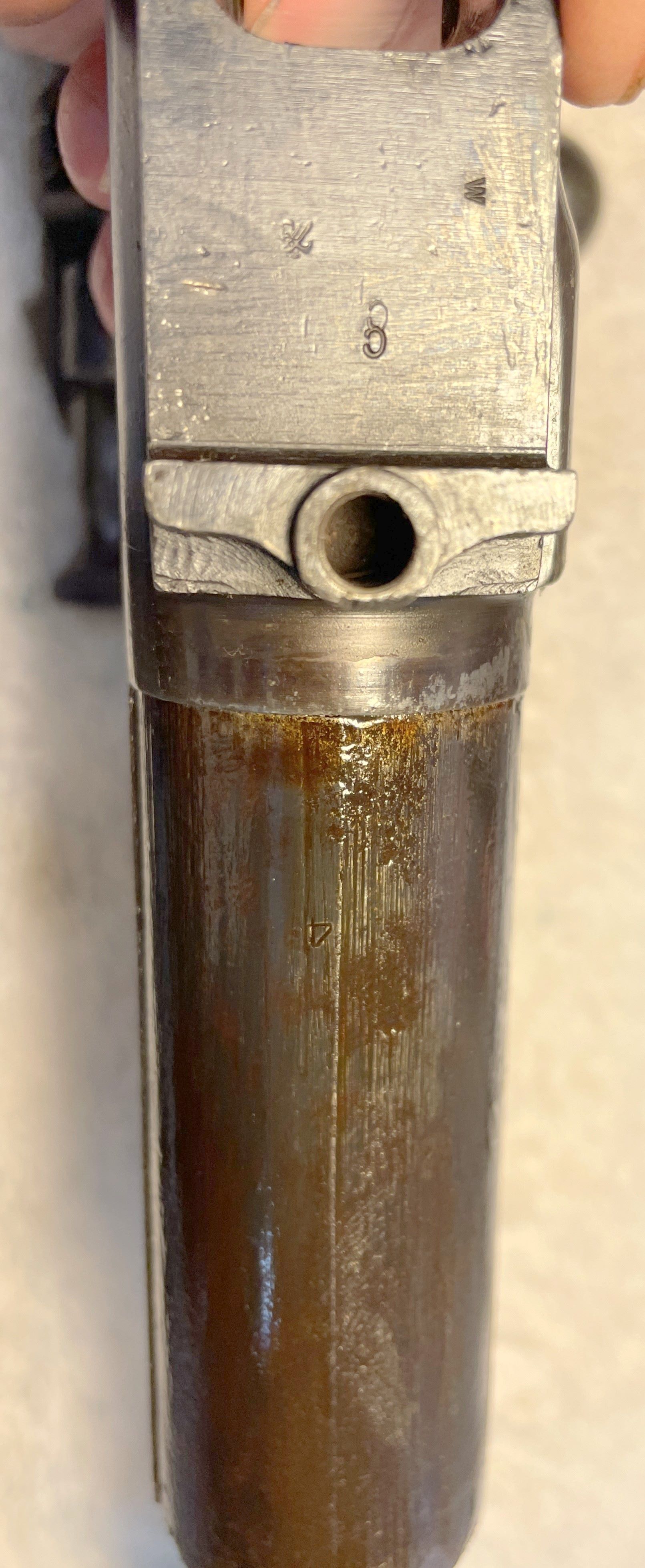

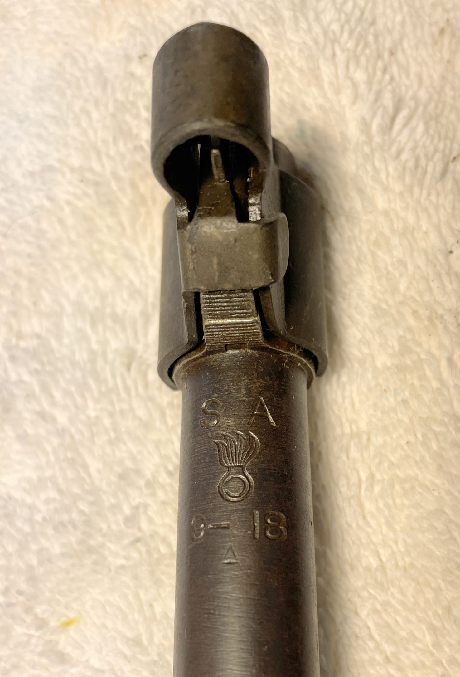

    Part 2 - Barrel
    It is marked with the typical S A flaming bomb and a 9-18 date.
    There is an additional mark below the date that looks like a letter "A" faintly stamped.

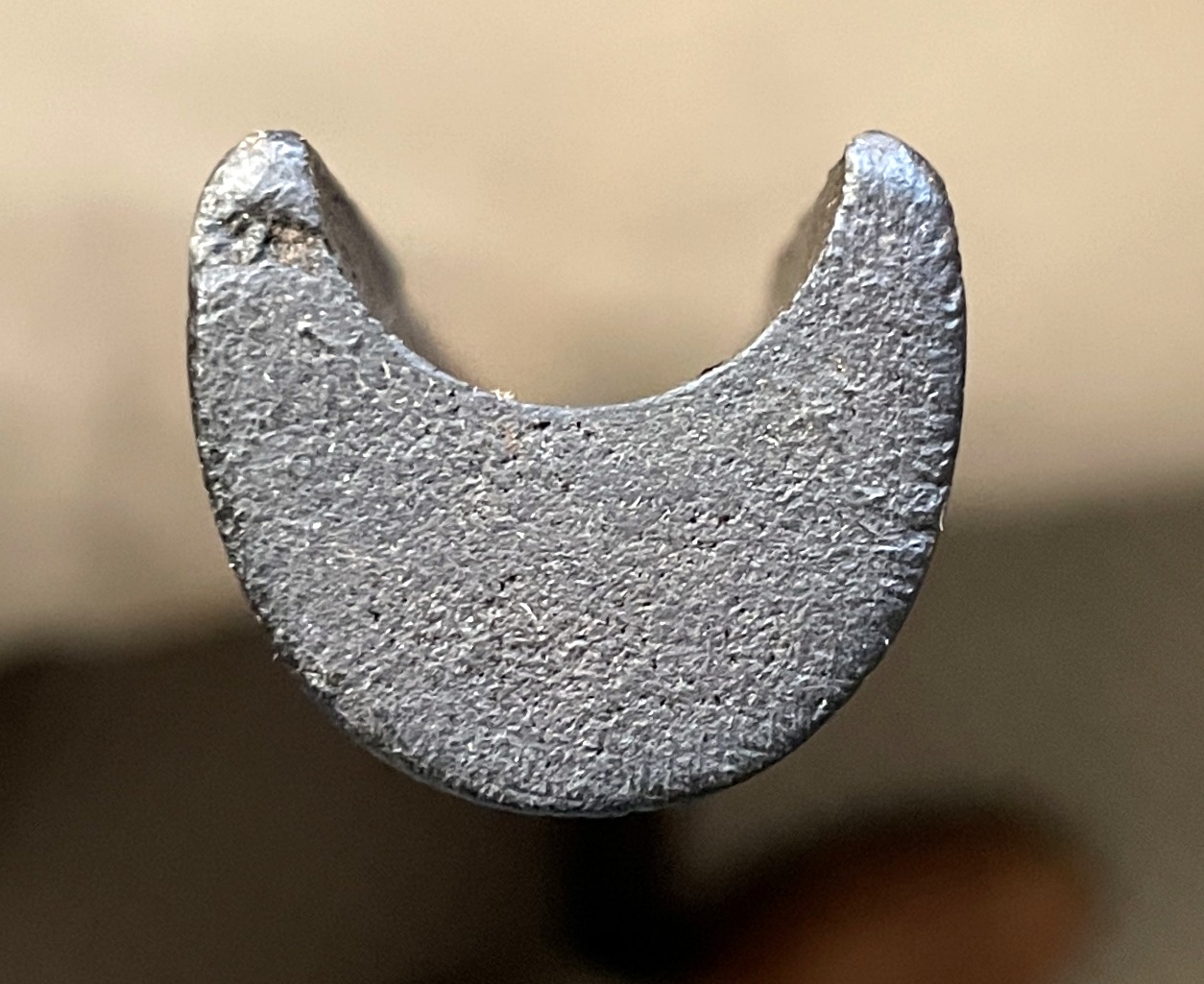

    There are a bunch of indentations on the side of the barrel that look like they are from a barrel change. With a pipe wrench! "D4" is stamped on the right side of the barrel just above the install marks. No center punch mark on the flaming bomb. Has a heavy sight cover which appears to be a USMC type, based on Brophy p 447.

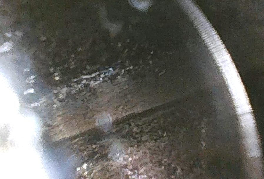

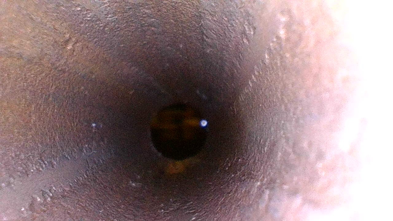

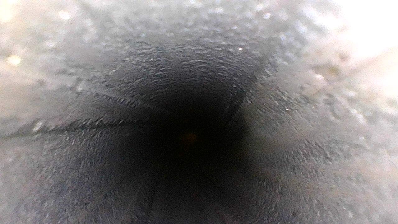

    The bore has me a bit confused. It looks rough. The rifling appears to be okay in spots, but where there is no rifling it seems to be corroded rather badly. But there is no active rust, just pitted. Pictures from a boroscope are attached. Cleaning only got me a light dusting of orange corrosion dust, absolutely no gunpowder residue. This barrel has me puzzled. It isn’t original to the receiver, but it appears to be, well, junk. Which is okay for me, as this is going to be a non-shooter.

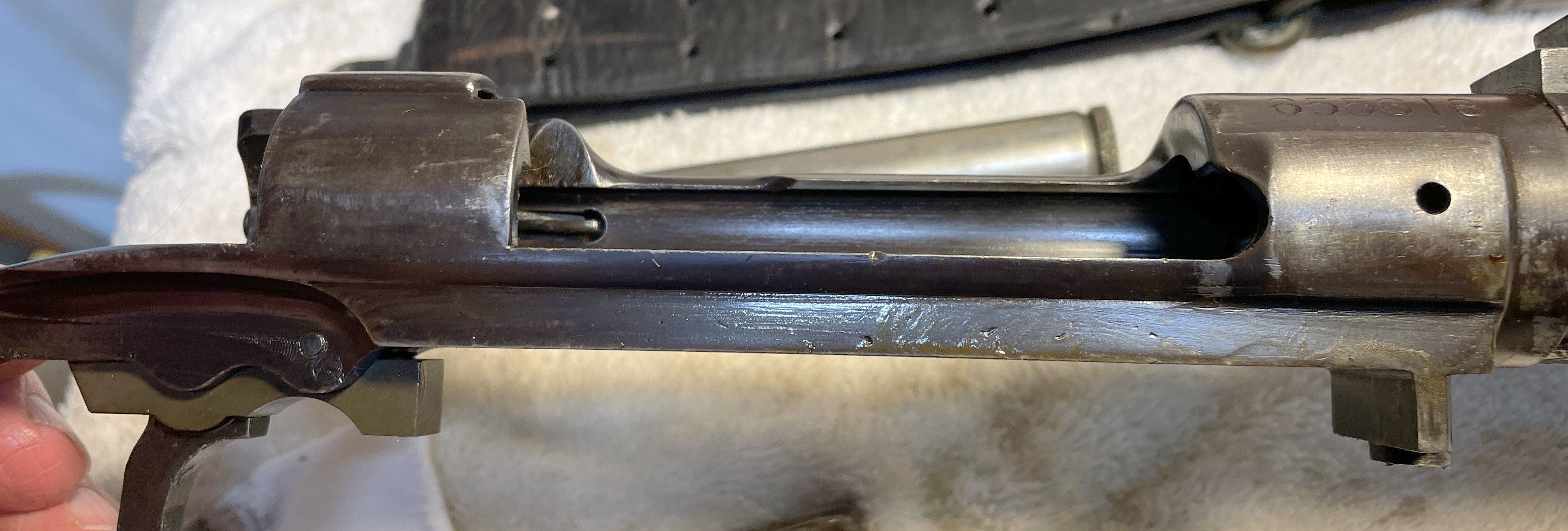

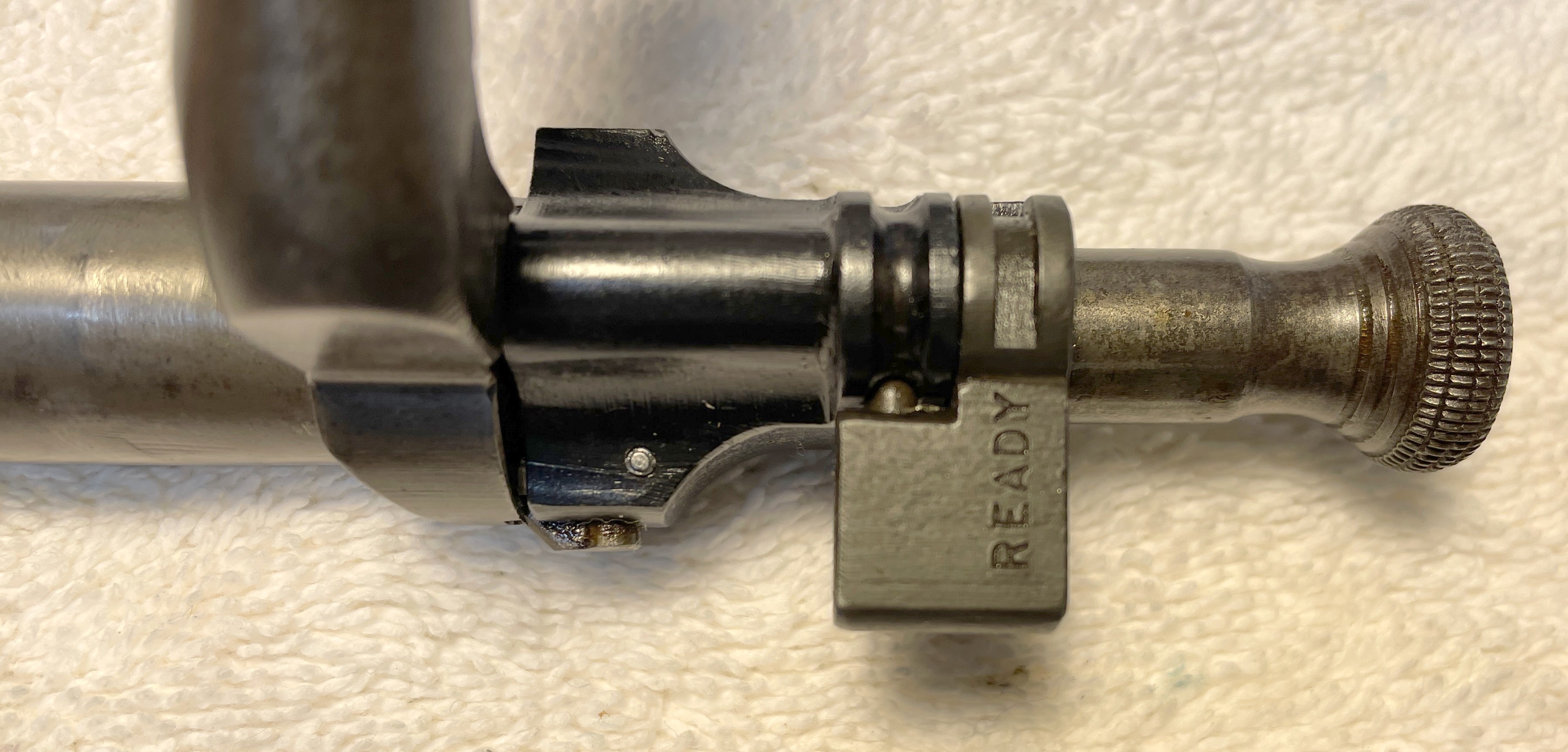

    Part 3 - Bolt

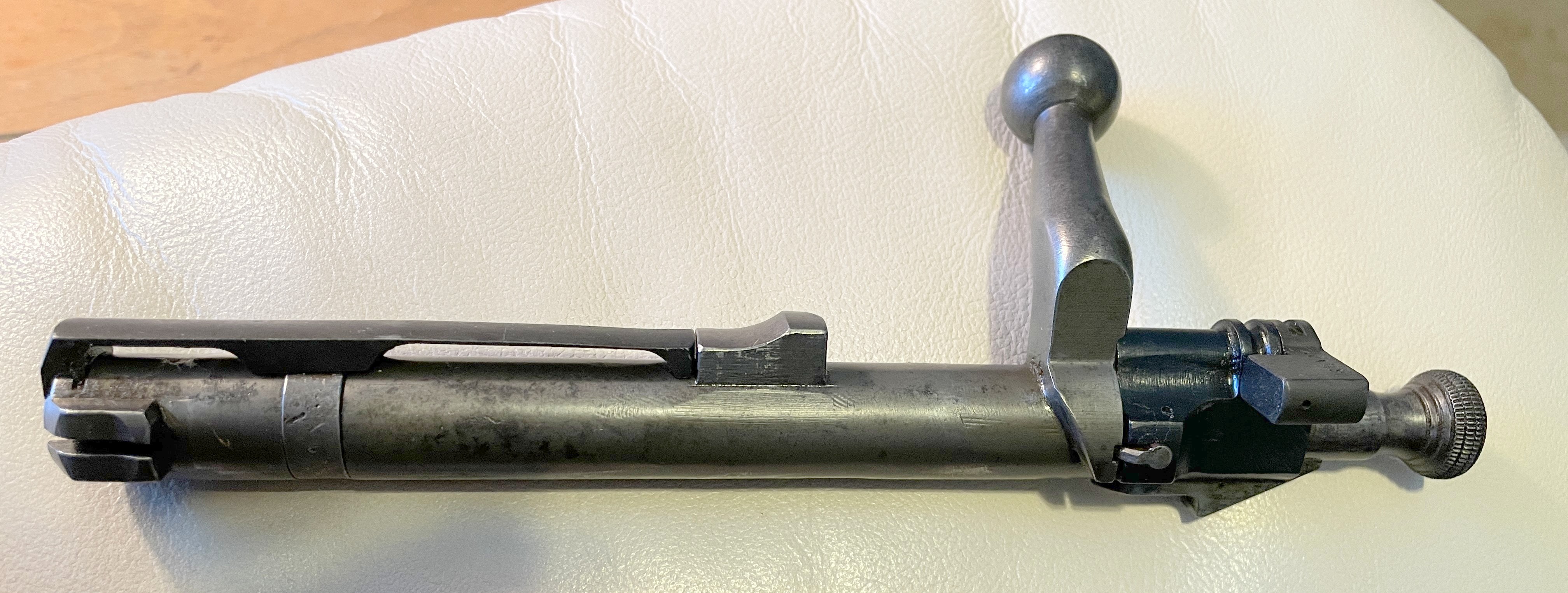

    Looks like there are a ton of different parts in this bolt, and it appears to be Remington. It looks like a match to a 1903-A3 bolt pictured in Brophy p45. Large hole and no dimples on the lug. No "N.S." marking, but several stampings where the bolt handle meets the bolt. Includes the numbers 44, 49, and not visible with the safety installed, a stamped number 10. There is an "R" stamp, and a letter "O" along what looks like a tiny snowman also. See photos.
    Standard ejector
    Standard black extractor, very little wear
    Safety lock thumbpiece, black parkerized third variation per Brophy p 49. Stamped with an "R" on the safety lever, also on the side. Number "7" with a box also on the side.

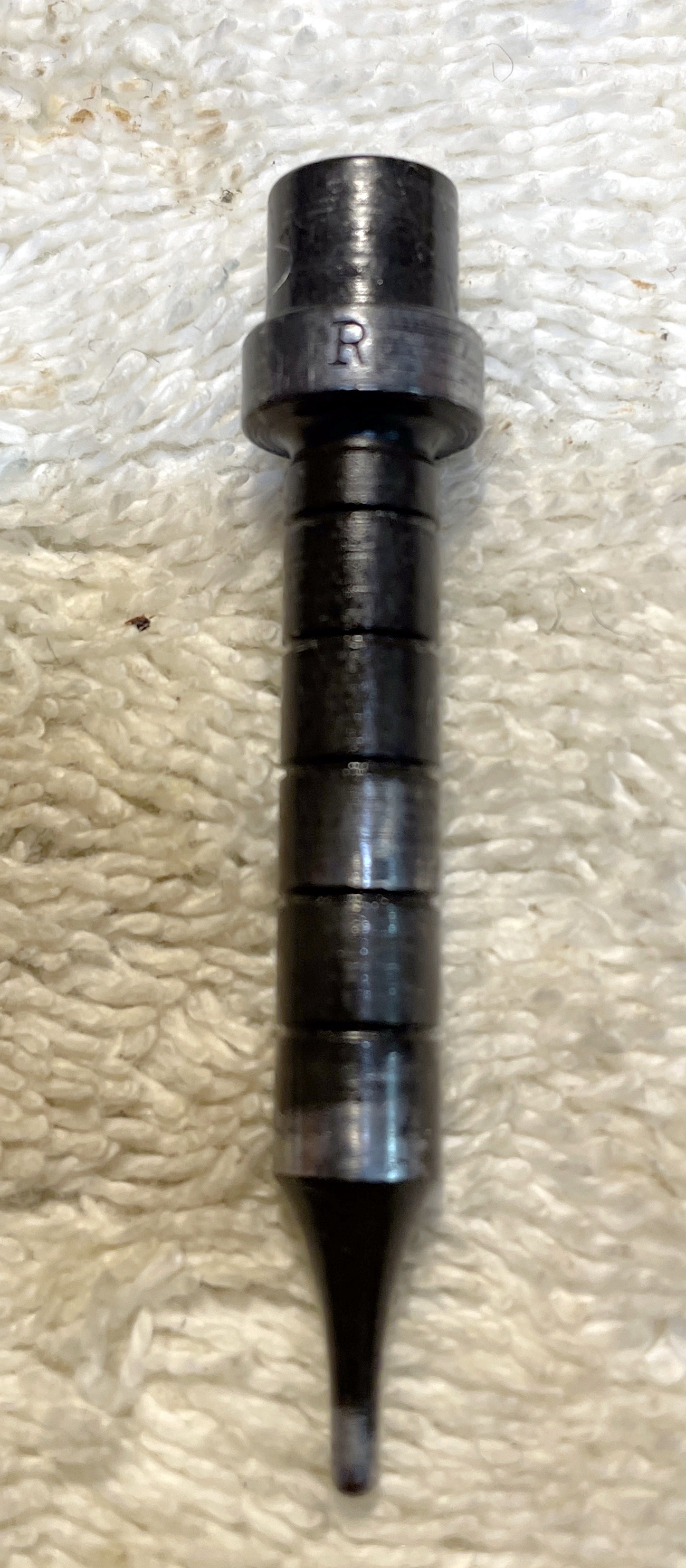

    Firing pin (striker) Carries a "R" stamp on the shoulder. Per Brophy P 54 this should be a
    Remington 1903A3 striker. Assembly shows a 1917 knob serrations.
    Cut-off is early style

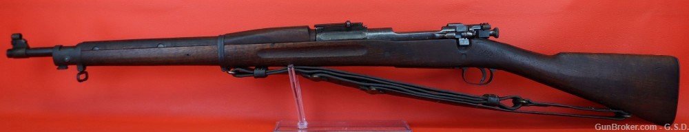

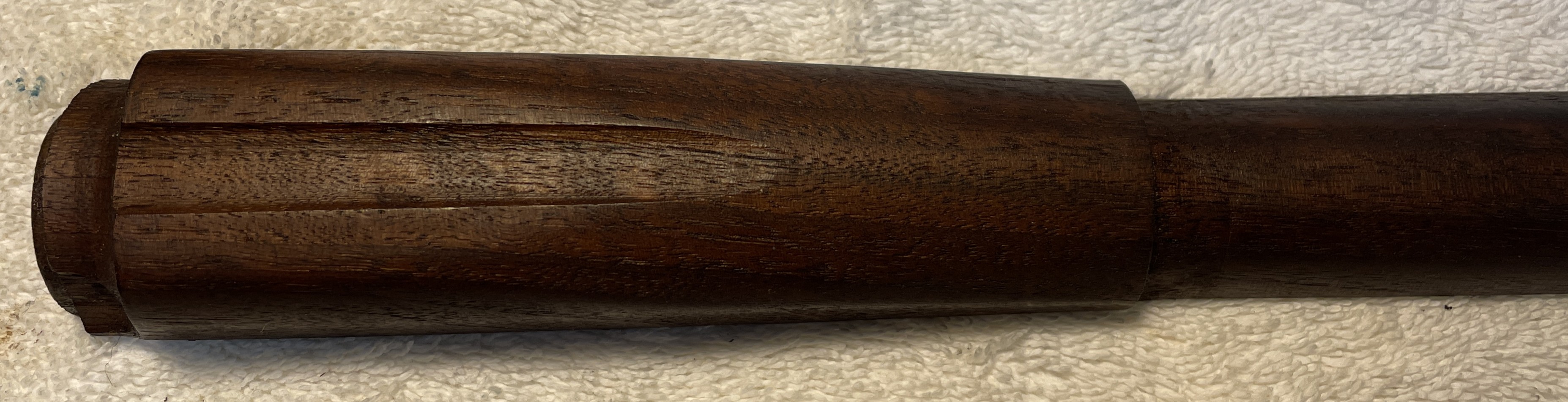

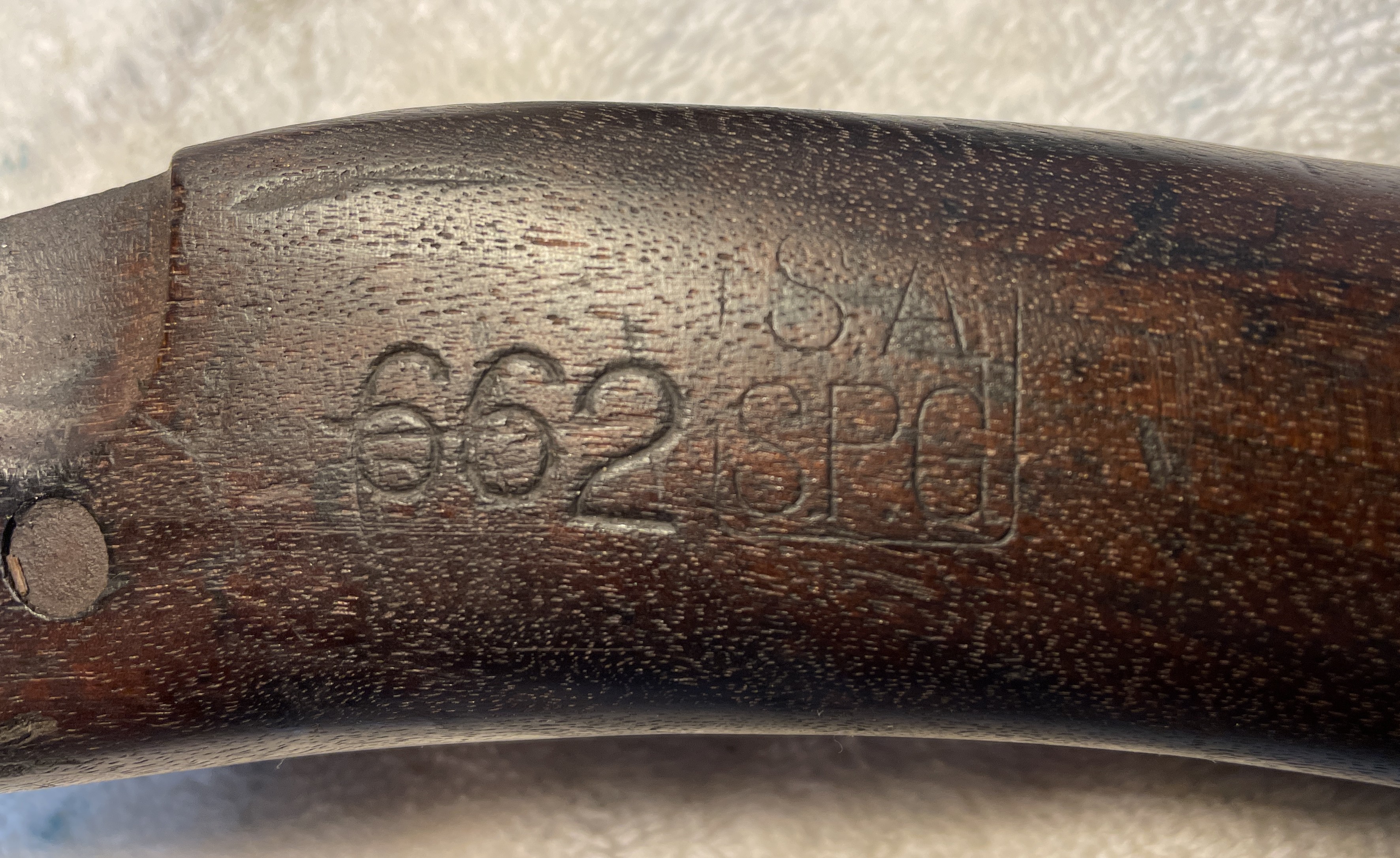

    Part 4 - Stock

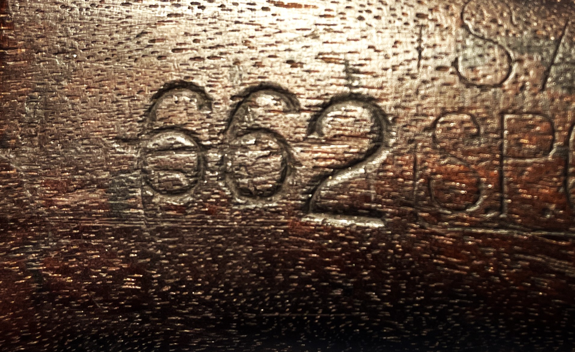

    The stock is an early straight stock, likely contemporary with the receiver. It carries what looks like an initial "D.A.L" stamp, a rack number, and finally a "SA-SPG" stamp from 1936 to 1940.
    There is a small mark on the tip that cannot be made out. Two screw stock. Consistent with 1917-1918 production.
    The handgrip feels very new. While it matches the main stock color well, it has not been worn smooth over time like the rest of the stock. It is a replacement from the original higher hump handguard at least near as I can tell.

    The serial number indicates 1917 manufacture. Someone here will check to see if it is on the SRS list. This looks to me like it may have been a VFW type rifle. It has a lot of finish wear and bore corrosion (possible blank firing). Others will be along shortly.
    Nov 2011
    Yesterday @ 10:02 PM
    790
    04-25-2025
    03:37 AM
    Should have mentioned how nice that stock is. I have a thing about those early stocks with crisp finger grooves and a dark aged finish.

    Another Data Point
    Checked head space, just for fun. I only have no-go and "go" for 30-06. The no-go gauge easily allowed the bolt to close, no problem. So yeah, maybe a blank shooter for someone. It goes with the barrel condtion.
