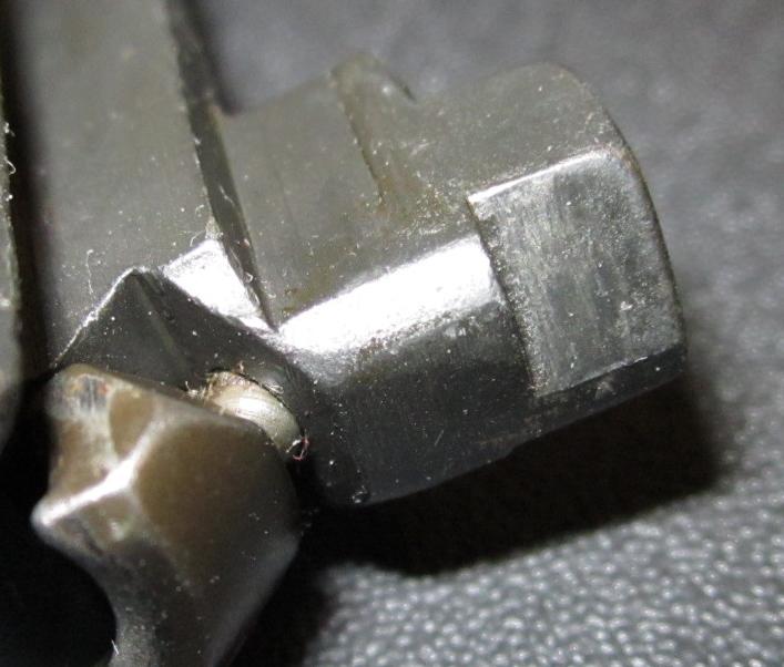

    Here's the bolt that I pulled from the rifle as purchased:
    Extractor shows more wear than the bolt.
    Bolt face has some tiny pits but they appear to have finish in them. No sign of having been fired since finish applied. Suspicious, that.
    Underside of bolt.
    More tiny pits scattered about. And two pin punch prick marks. ???
    Little to no finish wear on camming or locking surfaces. As the rest of the rifle shows at least some light rubbing, due to firing or at least repeated cycling, one would expect the same here!
    The bolt also has no old cosmolineicon.
    Guessing a relatively recent (20 years or less) swap by a previous owner to help headspace or something. Feeling more better about doing the changeout! The one spare Winchester bolt I installed seems rather more at home, and it won't close on a military no-go gage.
