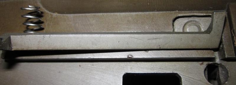

    Some excerpts from the P'bucket album so far:
    No "A" or "CM" on the clip latch, but it looks fairly more roughly milled than the usual Springfield unit.

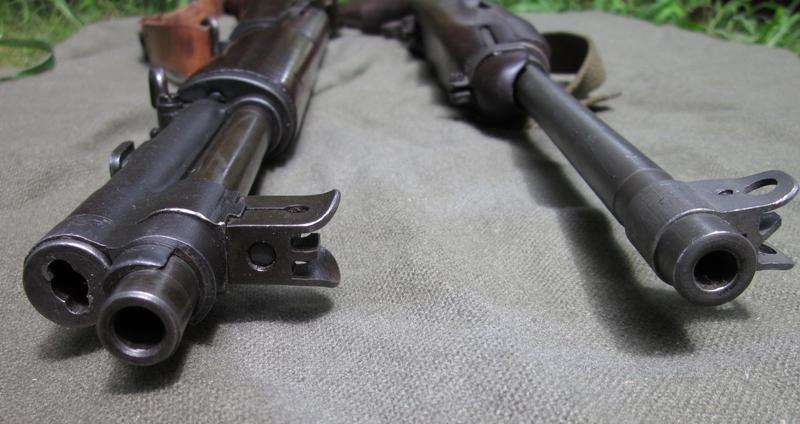

    Still thinking so, even after a brief "group photo shoot" with a friend's Winchester/Underwood M1icon Carbine:
    Note how grey the finish is about the heel. It's not finish wear so much as where the cosmoline's gone! Looks very close in appearance to the Carbine in person, not so much in the photos. Never would cloud up decently until it was about too late for good pictures.
    Good range session last Friday as well. Almost TOO good for what needs to be treated nicely.
    First time to shoot a rifle standing since February, what with the torn up shoulder and all.
    Was not displeased with the rifle at all, but the operator needs work.
