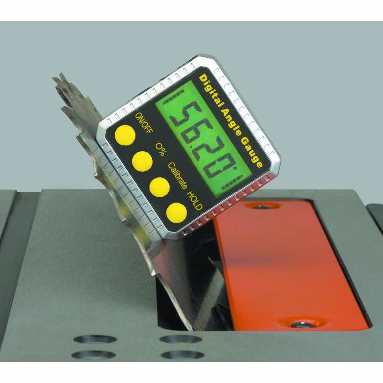

    Magnetic Angle finder
    Magnetic Angle finder guages. I purchased a set for multiple uses, like checking the angle on the table saw blade and the other on a Mitre saw. The 2 I bought are digital display and cost more but they all do the same thing. Being magnetic their nice to use on the carbine barrel flat and the flat on the receiver bottom. As long as they both read the same, you know your on the money. IMO much easier than using 2 straight edges or levels. Like most tools and gages you'll find more uses for them after you have em.
    Mine look like this, but cheaper than the link and a different maker.
    I've seen these on Ebay for 1/2 the cost and Home Depot carries versions.
    https://www.harborfreight.com/digita...uge-63615.html
    Here: Cheaper, Not Digital, but do the same thing, just read the scale. Both scales match- your parallel:
    https://www.harborfreight.com/dial-g...der-34214.html
    Really quick easy way to see if the barrel and receiver are parallel.
    I'll pick a digital up if there's one at my local Ace Hardware or Home Depot. I can see the utility of the tool for all manner of things, not just checking barrel-receiver alignment. Thanks for the heads up, GotSnlB28 & painter777!
