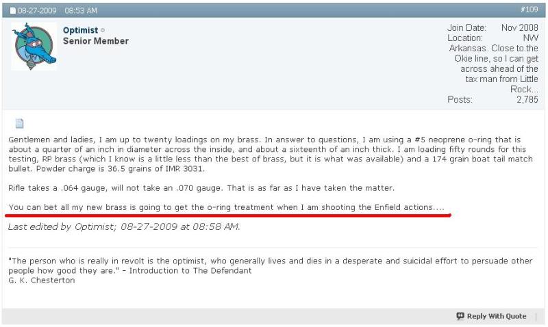

    I waited over five years after reading about the o-ring method of fire forming the .303 Britishicon and I wish I had started as soon as I had read about it. I have been reloading for over 40 years and the o-ring method just seemed a little too far out in left field until I tried it.
    Optimist over at Gunboards did a destruction test with new Remington cases after I posted the o-ring method of fire forming there. Optimist reached 32 case reloading number before the first case failure and had NO case head separations.
    Your o-ring size for fire forming will depend on the case base diameter and your headspace setting, I use three different sizes depending on the Enfield used.
    I even lapped a zero bolt head to give me a headspace setting of over .084 and used the o-ring method with no ill affects. I like having tight headspace but the o-ring method makes the word "headspace" meaningless (within reason) on the Enfield Rifleicon.
