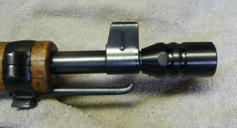

    *Forgot to mention.... Gunner, our Clamp On Muzzle Brakes don't affect accuracy at all, at least we've never had a report of that happening.
    They definitely reduce felt recoil by a bunch.
    The difference between the Clamp On and the Threaded Brake is that the Threaded Brake has a smaller diameter opening. Its perfectly concentric to the bore if the threading is done properly using the Bore Pilot, and the Clamp On depends on the OD of the barrel. Not all k31 barrels are exactly alike, so the opening of the Clamp On is slightly larger to prevent any uneven gas upset.

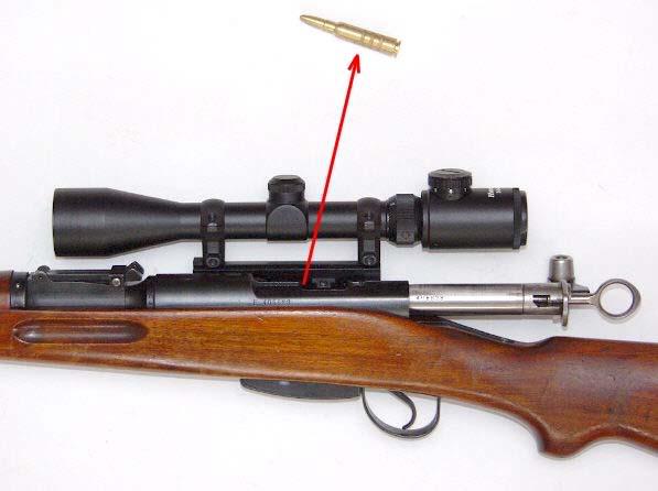

    I sold my harley yesterday and after cleaning up a credit car with a couple of M1icon Garands on it I will be seriously considering a k-31 from J&G. How does that scope mount ,is it made only for the K-31 and where would I get one and how much will it set me back?
    I would like to know sources for the scope mount parts. Also it was mentioned to Aline with bore and it seems the scope is off set.

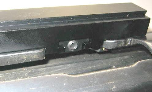

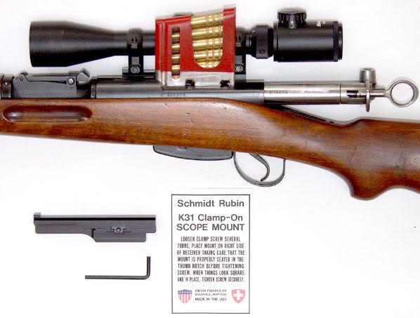

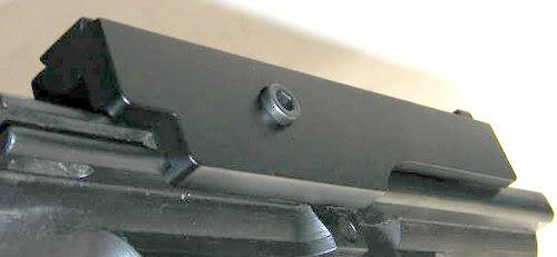

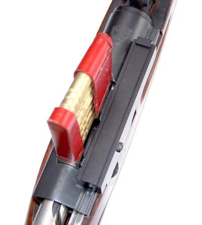

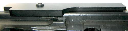

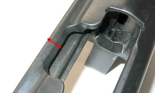

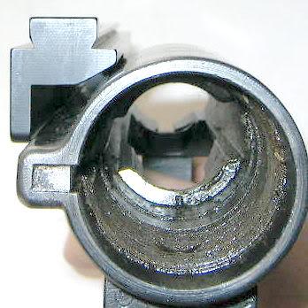

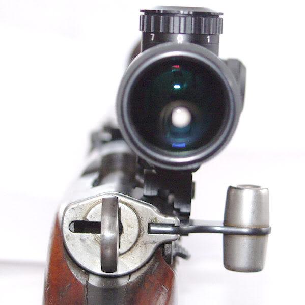

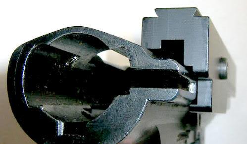

    First of all.......A clarification from our Distributor in the Netherlands
    It shows that it hardly touches the receiver so no worries for any bluing damage.
    Guisan.
    As for where to get it........ Swiss Products
    Scroll to the bottom for our US Distributors.
    Note that there is a Buttpad Adaptor shown on our website. It allows you to install a Pachmayer or similar without altering the buttstock at all.
    This is a link to the discussions about off-set mounts. Remember the M1icon-D Garand? No difference.
    Decent Scope Mount for K31 in Straight-Pull Rifles Forum
    Latigo

    Very nice thankyou latigo for the pictures and details (that look simple for even me) whether I go to that extent or just buy and shoot iron sights it is info i still enjoyed learning.

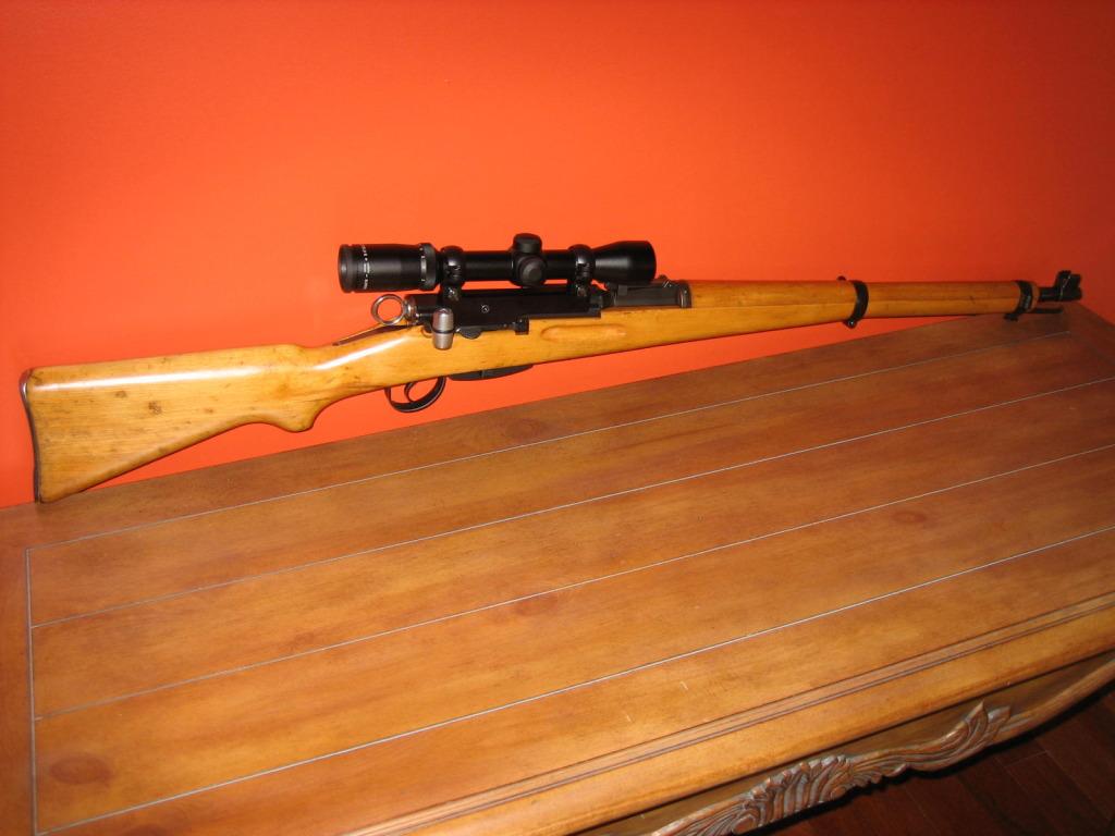

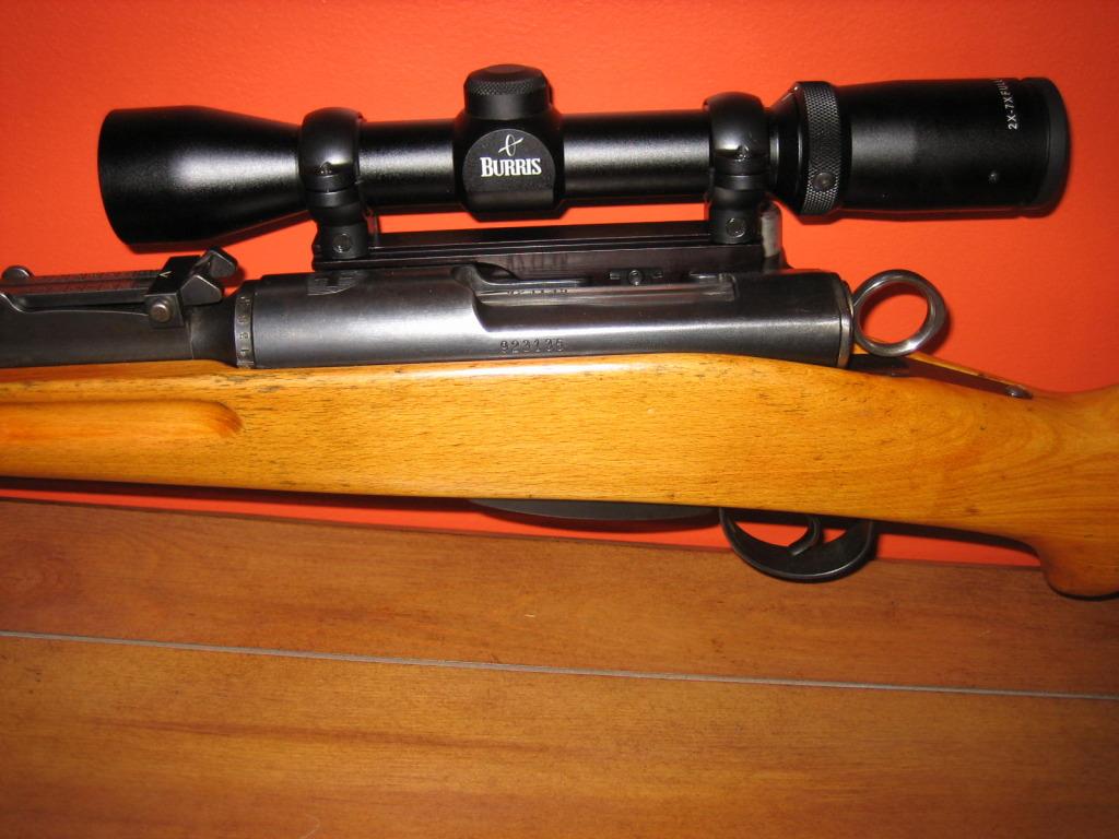

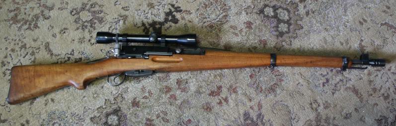

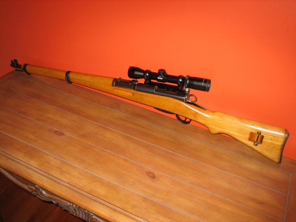

    Well, this is what I did: ($245 shipped scope rig)
    Scope: Burris 2-7X35mm Fullfield II
    Mount: Swissicon products clamp on
    Rings: Burris Signature Rimfire/11mm med height
    Irons still have 400m and it is pretty cool being able to "slide" over and have a nice magnified optic sight picture!

    Whoa! Beautiful!
