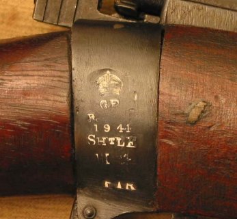

    To add to what Amatikuluicon said---the 1944 marked Dispersal rifles I have seen----three in person and three in photos---all seem to have been RE-manufactured rifles.
    That is, new Dispersal program markings added to partly scrubbed receivers and salvaged barrels renumbered to match.
    The wood has been new WW2 Beech---on three of the rifles, salvaged walnut on one, a 1953 FTR set on another and the last one unknown.
    If you have one of the '44s please try to post photos here, if you can.
    -----krinko

    BINGO!
    Thank you Krinko,
    The rifle markings you show in your photo are a carbon copy of the rifle I just purchased today (sans white marks of course). Pictures will have to follow next week since my wife absconded to Ft. Jackson, SC with my camera to attend my son's graduation from Basic Training.
    The stock has seen better days but is still seviceable. It is walnut with 4 diagonal repairs on the upper hand guard.
    The serial number is 8101J. Same number is on the nose cap, bottom of magazine and back of bolt handle, although the "J" only appears on the receiver. All the metal seems to have an excellent finish except the magazine and that seems a little worn.
