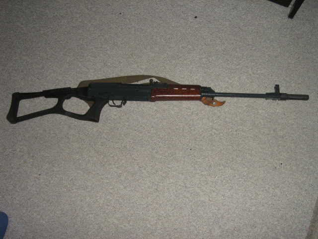

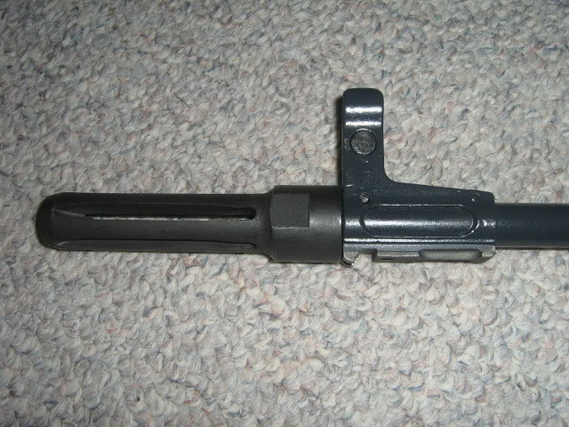

    Does anyone know the proper thread pitch for the CZ-858 rifle muzzle break?
    I am also looking for the thread pitch for the Canadianicon C6 flash hider. (Mag 58)
    Any help would be greatly appreciated.

    OK... CZ858 and VZ 58's are M14x1 RH.
    Anyone... CF armourers..... MAg 58 thread pitch for flash hider???????

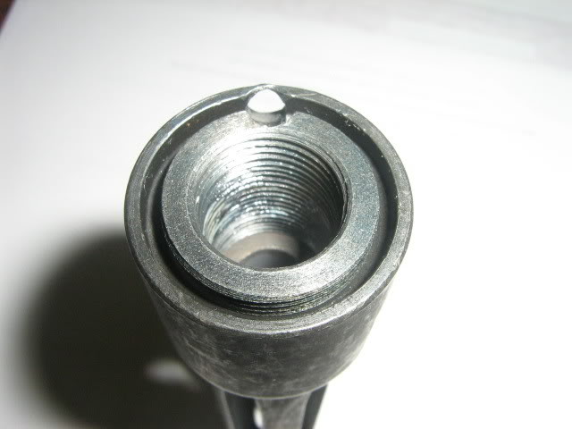

    Thanks gunasauras... here is what I found out...
    A buddy contacted FN Herstal-USA (FNH-USA) about the M240 GPMG threads and received this reply today.
    M240 Barrel thread pitch is English non-standard. The call out is (25/32) 0.7812-24 UNS-3A Special. So while the pitch is a standard 24 threads per inch, the diameter is non-standard.

    The term "Special" may mean that either the major diameter or the root diameter or both have been modified from what you might calculate for a normal 24 TPI thread.

    The obvious answer would be that the major diameter is non-standard, or am I missing something? Just about all non-metric firearms threads are "special", much to our consternation!

    Thats correct. Thread is standard 24 TPI but the diameter is 25/32"...
    Gotta love that European stuff.... I think they do that just so people dont mess with it

    I needed to make an adapter... it worked...
