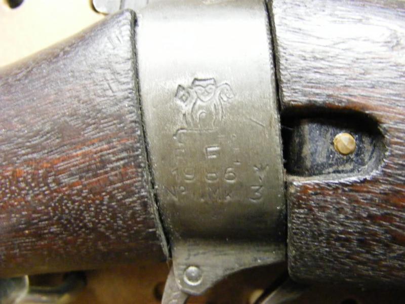

    Mmmmmmmm. I'd check the thickness of the butt socket wall thickness because 1986 seems very late. On some of the 7.62's, you can just faintly see the old markings where they've been linished clean.

    There are hundreds (thousands?) of these. All quite uniform and all quite uniformly crude. Still, the rifles are better than the nadir of Ishapore production---the 1963-65 SMLE.
    The last ones, dated 1988, include "floor sweepings" rifles----JB White got one of those----otherwise, they show no sign of being rebuilds.
