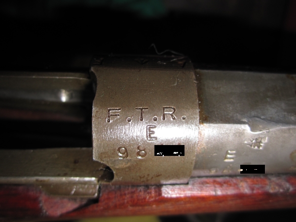

    I have a no1 MkIII* that's been in the family 40 or so years. Thanks to this site I have figured out a lot about it and where it was issued to.
    The barrel shank and receiver ring have been stamped by just about every one in government service it seems.
    It was issued to the Air Farce but I don'tr see any 'D' markings, is this the case with AF issued rifles?
    The dates I see on the rifle are:
    1942 - Manuf
    1943 - barrel (matching serial no )
    1948 - a proof mark? on the barrel
    1953 ( on the bolt head, no size numbering )
    1955 on the left hand side of the receiever.
    Are the number of different dates all over the place common ?
    It was FTRd at some stage, how do I tell where? I suspect Lithgowicon but would like to confirm
    Here is a pic of the area in question:
    thanks for any help.

    All the stamps visible in your photo would indicate Lithgowicon. If it was "formally" FTR'd at Lithgow, there would normally be an FTR stamped on the receiver ring, and MA55 (for example) stamped on the left side of the buttsocket, under the safety spring.

    Thanks Jrhead, it does indeed have MA 55 on the LHS of the buttsocket. There is a big F.T.R on the RHS of the receiver ring too.
    There are stamps of various sorts all over this thing, I only have 2 No4s to compare it too and they are fairly spartan compared to this.
