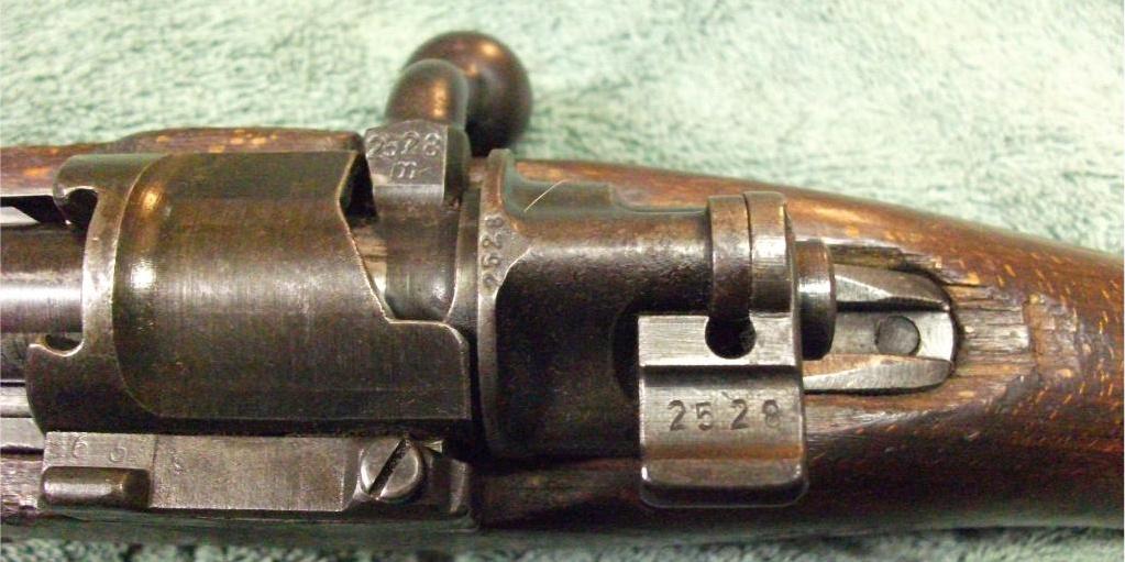

    Rescue from Bubbaland.
    Photo #1a
    #1b
    #1c Bolt group from another rifle. Bolt stop? Not sure but it LOOKS like "65".
    #1d Rear action screw has only one relief cut.
    #1e
    #1f
    #1g
    Trigger guard looks odd, but it doesn't "crash" the trigger. It IS a little bent on one side of the bottom of the bow, but otherwise??? Is this a variation to save a little metal on a milled guard, or am I just being hopeful?

    I don't know of any special trigger guard for the 98k. Yours is milled and when the 98ks all had milled trigger guards they were nicely made and usually serialled to the rifle. Later of course were the stamped guards. The VZ24 had a trigger guard that looked slightly squashed but not as bad as that one. The rear screw is definitly a replacement. I wish I could help more. The bnz with a period shows that the rifle was produced by Styer, the Radom rifles had no period after the bnz.

    I'm guessing both action screws are replacements, as they aren't rusty (brown) enough! Locking screws, too.
    What's odd is that there's no sign of the rifle having been apart since the front band "repair". So why bother putting in screws (which must have been ordered from some supplier of milsurp Mauser parts), and not get a retaining spring at the same time?
    ETA, Oh, I did note that the front of the trigger guard bows differ in the dimensions of the front reinforce, so, if there was one change, why not another. Also, it seems difficult to squash the guard to that profile whilst the rifle is assembled. Squashed in the front- that would be easy to just call damage, but this seemed purposeful.
    But I'm not a "Mauser guy"!

    There was a special trigger guard in WWII - the so-called "winter trigger guard" intended for shooters wearing gloves. But they are considerably larger in the loop, rather like John Wayne's LAR. This one is not a winter trigger guard. It is not larger at the front, but tighter at the back. So the odd shape may be a result of whatever happened to the donor rifle it came from.
    Front trigger guard screw looks original. Locking recesses are milled and the top is chamfered, showing clear space to the recess in the trigger guard. Rear trigger guard screw is a DIY effort, not any original product. Simply compare with the front screw and note the lack of chamfer, poor slot, and I suspect that if you remove it the locking recess has been filed out by Bubba.

    The guard S/N matches the rest, roughly, as this rifle seems to have been assembled in poor lighting conditions- aside from the bolt, and maybe the bolt stop, they numbers are all 6968, 6969, 68, or 69. I think the guard was made in this odd shape still, not that it means much to me.
    More photos coming.
    If the rear action screw is wrong, then the front is too. They look to have been made on the same tooling and are equally crude, except the front has all three lock screw recesses. But I'll try some detail photos for your examination.
