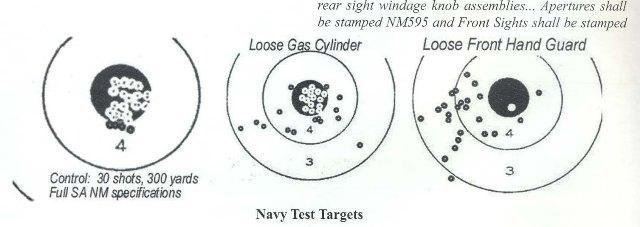

    Unfortunatly it shoots bad, the group is large and spread from 7 to 8 hour like it is in the image posted on the web-site I linked. Same result as the right side image, not at 300 but at 110 Yards only.

    If you hand guard is to tight then it will string the shots. The front hand guard should not be tight as it will bow the barrel as it heats up if you use the Gas cylinder to tighten it in place. If you screw it to the lower band to stop movement you will not be allowed to use it in some Garandicon matches.

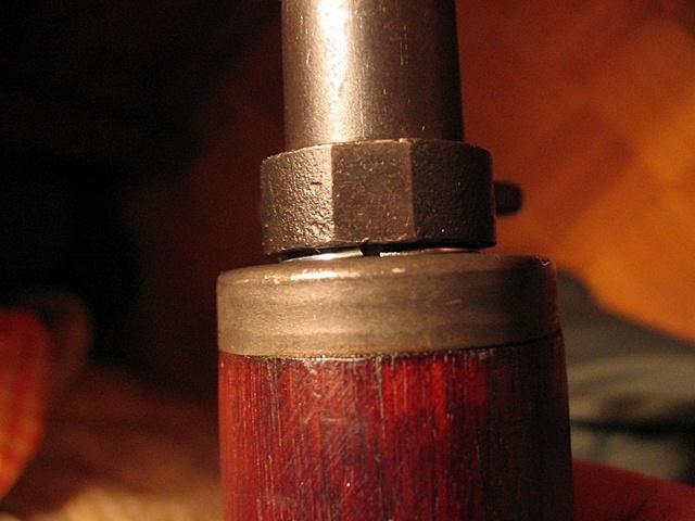

    I got a suggestion from an Italianicon friend who is in touch with some M1 Garand shooters in USA : This should be a quick and dirty solution, get a paper clip and cut a piece long same as the barrel circumference and insert it between gas cilynder and front handguard.

    Here it it, now the handguard seems almost fixed

    Nice if that springs back and forth like it looks. If you post a picture of the markings I can verify it for you. Thanks,, Rick Bicon

    Actually it is just a piece of paper clip, not really a spring.

    Rick Bicon is correct, those target photos are mine from an old GCAicon article I wrote on NMs. A credit to the GCA Journal would have been nice.
