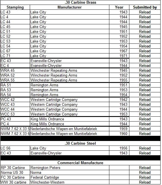

    BTW, someone on another forum asked if I would research these, find every known headstamp, and add them to the list I posted. Short answer, no. It'd take too much time.
    However, I would be happy to update and maintain the list with input from others. In order to do that, I'd want to see a pic of the cartridge like USGI posted. In other words, no heresay. I wouldn't list anything that wasn't proven. The list would have a column for username/forum of the submitter. If anyone is interested in adding to the list, let me know. Here's my most recent update:
