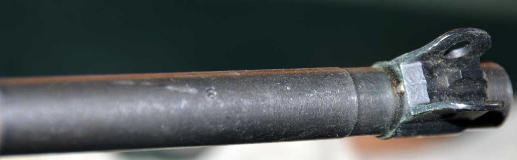

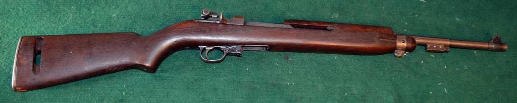

    Local gun shop had this for $850. I was looking for a shooter and liked the feel of this one.
    S/N 1,240,XXX
    Please post any comments on the gun, history or markings. The history is as much fun as shooting.

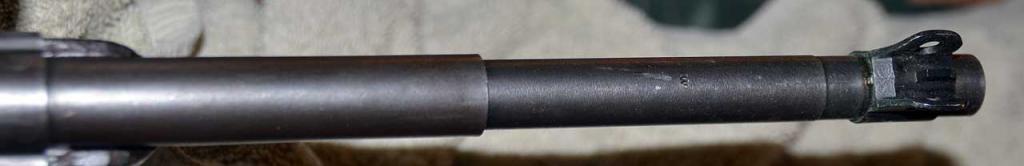

    Can't make out what this says? Barrel made in Knoxville, Tenn?

    Even with it being import maked, seeing some of those markings and the hammer, I think that was a very good price.
    Now clean the lint out of the barrel.

    First, good job with your pictures. You have an early Winchester with the typical post war barrel band and rear sight changes. It is a Bavarian return imported by INTRAC near where I am in Tennessee. If real, you have an early dogleg hammer that was usually replaced when the carbine was rebuilt if not sooner. The stock is an Inland low wood. I don't see a mark on the hand guard, but that doesn't mean it's not there. The bottom of the trigger guard has the number stamped into it showing what unit used it. Overall you have a nice gun with an interesting history.

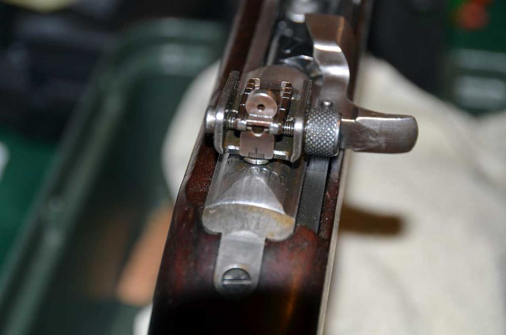

    Thanks, here are a few more shots of the hammer and a few other markings I missed in the first post.
    Was the dogleg hammer a bad thing?
    Winchester proof - oval with PW logo
    Quality Hardware Bayonet lug

    Nothing wrong with a dogleg hammer. It is much more valuable. The hammer change was made primarily to improve the trigger pull on the carbine, but it is functionally fine.

    I can't tell if that's oil or two hammer marks on the housing?

    Looks like 2 hammer strikes to me... Straight and Dogleg.
    Wonder when the Dogleg would have been put back in? Nice to have though. Even looks like it might have the 22 coil spring with it.

    Pictures of the hand guard below, no markings I can see other than a single vertical line in the area you describe.
    Is there a way to clean the stock without removing its character? This things is sticky.
    Also, any pluses or minuses to replacing this stock with an original Winchester Stock? I had all correct parts on my old rifle. Not looking to sell, just enjoy hunting down the parts.
    What does the 2 hammer strikes mean?

    If you look along the upper right rail of the triggerguard at where the front of the block part of the hammer strikes it , you'll see a small patch of displaced metal. This is normal . The two hammer styles leave marks in slightly different locations. If the guard in question has both marks , it has had both styles of hammers in it at different times. If it left the factory with the dogleg ( one mark ) and was changed to straight ( 2nd mark ) but now has a dogleg back in , it means the dogleg is not original but rather an attempt at restoration.

    Your HandGuard is a first style WRA with the Bullnose profile, many had no marking.
    Stock cleaning:
    Many different methods, I'm sure others will chime in. I use Mineral spirits.
    Correct Stock:
    With your serial# being 1,240,xxx you'd need a Oval shaped oiler slot with Hi-wood right rail. Called a Type II stock. Marking would be un-boxed letters W.R.A over G.H.D. with a crossed cannons cartouche next to it. Slingwell would have a small w stamp. Possible circled P proof on the bottom of the pistol grip.
    Real Type II WRA stocks are pricey. Be very aware of fakes.
    If me.... I'd make no changes.
    2 hammer strikes:
    Your trigger housing shows 2 types of hammer strikes.
    Meaning at one time that housing had a straight hammer in it, now back to the earlier type I Dogleg hammer.
