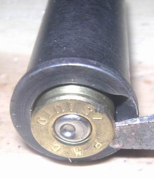

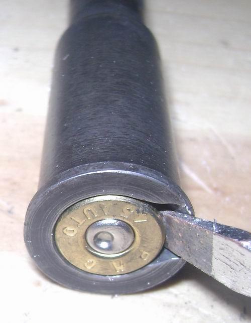

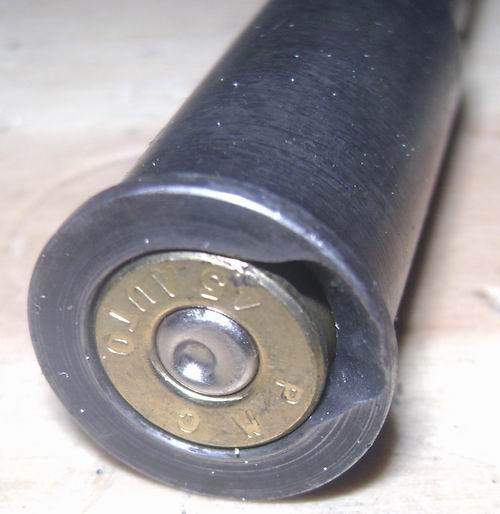

    if you are going to use it long term remove the extractor. I make my inserts with a screwdriver slot at the rim of the sub chamber so a small screwdriver can be used for extraction of the fired case. this way the insert can stay in the chamber. its also quicker and easier to use

    here is some pictures of my 45acp to 577/450 adapter showing the screwdriver extractor method

    Is that an adaptor you purchased commercially, or one you made yourself? Either way it looks very handy!

    its one I made. I copied a fired case to get the profile. I only made it because I had 500 rounds of 45acp reloads that were too hot for my pistol.
    I had made one to fire 32-20 from a 303 but it vanished
