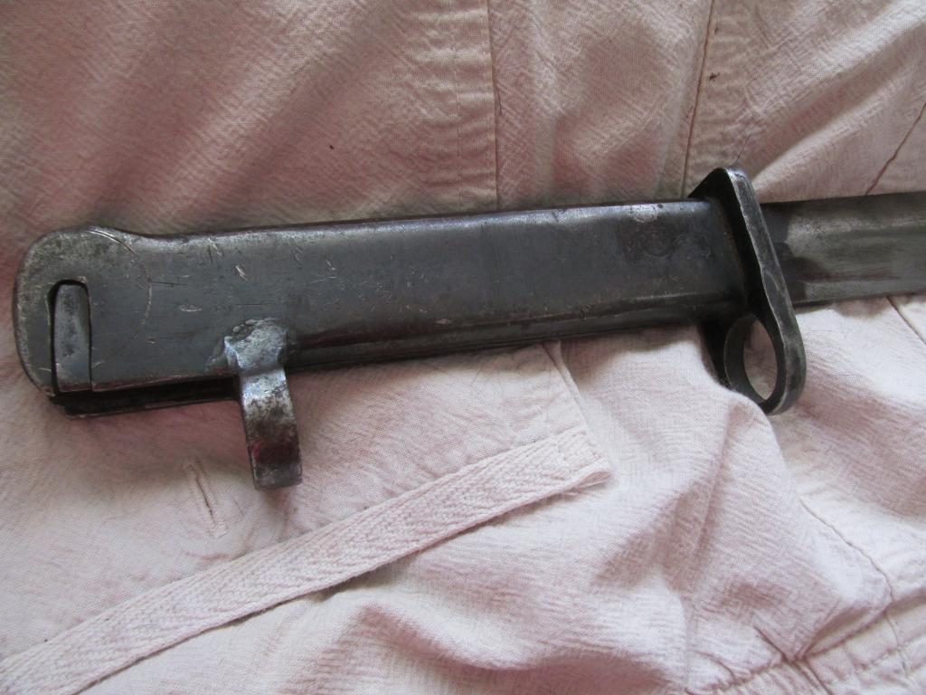

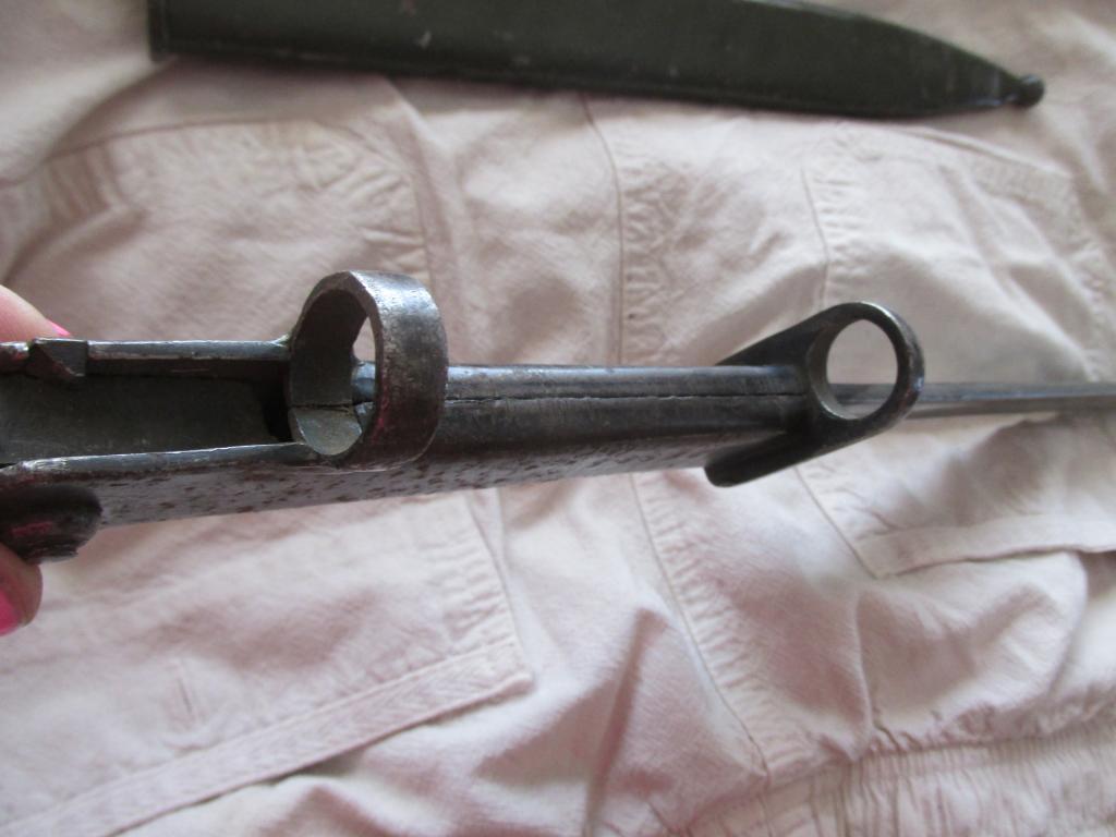

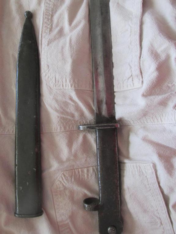

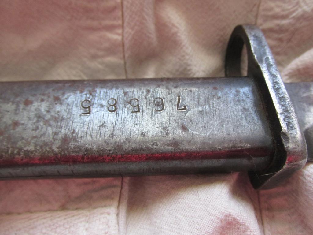

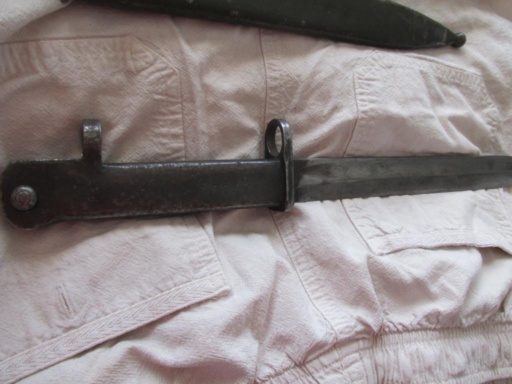

    Hi guys i found this crazy bayonet at an estate sale mixed in trunk i bought. Bayonet has no name or malleings execpt for a set of numbers on left grip pannel. 76585. blade is 9 1/2 inches long. handel is 5 1/2 inches long.metal slab sides formed an seamed on top. metal scabard woth ball tip. od green paint on scabard. fits scabead very well. was found with a mountain sleeping bag dated 1944, an full box of WAF chevorns un issused set of 100 pairs. not sure if that would help. i looked at every book i own an not any luck for a bayonet with 2 barrel bands
    thanks mike http://i91.photobucket.com/albums/k2...psf92ed479.jpg

    That is a Turkishicon (Ersatz) bayonet for the FN FAL rifle. Turkey - G1 (FAL) Bayonet

    Considering time and space, such a crude bayonet for such an advanced weapon.
    In the early 1960s, Turkeyicon received Belgian-made FN FAL (G1) rifles from Germanyicon, who had procured 100,000 from FN, but then changed to the G3 rifle after FN refused to allow Germany to produce the Belgian-made FN FAL (G1) under license.
    The Germans did not issue a bayonet with the Belgian-made FN FAL (G1) , so Turkey decided to add a bayonet lug to the G1 barrel and produced this makeshift knife bayonet.
    Crudely constructed of a new made pressed steel hilt mated with a recycled blade from an earlier Mauser bayonet. Several variations in blade, crosspiece, and muzzle ring have been observed. The scabbard is recycled from an earlier Mauser bayonet.
    Source: FN-FAL Bayonets - Other FN-FAL Bayonets
    I was confused as it was labelled as 'came from RMP* Cyprus' (* Royal Military Police) but no other paperwork.
    Maybe it was captured from the Turks during the invasion of Cyprus.
