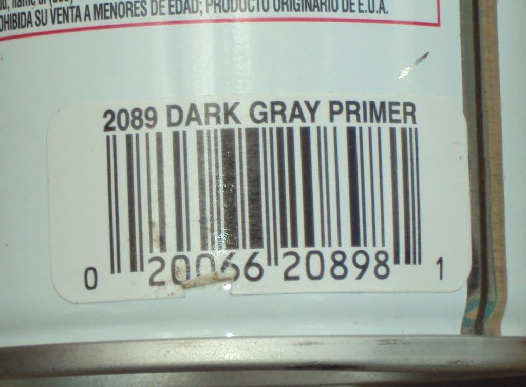

    If your upper is an earlier Colt XM Grey, clean your lower with acetone, warm slightly, then spray several light coats of Rustoleum grey auto primer. Dead on match, and if you let oit cure for a week in a warm house, then coat with CLP. it is pretty tough finish.
