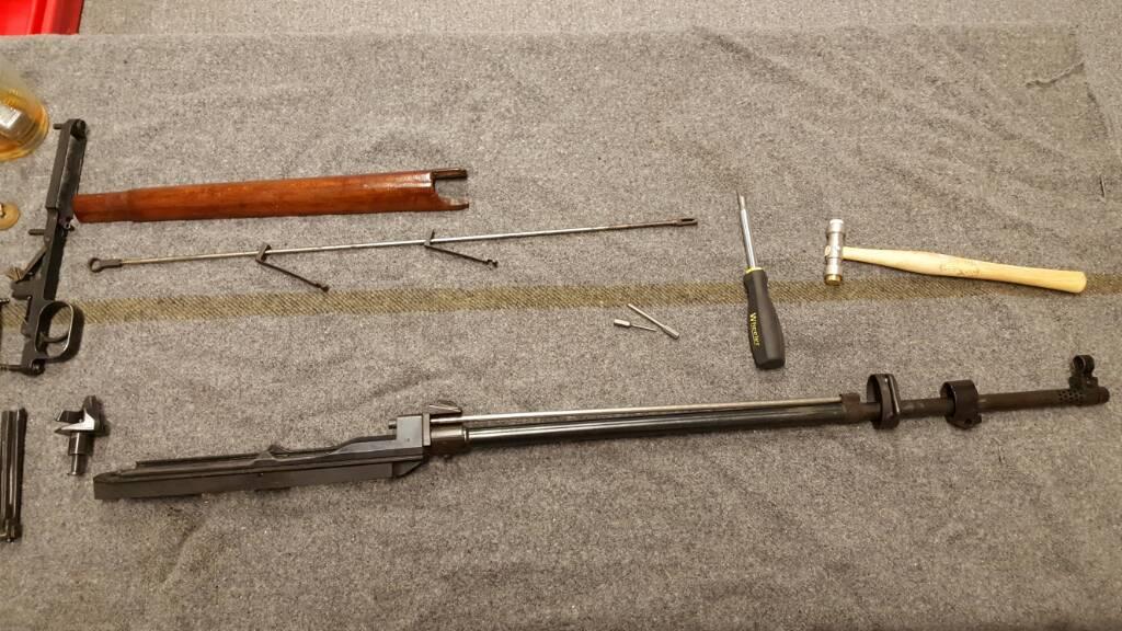

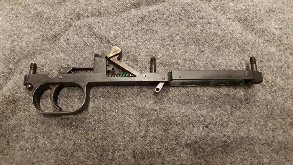

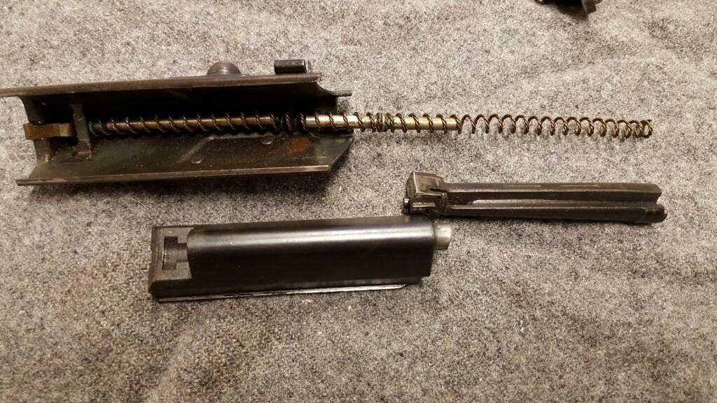

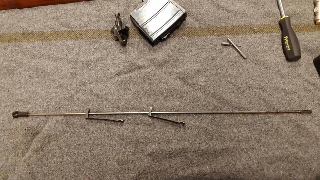

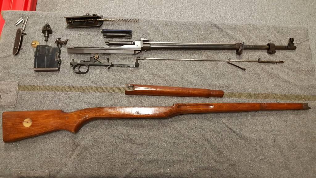

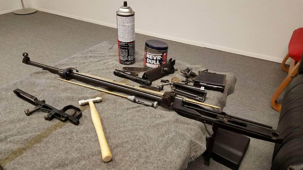

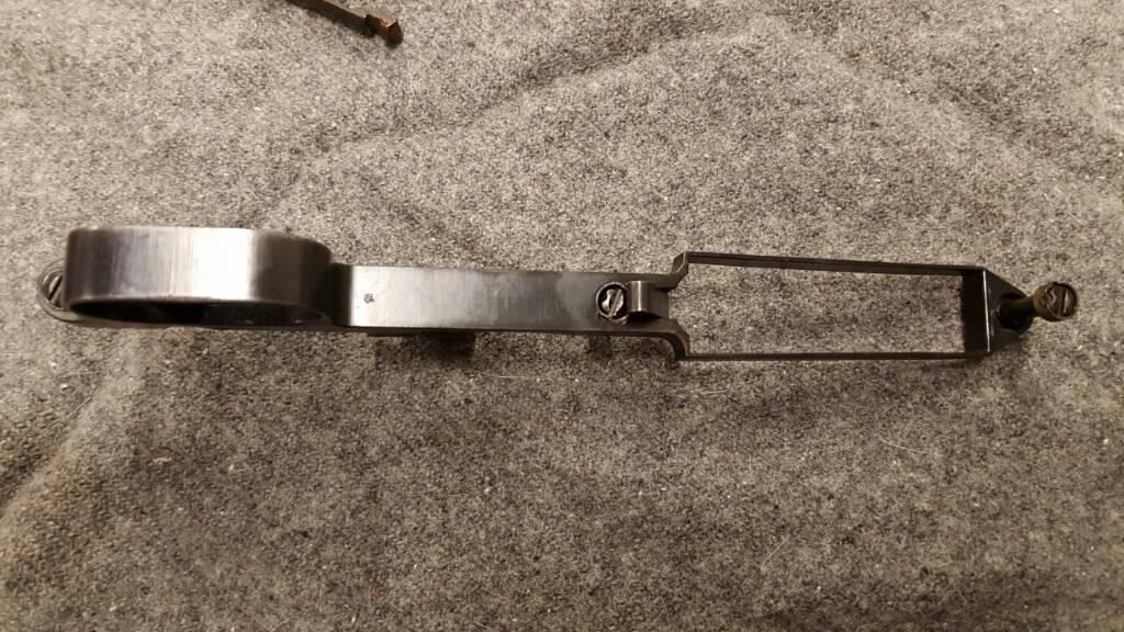

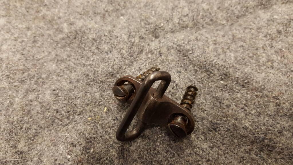

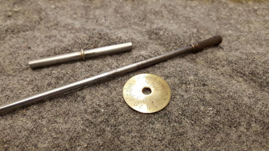

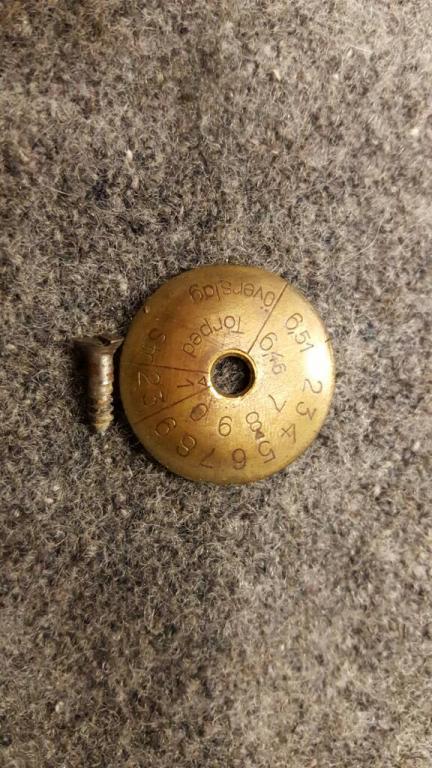

    This will be a series of photos that will show teardown and cleaning. This rifle has not been stripped or properly cleaned in at least 15 years since I have had it.
    In fact I have only put 30 rounds through it since I have owned it, and only had the bore pulled through afterwards.
    Sent from my SM-G920W8 using Tapatalk

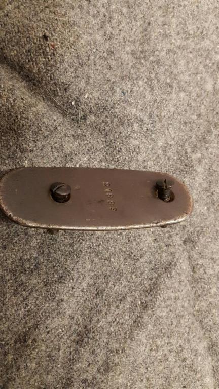

    The following are some details of of the varnished stock.

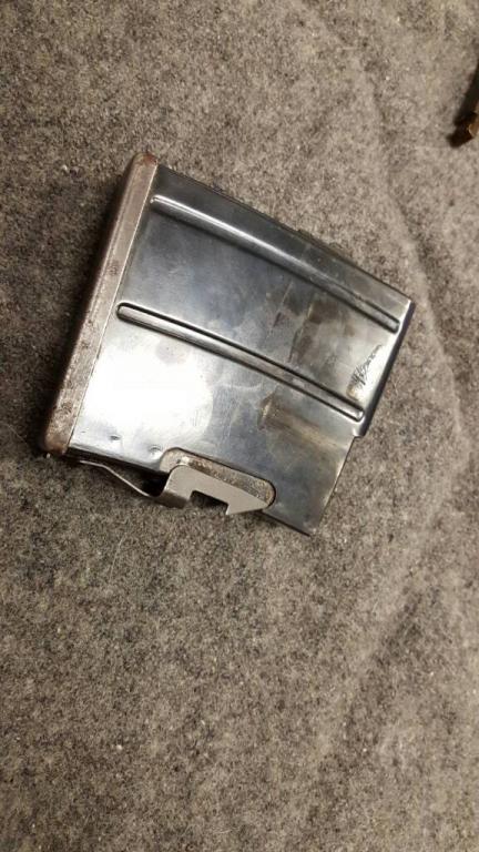

    Don't misplace the mag, they're extremely hard to find in these parts.

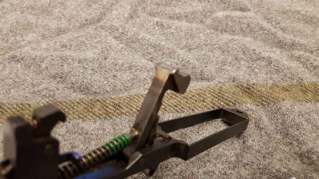

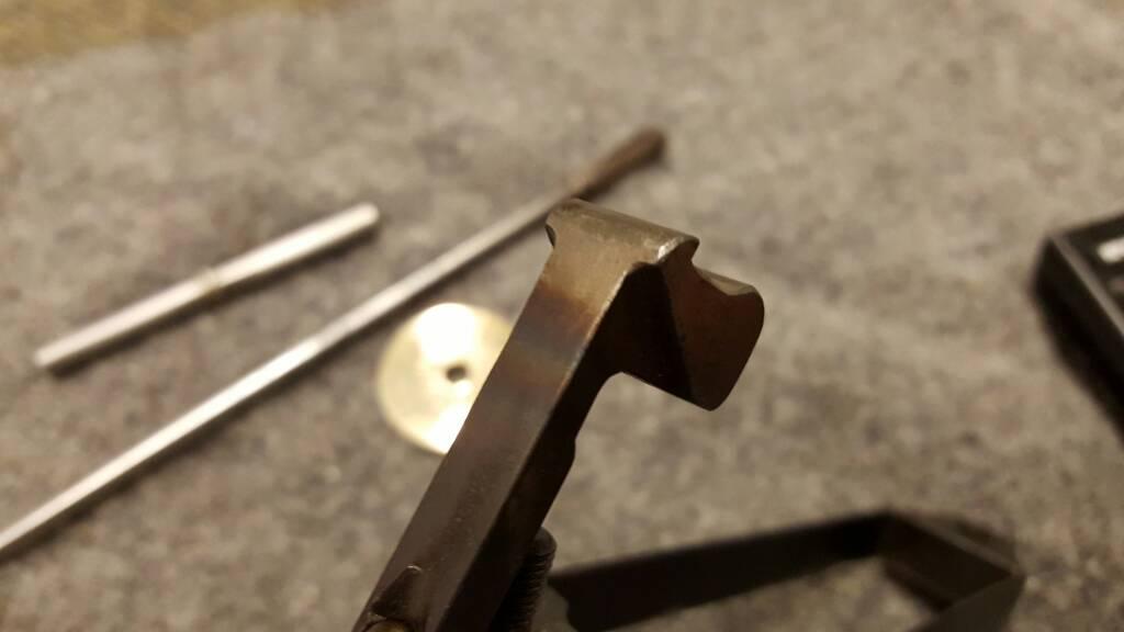

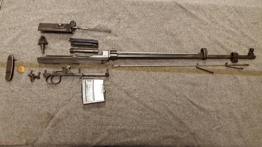

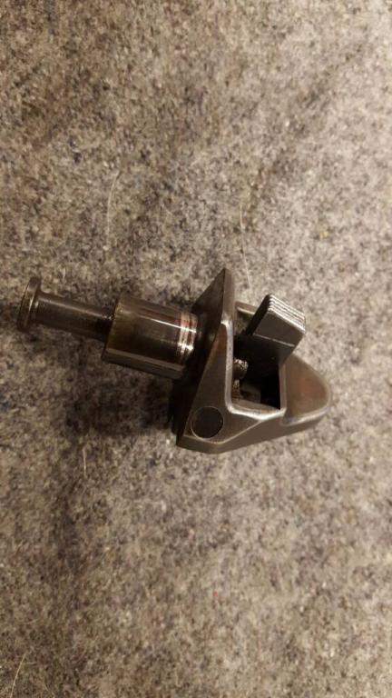

    Polishing some of the shiny bits and details of the heat treatment to the hammer.
    I even found the original sling in a box of firearms parts I had.
    It was fairly dry so I greased it with some Dubbin.
    All of the parts cleaned, oiled and waiting for the stock to be done.
    - Darren

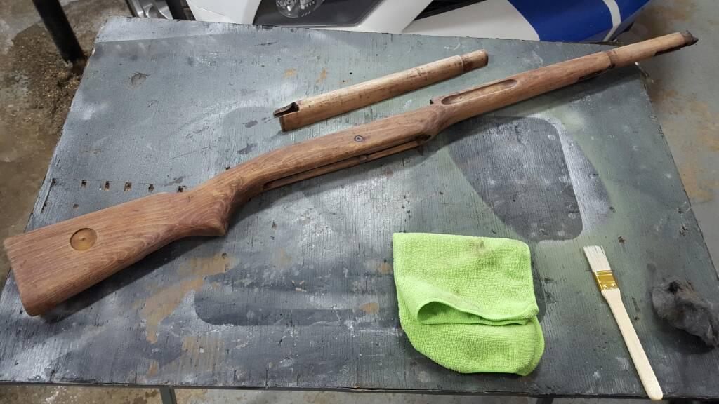

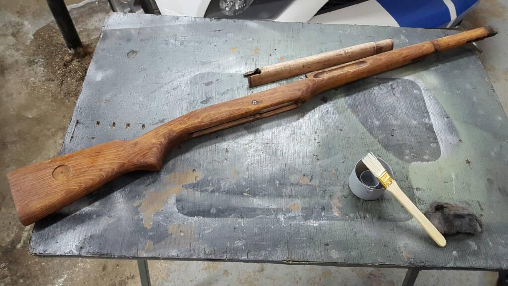

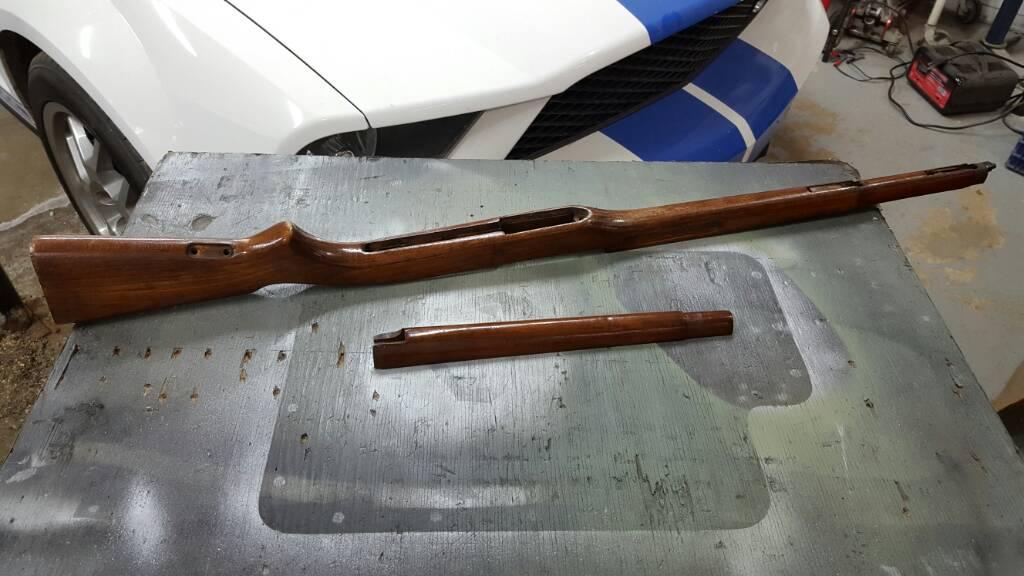

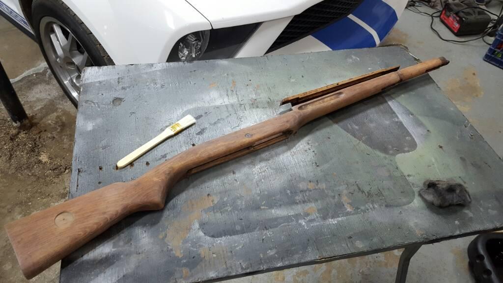

    Work on the stock was stubborn, the varnish and stain took a number applications of stripper to soften and scrub with 0000 steel wool.
    Household bleach was used to lighten the wood to help wash out the wood stain.
    Rising with methyl alcohol dried the stock rapidly.
    The first coat of BLOicon rubbed in and setting up.
    - Darren
    Dec 2015
    02-07-2022 @ 11:09 AM
    Edmonton, AB, Canada
    1,057
    Darren
    05-11-2025
    12:35 AM

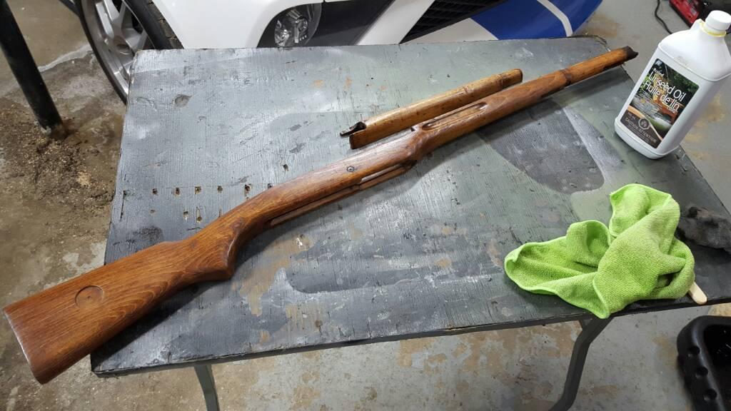

    As expected the stock was very thirsty soaking up a a large amount of oil.
    First it was applied with a lint free cloth in several light coats and allowed to dry.
    Lastly it was brushed over with a heavy full coat paying special attention to the interior channels grooves and nooks. This wet coat was allowed to rest for 30 minutes then wiped clean.
    After a suitable drying period the finish was hand buffed until a light sheen developed.
    Reassembly was smooth and the finished product is below:
    - Darren
    I have heard that, I have also seen these rifles for sale without the magazine on a few occasions, chuckled to myself and thought "best of luck!"
