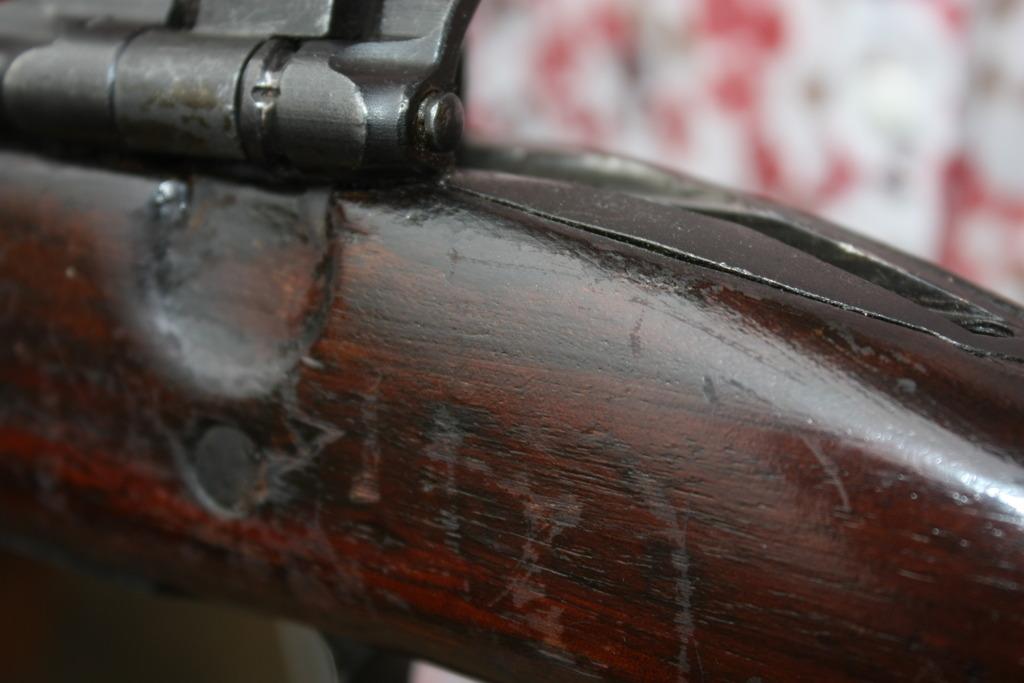

    Hi There!
    I am a Militaria collector from the UKicon who focuses on the Pacific Theatre of operations during WW2.
    I'm trying to identify if the Stock fitted to my Remington M1903 S/N 3194470 (August 1942) is a replacement or not.
    It has no inspection or ordinance stamps to the left side , which is where you would normally find them.
    It does have a "P" Proof mark behind the trigger (Although very faded , only just visible in the right light) along with the following marking which i have been unable to identify.
    It looks like a tiny Hourglass.
    Does anyone have any idea what this mark means?
    Thanks!

    I will get some better pictures up as soon as i can. (although you won't see much , there aren't any well pronounced markings except for this one)
    In the meantime , does anyone know what this little symbol is?
    It is also worth having a look at this picture
    You can see the faint outline of the "P" Proof mark much better here , along with said Hourglass

    Thank you for the excellent reply Rick.
    Looking at your pictures and then looking at my Rifle makes me think that this is indeed a 1903 Stock.
    I can't see the little grooves that you mention.
    I have taken some pictures of stock where the markings are usually found.
    Nothing much to see here , just many scratches. (no stamp under the Magazine cut off switch either )
    If you look closely here , you can see a rectangular outline of what may have been a stamp once.
    Nothing on the other end of the magazine plate either
    Nothing on the Other side either

    the marking you have in question is called a gallery marking, common on Remingtons, i also see a faint RLB, likely the original stock.

    Thanks for the input everyone.
    Its looking like this stock may be the original (or at least an actual M1903 replacement stock) just a rather beaten up example.
    Could you go into more detail on where you think you see the faint RLB? is it in the rectangle i mentioned? I can't see what you are referring to
