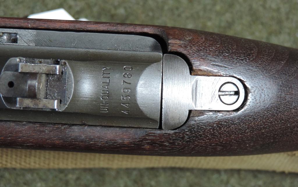

    What do you guys feel the current market is for an UN-Quality? A buddy of mine has one for sale (among several other carbines) but I am having a hard time gauging what they go for.
    http://www.jfcollectables.com/carbin...9780/home.html

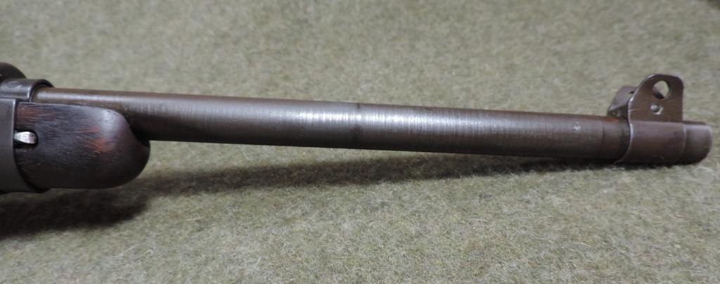

    I'm also curious if anyone can help me understand the scenario in which the finish difference between the barrel and receiver on this Winchester would have occurred; just looks kind of odd.
    http://www.jfcollectables.com/carbin...8432/home.html

    Lots of Winchester barrels were blued. Some Inland barrels too.

    I see. I just haven't been able to see any other examples that had this kind of two-tone look. Just a matter of which barrel was pulled at the time of assembly I guess.

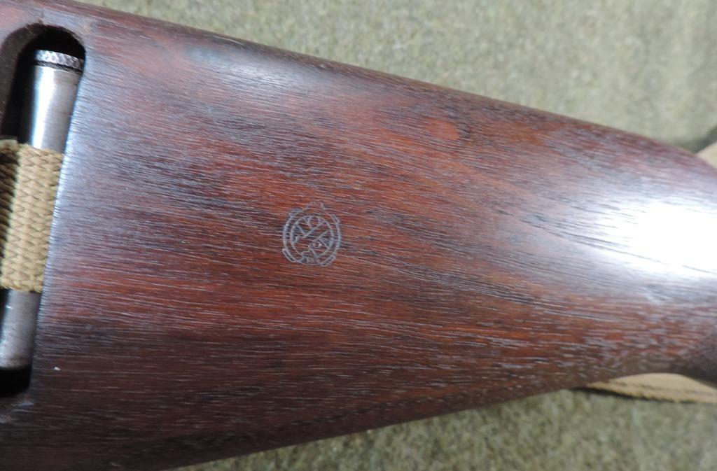

    Take in to account the Crossed Cannons Cartouche is a Reproduction.

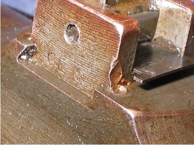

    This receiver has the punch style staking marks associated with adj rear sights.

    Very early QHMC carbines were found with the rear flip sight 'round staked', like the pictured example below.
    I don't believe this is the same case as the UN-Q in this thread, because of the location and angle of the Punch staking.
    https://www.milsurps.com/showthread....309#post245309

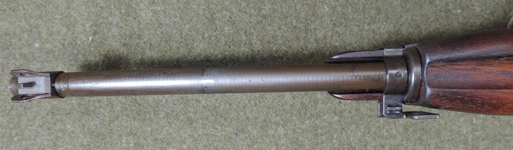

    I'll do a quick look over of the first carbine he has listed on GB, the NPM. No link included as you know how to find it.
    The barrel on it was indeed used by NPM as it shows the NPM Proof Punch Mark near the barrel makers P proof stamp.
    But, At one time this barrel had a Type III Bayonet Style barrel band on it.
    The pictures show the wear spots left by the inner pads of a bayo band, along with the circle mark left from the front end of that style band. A better picture of the front sight's pin would likely show it has been R and R'd.
    I don't know how to put magnified pics on here. If you can MAG these pics up to see the Punch Stake marks from it having a rear adj sight on it at one time.... before this flip was installed.

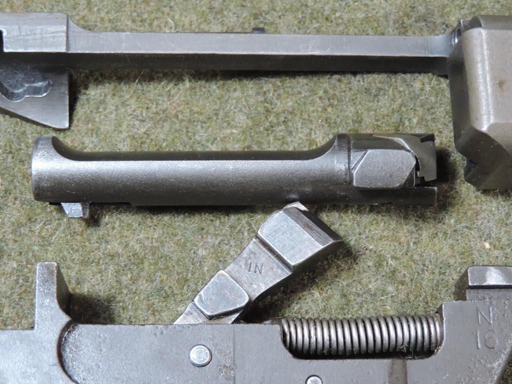

    Tell your buddy a IN or NI hammer was made/marked for Inland, He needs a HN marked hammer. And while talking hammers, tell him the hammer pin go in from LEFT TO RIGHT.
    I do not recall ever seeing a recoil plate fit a Trimble TN stock like this. Fit looks much more like the IR made replacement stocks, but I do not believe they (IR) made a Hi-wood.
