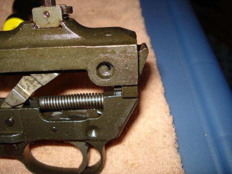

    look for the NARROW RECEIVER LOCKING TANG and the Tooling Hole on the left rear of your receiver. These if as pictured below, should mean production at Grand Rapids.. (S'G'/IP)
