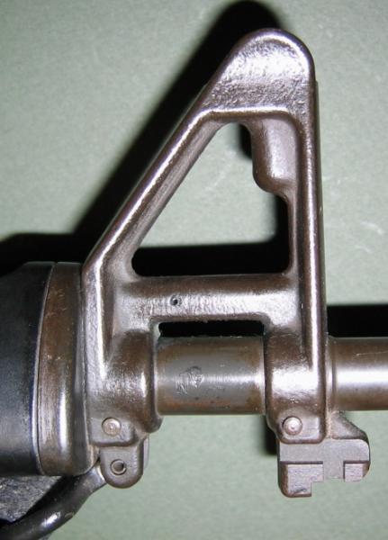

    Early front sight base and AR15/M16 tool
    The early front sight base was still used on some three digit Colt SP1 rifles

    Is this an early front sight base, and what is the difference?

    Quote Originally Posted by Johnny Peppers View Post
    Early ones will be cast. with a 1-14 between fron sight legs (601) VP 12 for a late 601 or early 602.
    No drain hole in the front sight for starters. Forged, Front & Rear of FSB will be machined. Proof will be M VP with 12 towards end of Barrel. The one pictured is forged. Circa 1964-1966.
    I have seen the early "flat" front sight base with the UP in raised letters on a Colt SP1 in the 007xx serial number range. Barrel is stamped M with the Colt triangle under the front sight base also stamped 12 near the front on the bottom. This rifle is "new" and was purchased by a collector in KC years ago.
    Could Colt have changed the front sight base during the early SP1 production?
