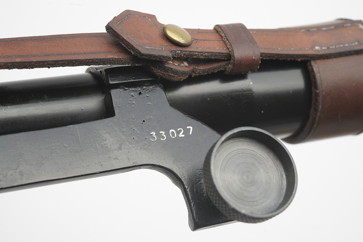

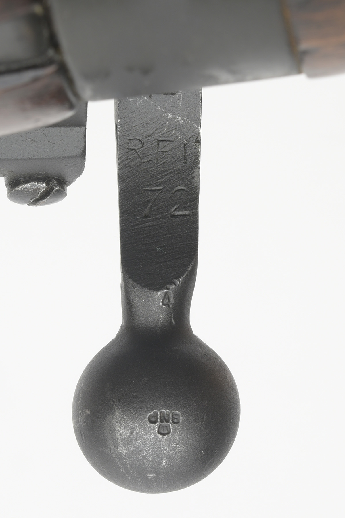

    Looking at the plethora of photographs added since first listed, I see that the bolt has "RFI 72" stamped under the handle and one of the scope mount knurled knob looks very unused. Even the auctioneer mentions that the scope bracket is a possible later replacement. Hard to see in the only close up photo but might it be one of DRPs excellent brackets?

    Well spotted DD! It is one of mine....................the bracket, I mean. The photo of the bolt body also confirms my suspicions of earlier about it being a replacement.
