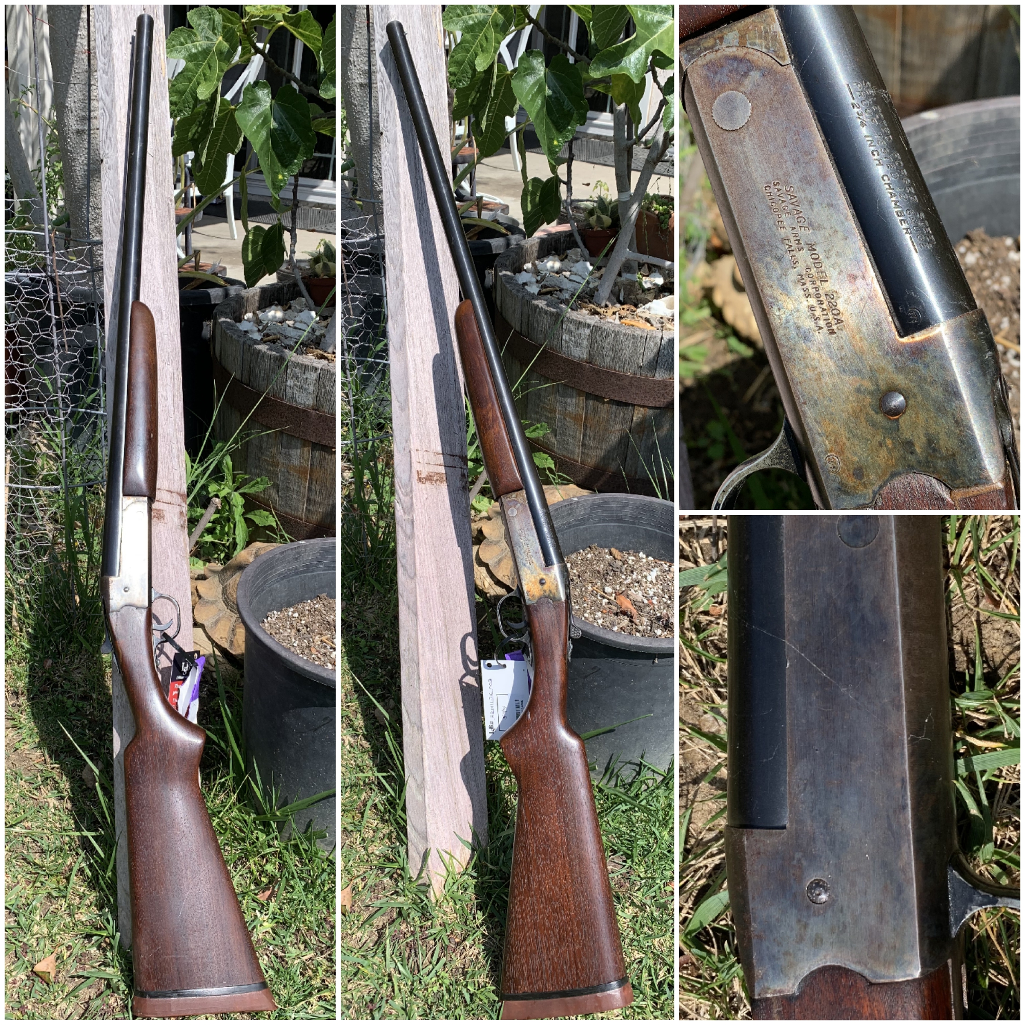

    Howdy Fellas,
    So here is something I have not performed yet, dealing with color case hardening finishes and their' preservation.
    I picked up a Savage Model 220A 12 Ga Shotgun at auction, actually forgot that I had put a lowball bid on it, and then got notice that I won. Anyhow, she's in need of a bit of care. As you can see from the picture it has some surface oxidation, mostly on the receiver.
    So my question has to do with boiling. Most time I boil and card the oxidation when I do my preservations, but I have never done it with a firearm that has a color case hardening finish. While I figure the areas that are oxidized will lose the color, will the boil and subsequent carding remove the color case hardening finish on the sections NOT oxidized?
    Thanks in advance!
    Bill

    I think you'll lose case colors wherever you card.

    Jim is correct. The oxidation that creates those swirls is very delicate. Boiling would most likely greatly diminish if not remove what is left of it, carding would erase any trace it was ever there. Most new factory color-cased finishes will add a clear coat over top to protect them (e.g. uberti reproductions). If you want them to last, keep solvents away, and keep the surface protected. Oxygen will slowly degrade it and make the colors less vibrant over time.

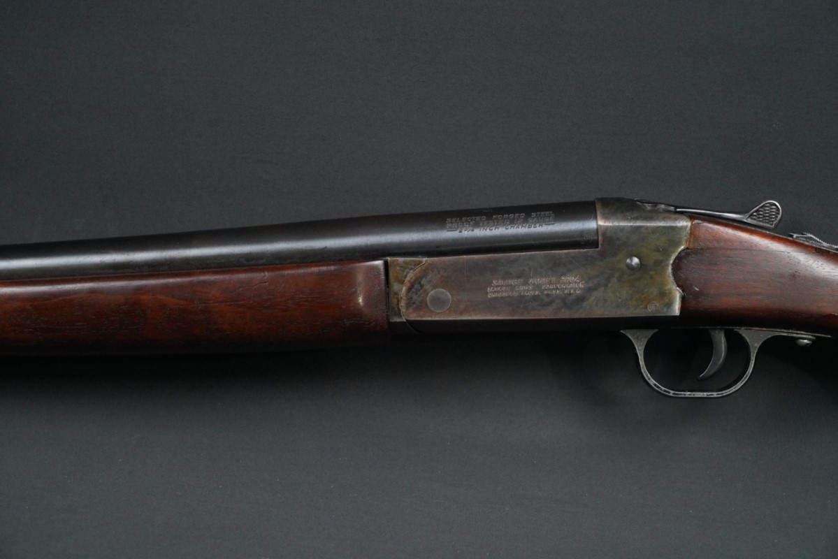

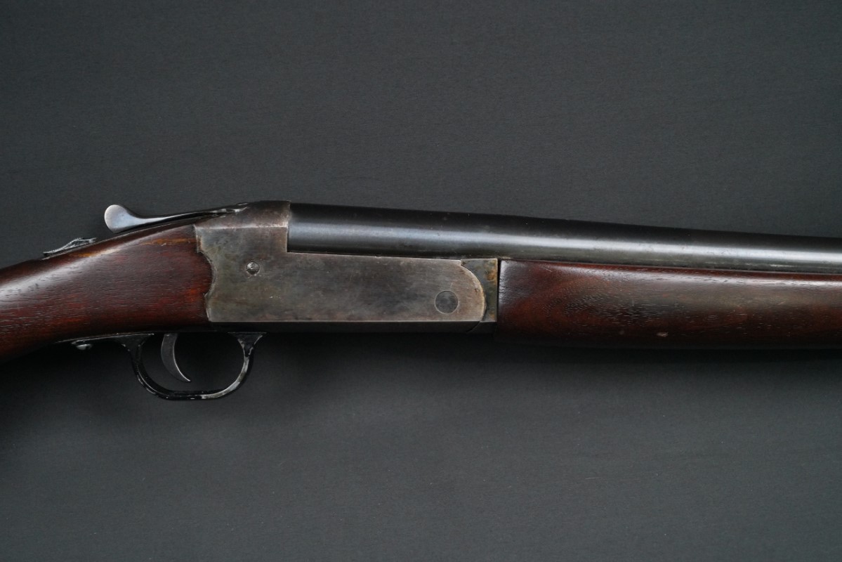

    case color finish
    There are still gunsmiths around restoring early cartridge firearms such as the first generation Colt single action (much in demand) that do their own case hardening. i saw the work of a gunsmith who worked in a large gunshop, he even case colored a Mauser M98 action. the Mauser looked good too, but his main work was Colt 1873 revolvers.
    Some years ago I converted a South American issue Remington rolling block to 22 rim fire, did alot of custom work and found an advertisement in the old Shotgun News for color case hardening from a man in South Dakota, It cost me just under $100.00 including shipping, while not the color pattern Remington used, it looks good to me.
    Shop around, you might find a gunsmith to color your shotgun

    But.. Y'all answered my initial question in that I will lose the case color when I boil and card. Not much of it left anyhow I suppose so no really hard loss. Thank you guys!
