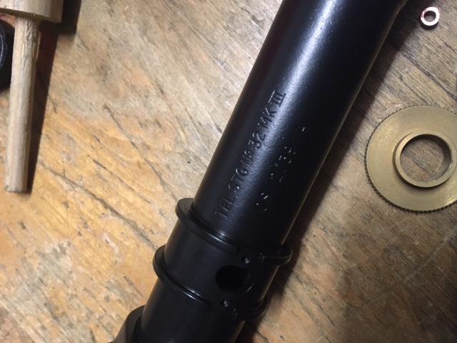

    I've been involved with No32 scopes since my teens although it's only in the last ten years or so that I have started working on them seriously. Peter has very kindly given me a basic 'how to' guide on various occasions, & I am also grateful to Warren & Valley Sniper for their help. Additionally, I have been fortunate enough to have a well known UKicon based forummer make me a small run of various internal parts that I was short of, having bought a batch of truly terrible scopes that came out of India (& which looked like they'd made the journey to Europe as deck cargo on a U Boat).
    There is, at least, one very good thing about having scopes in poor condition - it's difficult to make them much worse. I just started having a go, initially with those that were the least worst, & as I gained a little in confidence I moved to the more 'challenging' examples.
    I will never have Peter's experience & training, & this is why I do not offer a commercial repair service (plus I can do without the hassle), but I do enjoy doing my own scopes, & the odd one for a pal. One useful hint I have stuck to, is to fit complete matched lens sets, rather than trying to mix & match. I don't have an optical lab handy, but if you fit a complete No42/53 lens set to a No32, you know things should focus (with maybe just a tiny bit of shimming).
    Not sure how well the attached photo's will turn out, as they were taken hurriedly with my phone, but they show a few bits & pieces (literally) that I am working on currently.

    Out of curiosity Roger, what paint are you using on these??

    It's the real thing.......suncorite. There was a chap selling 1L tins on 'that internet auction site.uk' a year or two back. I was running low so bought a couple of tins. Not sure if he is still on there, but probably worth checking from time to time if anyone in the UKicon needs some.
