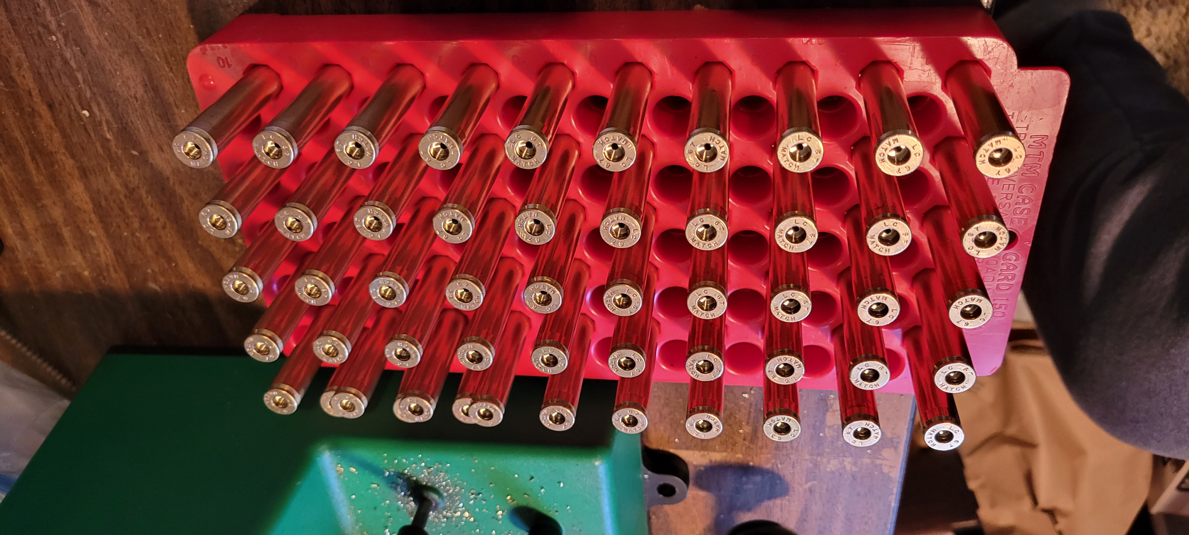

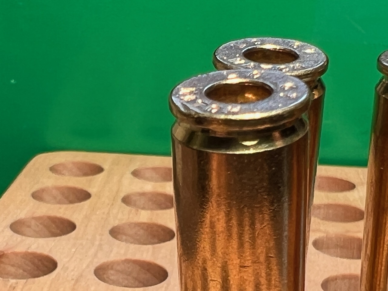

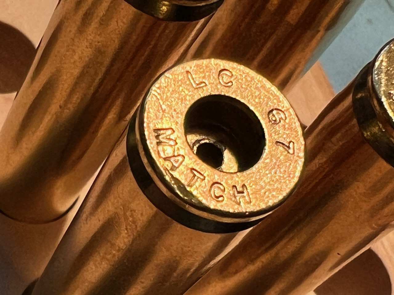

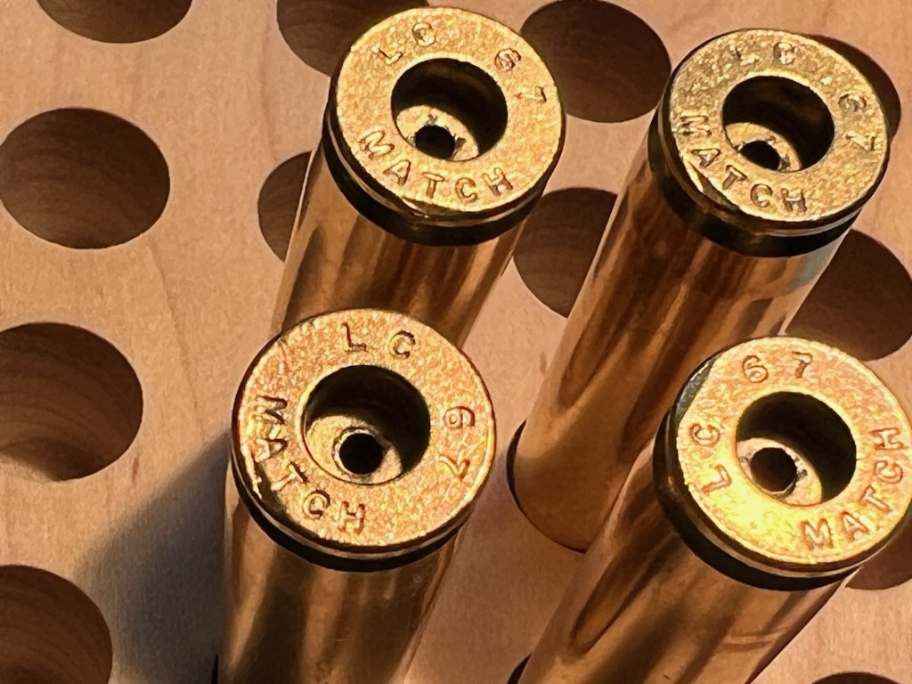

    I have a group of LC67 MATCH cases that all have a mark on the case head. I'm aware of extractor and ejector marks but not sure of this one. Any opinions are appreciated. I'm thinking it will work fine but not sure.

    Could the bolt group from a Garandicon do that when striping it from the mag.
    The dent wont matter to much, just ensure the bottom edge of the rim is not impinged into the extractor groove and the radius of the rim is not bulged outwards, a small flat diamond file smooth them out if any and it'll be fine.

    Exactly what CINDERS said. Make sure they're flat on the bottom so your bolt will close completely and there's no external bulge on the rim which can affect your extractor. Looks like an angry Garandicon got to them. That's excellent brass I have 500 rounds of it. Wears like iron, I have loaded it half a dozen times to M2 or M72 spec and it shows no signs of stress. Shoot it and enjoy.

    Agreed, looks like it's striking the op rod outside when departing. The mark under the rim is extractor. I don't think any will affect operation even as they are. I've run worse.

    My immediate reaction would be ejector mark. That, of course, would depend in the gun it was fired in. Such a mark indicates quite violent ejection.

    Thank you all for sharing your tips.
    When I test some loads this spring, I will watch each case for new marks.
    This is new .308 ammo and was fired by me from an M1a.
    I will examine the bolt for faults and chamber some clean dummy rounds from a full magazine. And check for possible case nicks from the op rod upon ejecting.

    Exact same marks as an M1icon rifle. Still no worries for you.
