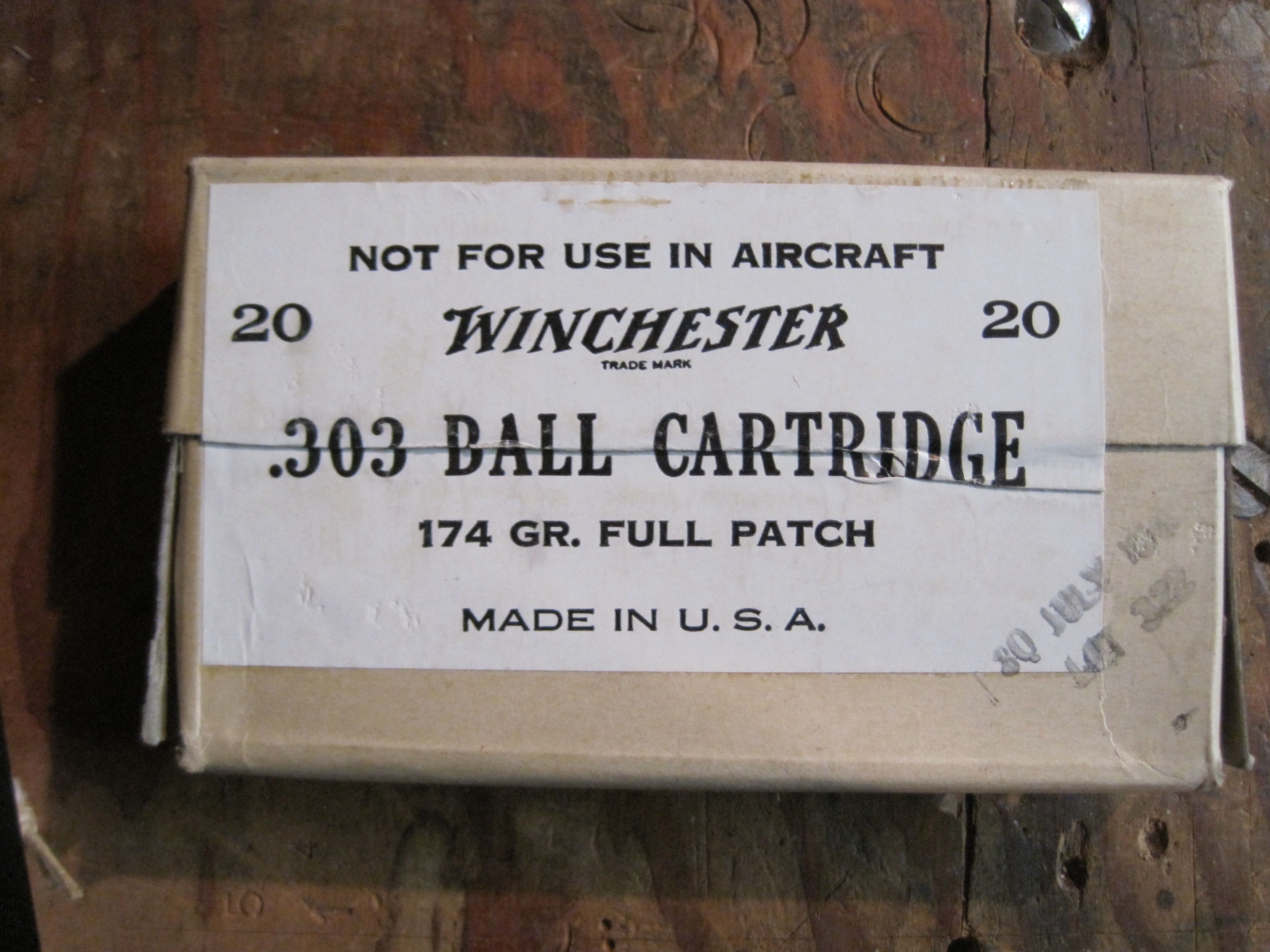

    I always wondered why these boxes were marked this way.

    Quote Originally Posted by rambo46 View Post
    The WRA ammo had more of a tendency to ctg case separations than Empire made .303". Difficult to clear a separated case from a wing mounted MG in mid air.
    ---------- Post added at 12:30 PM ---------- Previous post was at 12:27 PM ----------
    [QUOTE=browningautorifleicon;526572]So, are you wondering if that's why they chose the number "48" for the cardboard boxes? I know we've discussed it before here.
    26 boxes of 48 .303" ctgs gives a 100% fill in a standard ammo crate.
