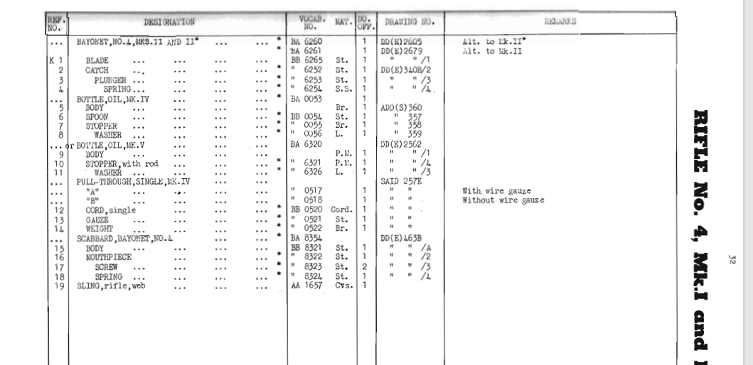

    It is called a Vocab (Vocabulary) Number and every individual part has both a Vocab No and a Drawing No.
    Basically its the system that the NATO "NSN" system is based on.
    For example any common parts across (say) the No1 Mk3 and the No4 Mk1 would have the same 'Vocab No"

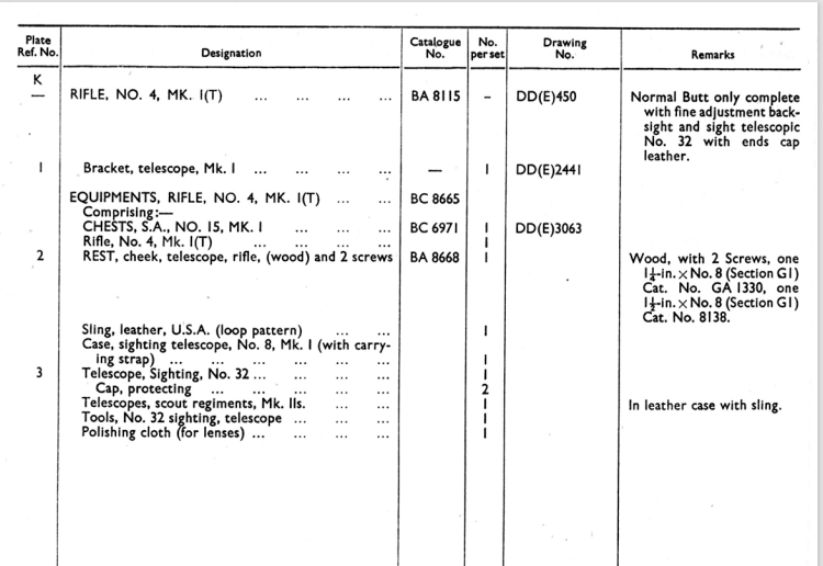

    I don't find BA8665 anywhere in the paperwork I have, however BC8665 exists and is :
    The "complete No4T Rifle and chest"
    (The chest only is BC6791)
    Sorry - not much help.

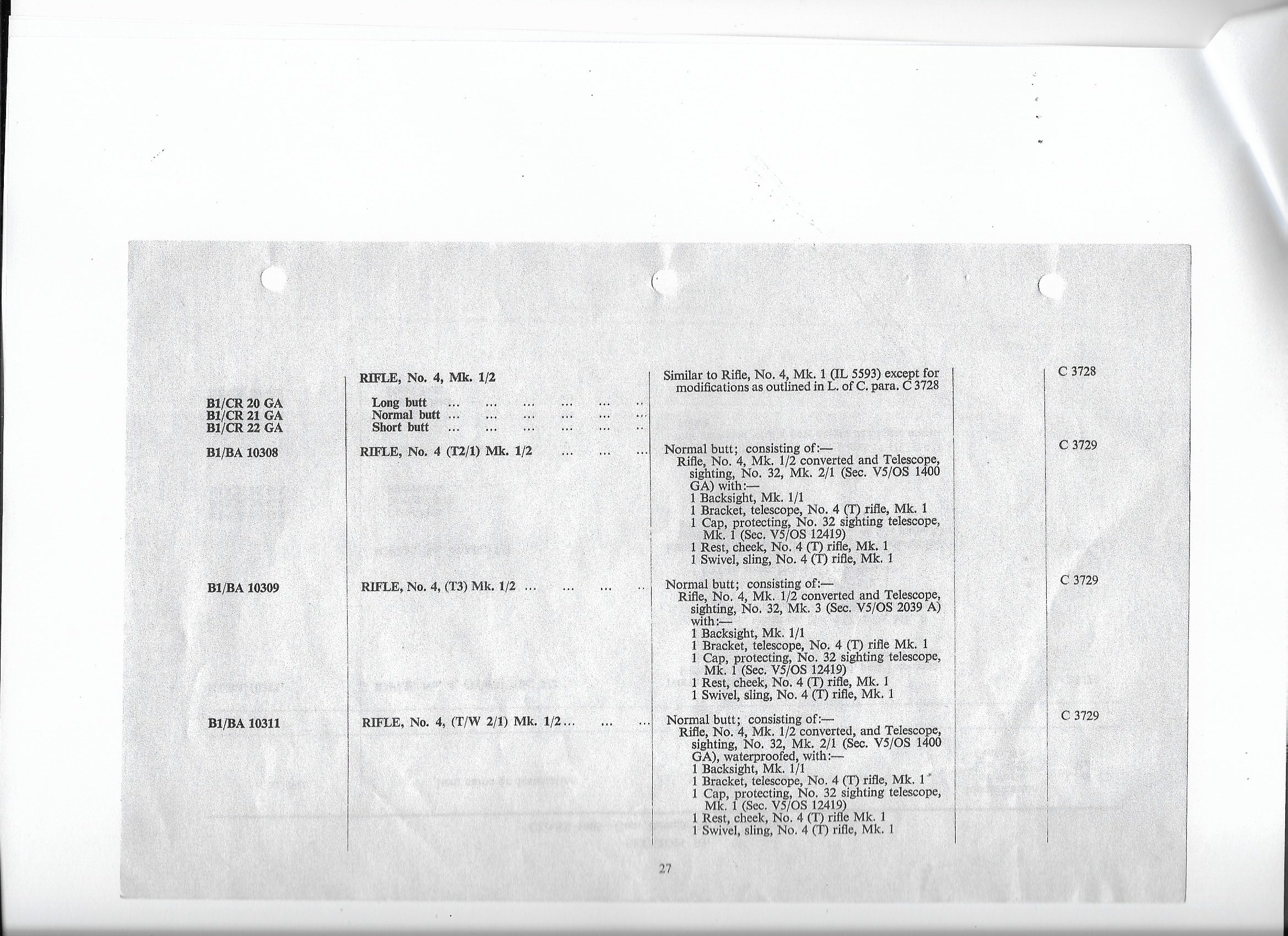

    Still looking - The No4T Mk1/2 variants had different "BA" numbers to the No4T Mk1, and each had different BA numbers depending on the scope MK and whether it was waterpoofed or not.
    Source : 1959 edition "VAOS - Small Arms & Their Components"
    Note : The different sized butts had changed to the new CR part numbers but the 'complete rifle assembly' had retained the "BA" numbers.
