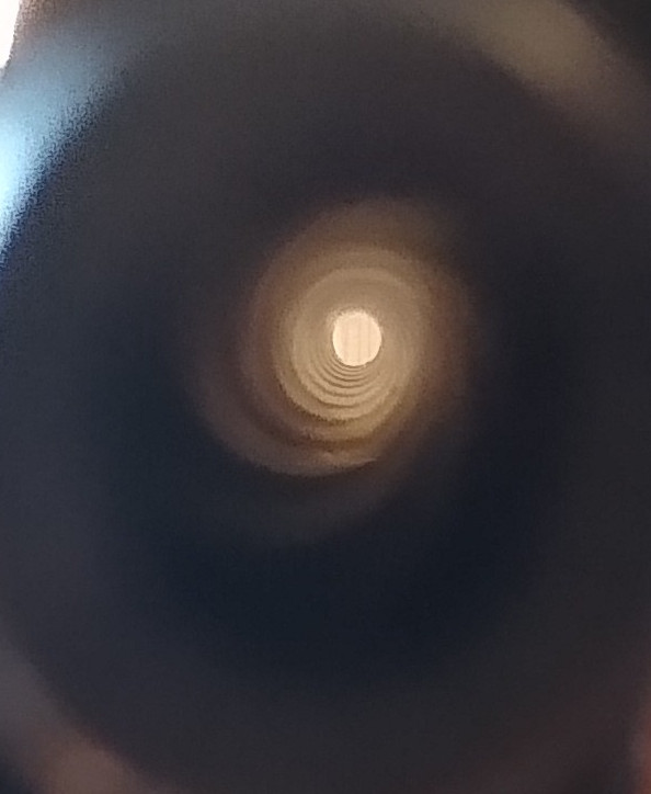

    After reading all the very helpful comments i decided to try some quick 'n' dirty tests on my Enfield. I'm no expert & my tests may actually mean sod all?
    The pics are not great quality but hopefully good enough for you to get the picture?
    Anyway I tried taking photos with my phone of the bore condition. The bullet is a .308 & I put a pencil mark where it could go no further & it mic'd to around .306/.307...as it was not on the parallel part of the bullet...this was the best I could get..
    cheers again
    John
  14. #9
    Legacy Member john60wales's Avatar
    Dec 2020
    Today @ 06:12 AM
    Nr Swansea, South Wales
    48
    04-25-2025
    08:34 PM
    This is the best pic I could get of the state of the rifling at the end of the barrel..
  15. #10
    Today @ 02:20 PM
    30,996
    04-25-2025
    12:34 PM
    Quote Originally Posted by john60wales View Post
    So, the bore is dark?
