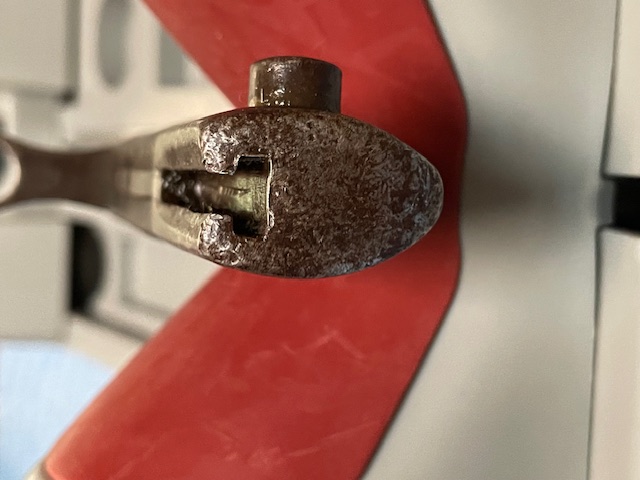

    I have a "Bring Back" Carcano Rifle all matching numbers etc. I purchased a bayonet but it does mount on the rifle bayonet stud. I will send a series of bayonet and rifle pictures. Question is do I have the proper bayonet?

    You have a bayonet for the M91 rifle, you have an M38 rifle so no, you do not have the right bayonet. M38 bayonets are rather expensive, in the $200-$300 range unless you get one of the modified types that no longer folds, they are around $100.
    For future reference, side views of the bayonet and the rifle would be very helpful in getting faster responses.
