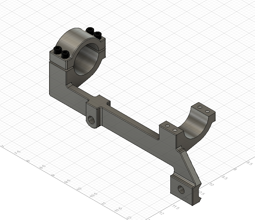

    Hello,
    Wanted to poll this forum to see if there is some interest in the reproduction L42 mount to fit S&B (Or other non No32) scopes. I was going to manufacture a small run of these - will be manufactured out of steel with 1in ring diameter (would also love to hear if other ring diameters would be desired)
    Will come with cap screws in 1/4 BSF to a more precise side torque spec.

    I have a bunch of images and have reverse engineered both a real No32 mount (for mounting points and tolerances) as well as the engineering drawings which can be found on this site. The isometric model in the first post is after all the design elements were done and actual mount made.
    I was generally interested in opinion of how many people would want one (i.e. how large of a first run to make)
    The price point will be around US$400 direct or US$450 on something like eBay

    ReconScout if you're having them made in the PRC I'd suggest selling them for a much more modest price more in keeping with the actual cost. Price has a lot to do with demand.
    When I did the IWS brackets I had them made here in Canadaicon, and while they did a very nice job and I'm sure for a good price by local standards, but by the time the unavoidable hand finishing, blasting, phosphating and painting was done, there wasn't much profit in the venture.
    Overall though, I doubt there is that much demand for another reproduction of the same bracket. I'd suggest you come up with something a bit different: perhaps a 30mm ID on the rings? That would meet a real potential need in the market.
    The real question is will they collimate to the original pads on original rifles?! Not just zero, but actually collimate.
    And BTW, your ring caps look too thick in the model you posted an image of.
    If you want to take a stab at the original No.32 brackets, I'd suggest you use the very early rounded or Rose Bros.(?) casting pattern, rather than the rougher, squarish N.92 pattern.

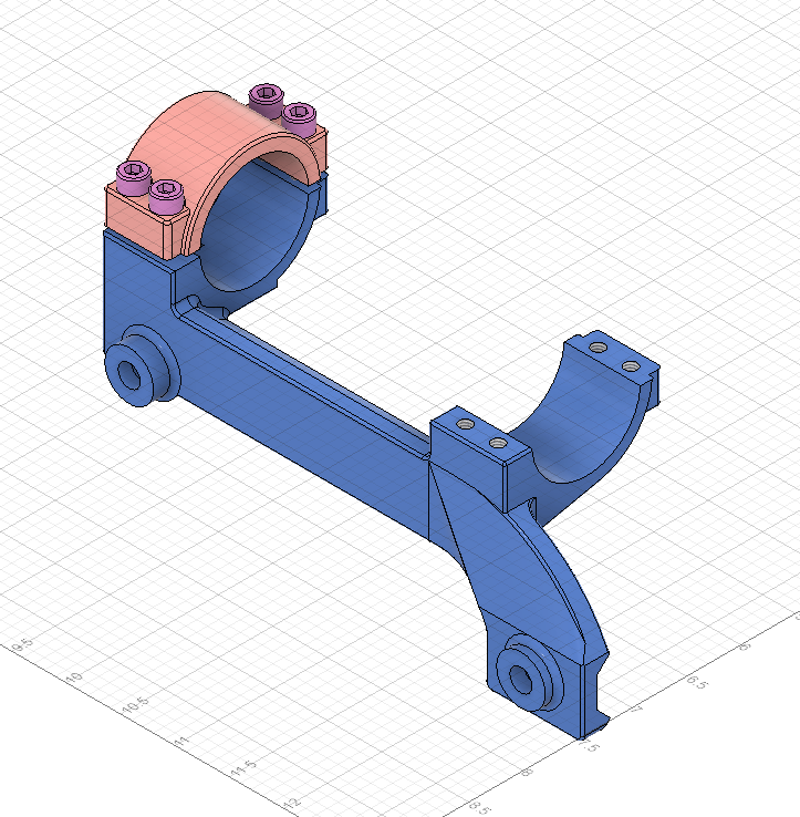

    Good pickup on the thickness of the rings , they are indeed thicker (here is the original no32 mount, modelled from the blueprints, with correct ring thickness - ignore the cap head screws, I just didn't want to replicate the 4BA cone screws).
    Once examined in the CAD (after modelling the blueprints), the original ring thickness leaves only 0.6mm between the screw and the inside of the ring, on the L42 mount I went with slightly thicker rings.
    If I were to go with 30mm ring size this would be the approximate thickness of the rings.
    On the collimation point, I think its hard to know the answer to your question as more pieces in play beyond the mount, specifically pads and their attachment to the host rifle and machining/shimming of them.
    On the price point for the mount, you are absolutely correct, however one more ingredient is in play - quantity, on the small run batch (eg 50 units or less) every manufacturer (including China) does not want to lower the cost too much, hence as you have discovered it is really more of a hobby than a true business venture.... But I think anything which relates to this forum is, and for all of us on here is passion.
