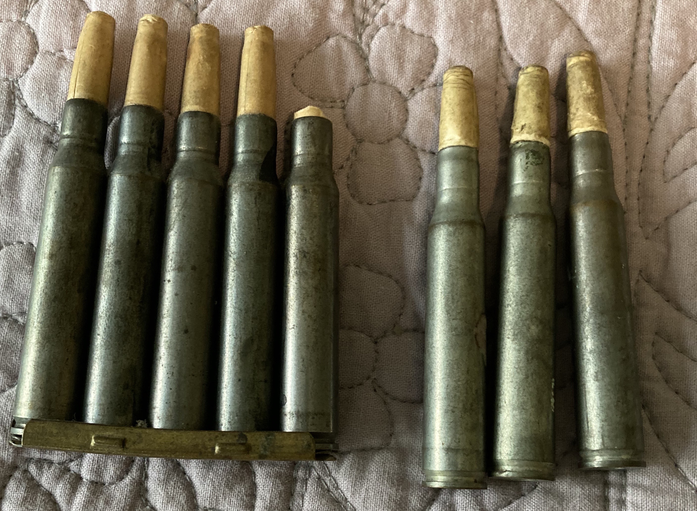

    My brother knows I have some US milsurp rifles, and he also likes flea markets and gun shows. He bought for me a few rounds of vintage cartridges with paper bullets. I vaguely recall reading how these types of rounds were made for training in indoor ranges back in the day but dont know much more than that.

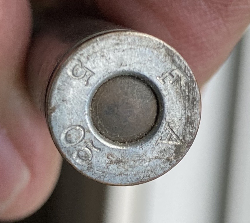

    Both he and I figured they were .30-06 rounds (on a clip for a M1903), but after considering the apparent date on the headstamp (FA 5 05) maybe not? Thoughts anyone on what I have?
    And thoughts on how to get them into the hands of someone who might be interested in this sort of history?

    Those are 30-03 gallery rounds made by Franklin Arsenal May 1905.

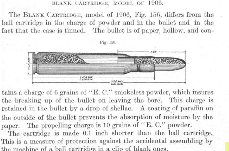

    The cartridges in the pix appear to me an earlier model of the M1906 blank shown below. They are not gallery practice rounds. The powder-filled paper bullet is designed to disintegrate on muzzle-exit. I suspect they would be exciting among cartridge collectors due to short production life.

    For awareness one of our fellow milsurps members reached out and the 8 rounds are now in his hands for a nominal price…..to go with his M1903 that is still apparently chambered in the original .30-03
